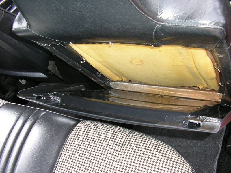

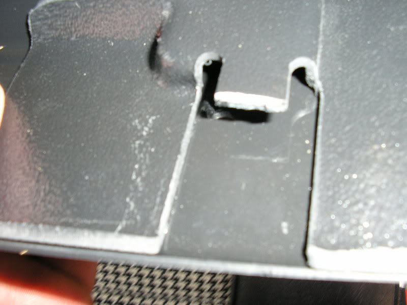

Posted 07 January 2007 - 05:28 PM
Les
Sorry to be negative, but I finally got around to fitting those reproduction LX seat backs and after just two drives with them fitted, this was the result.
https://cache.gmh-to...ry/P1010063.jpg
https://cache.gmh-to...ry/P1010064.jpg
The fit was great and the finish was very acceptable however, after just two drives with them fitted to have them totally useless is a concern. The tabs are not durable at all. I am not a particularly heavy person (85kg) and I am very careful with the way I treat my car. Both passenger and driver ones have broken. Thought that I would mention it to you. Have you had any other reports of the same problem?
Gerry
Edited by Redslur, 07 January 2007 - 05:29 PM.

the top tangs are plastic?? No wonder they broke. The Holden ones were metal, but they used to break away and the Holden fix was to drill holes and fit screws until early 77 when they were revised and made from stronger material. If it was me I would be making them from the same setup as Holden, but making the metal slightly softer so they will bend rather than break the seat back. I made a few about 6 years ago in that fashion and they worked perfectly. Put too much weight on them and the metal tab bent rather than break.

Thanks guys, some good ideas there. I have already worked out how I would fix them, I guess the point remains that to spend over $100 each and have them break after having driven the car twice is a bit of a concern. I have since learned that it has happened to someone else too...

the way i solved the problem of them wanting to keep popping of the back was to insert a piece of ply,(i think i used 8mm) in between the foam and the plastic,,,,,,,,,,,,,,,worked a treat.......Cheers

Sorry for the late reply but I have been off the air for a while. Even the original ones where a poor design I thought we had come up with a better option but I might be wrong. I will replace them if you like PM for details. We have had no other complaints that I am aware off but that does not mean we will not take action on this.
We have very few left and if we cannot solve this problem we will not make another batch as I said it was a very poor design and if GM could not solve it we probably can’t. The ply idea has some merit and maybe we can suggest that when we sell the part. BTW we did try the metal brackets with little to no success
