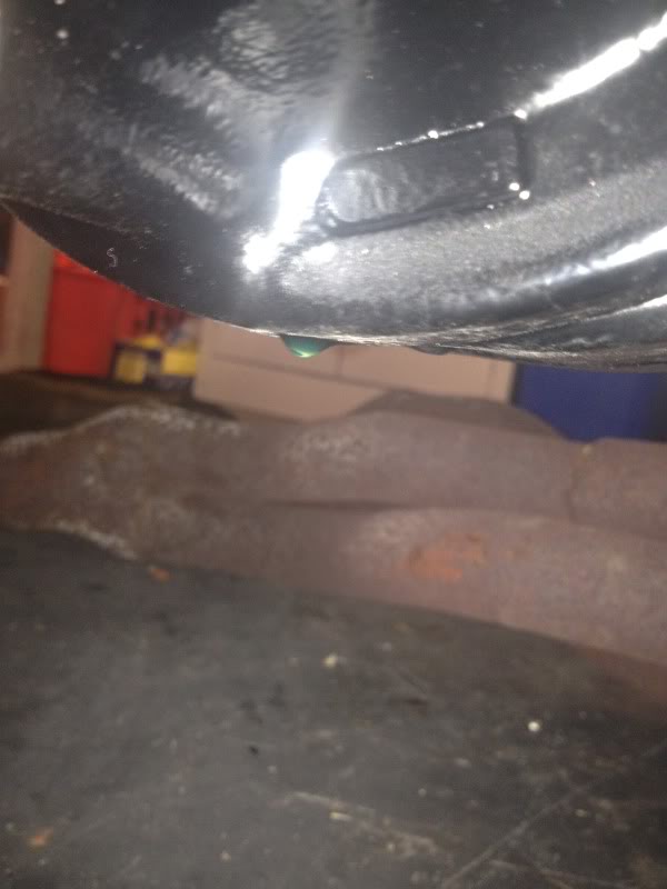

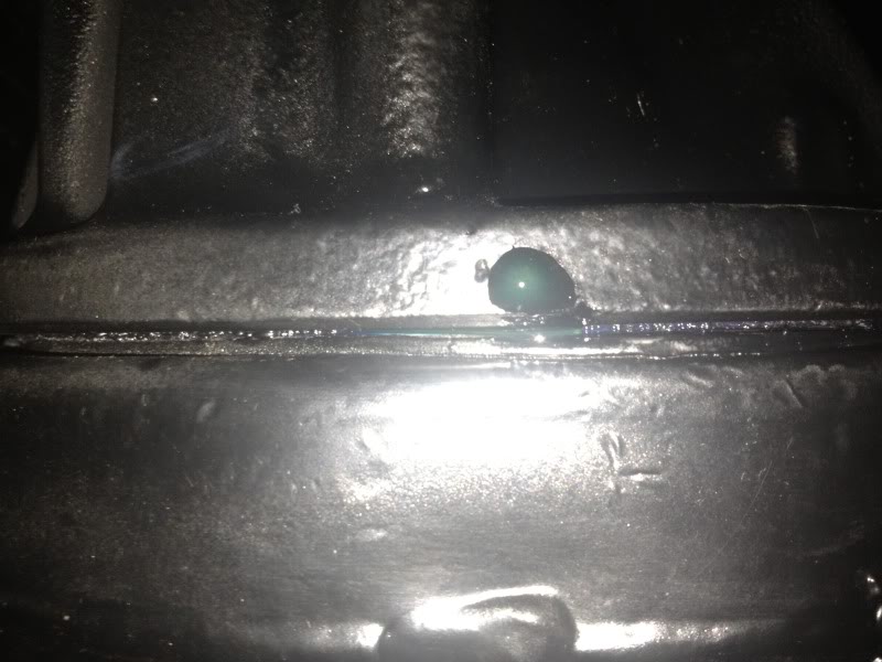

I had my diff/housing overhauled like 6-8mths ago. Had the LSD centre rebuilt n new carrier bearings/wheel bearings and so forth replaced, was a $837 job. A few months back I filled the diff up with oil once it was fitted to the car.
Crawling under the car te other night, turns out its leaking from between the housing assy and the actual case which holds the centre. I can see it weeping through the gap I guess where the gasket is.
I had notified the company who rebuilt it that it's leaking but they were unable to assist over the phone. I'd say by the time the car is drivable, it would be like 12mths since it had been rebuilt.
Should I expect them to warranty there work? Considering the diff has not turned an axle?
Is this a common fault of a banjo diff?

Wouldn't say leaking from that area is a common banjo fault.. from the axle seals maybe but not from the centre.
I would first try and eliminate the gasket as a cause for the leak, as then you have a leg to stand on in regards to the warranty - if it's not a gasket then i can only presume it would be the two surfaces not sitting flush up against eachother (housing could have been dropped etc.) Are all the bolts tensioned up?
I would try draining the diff and fitting a new gasket with loctite gasket maker/dresser first, if that fails then give them a hard time!

I'm with TB don't touch it, ring/email them let them know your concern and ask their opinion, wether you can replace the gasket or send it back for them to check it out (at their expense would be nice).
Take some pics of the problem area to back up your concern as well and will also give them an idea about the leak.

If you fitted the banjo into the housing then there would be no warranty claim against the company that rebuilt the diff.
Leaks from the gasket are probably more common than some would expect.
Mine leaked after I put the diff back into the housing so I pulled the diff back out and installed 2 gaskets - Problem solved.
#7 76lxhatch
Posted 21 March 2012 - 09:51 PM
Yep leaking between the centre and housing is very common, old housings have seen better days and the design allows a lot of bending and flexing of the housing. It can take some time for small leaks to become apparent so kind of hard to diagnose on assembly, most people wouldn't worry about it in a driver but obviously you will want it nice and tidy. Thicker gasket(s) as mentioned is one solution, maybe with a bit of sealant, make sure the gasket material doesn't track the oil too.

As step one I would further tighten all the bolts securing the centre.

I'd get an email address and email them those pics, failing that give them a visit or bring the car in.

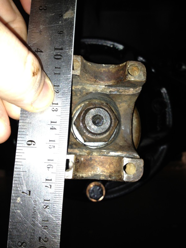

However I just went to fit my tailshaft and it turns out the diff shop have fitted the incorrect yoke. I guess its a 6cy yoke.
I supplied them with a fine spline LSD centre to replace the coarse spline open centre that was fitted to the diff when I took it in for it to be completely overhauled.
This is the yoke I got back with all the left over parts. Which I subsequently sold to help out a fellow forum member as I was under the impression it was un-needed.
This is the yoke currently fitted:
Now...... How hard is it to swap yokes if I can get a V8 one? Can it be done with everything in place?
Should I expect the Diff shop to carry this work out for free?
Should I remove the entire rear axle assy from the car and take it in to them so they can assess the leak at the same time and swap the yokes?
Or should I remove the centre and only take that in to them and then I deal with the leak come time to re-fit...
I am extremely frustrated and angry with this. It is a real stuff around and I honestly feel I SHOULD NOT HAVE TO PAY FOR THIS TO BE FIXED.
The problem is sourcing a V8 yolk, they're hard to find. As rare as they are I sold one a few years back on ebay for about $50.
This should answer your questions.
As you can see it's an easy job & cheaper for you to bring in your centre ... and get a gasket for your diff while you're there.

So in the end, the diff centre has to be removed from the housing to carry this swap out? Or can it be swapped with the centre in?
#25 UCgazman
UCgazman
    UC's FTW!
  • 1,343 posts
  • Name:Garth
  • Car:UC S̶u̶n̶b̶i̶r̶d̶ 5000!
  • Joined: 04-August 11
Posted 11 September 2012 - 01:32 PM
You can swap the yoke with the centre in place, but if its leaking your gonna have to take it out to replace the gasket anyway.
