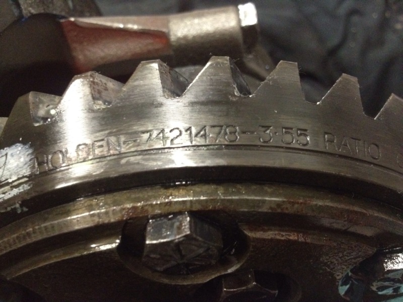

Interesting that you have 3.55 gears in a 3.08 carrier and a 3.08 banjo diff housing.

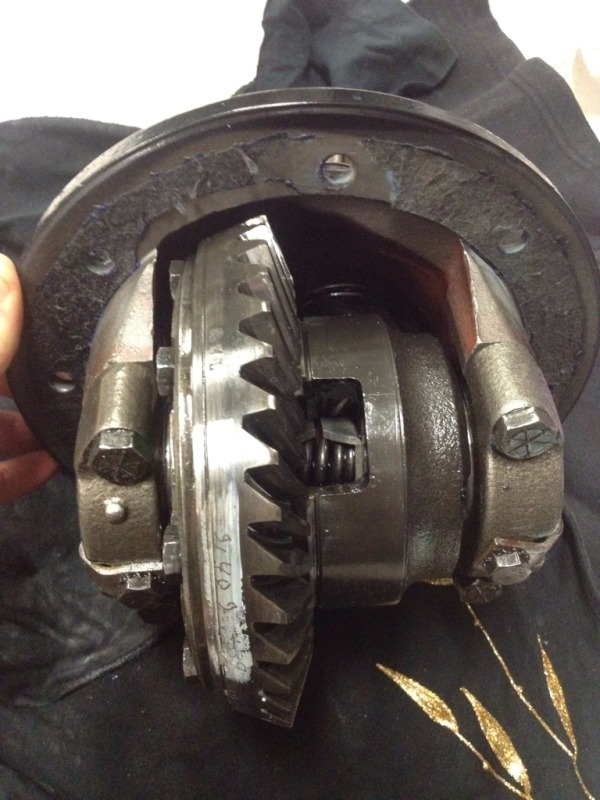

The housing originally had a 3.08 open centre in it. I took the entire assy out of the car and gave it to the mechanic. He said SLR 5000 should have fine spline LSD.

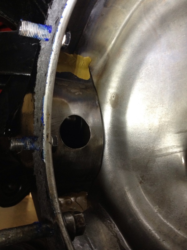

So I hunted around for a centre and came up with this one fine spline LSD 3.55. He did say he had to change bolts or studs or something to make it fit. So I expected for him to fit the centre in and away I go, but he has fitted the 6cyl yoke that came with that centre and used all the other parts that were supplied with my original rear axle assy.
How did you determine it was a 3.08 housing and carrier? What are the identifiers? And I was led to believe the baffles are a standard thing on SLR but I had no idea what they looked like????? Wasn't sure if all banjos had those plates there??

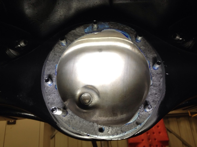

3.08 diff housing uses two long bolts at the bottom, one for the drain at the very bottom and the other one is at the 7 o'clock position. All the others are short studs. I see yours has had a long bolt inserted to form a long stud. To do this someone has drilled out the thread in the bolt hole and pressed that bolt in, unless this is how the LH housings came ex factory.
A 3.08/2.78 banjo carrier has the large casting bosses at the bottom, hence the need for the two long bolts.
If you have the 3.55/3.36 carrier compare it to the 3.08 carrier and you'll see the difference. The 3.55/3.36 uses all short studs and a short drain bolt.
I'm just wondering if that long bolt inserted to form a stud is secured firmly enough in the housing to allow the nut to be torqued up correctly.
Just a thought that if the bolt is spinning before the nut is tensioned up to spec then this may account for your diff oil weep.
I assume only the SL/R 5000 diff housings got the baffles.
