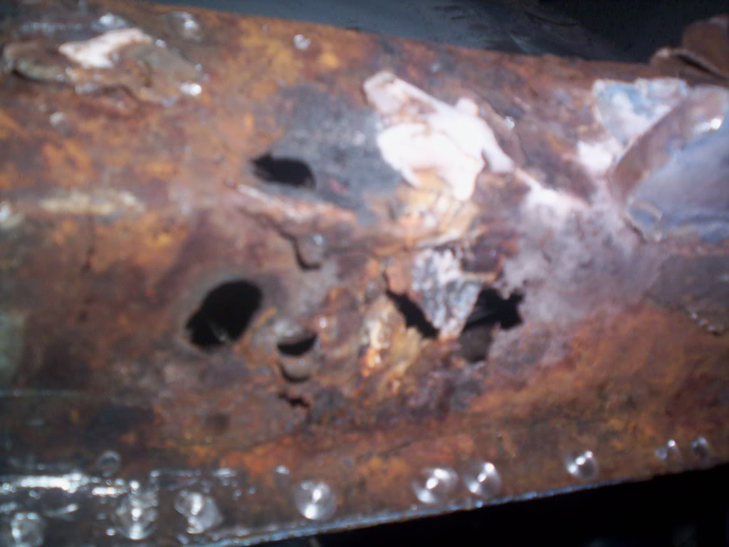

Back to the car...

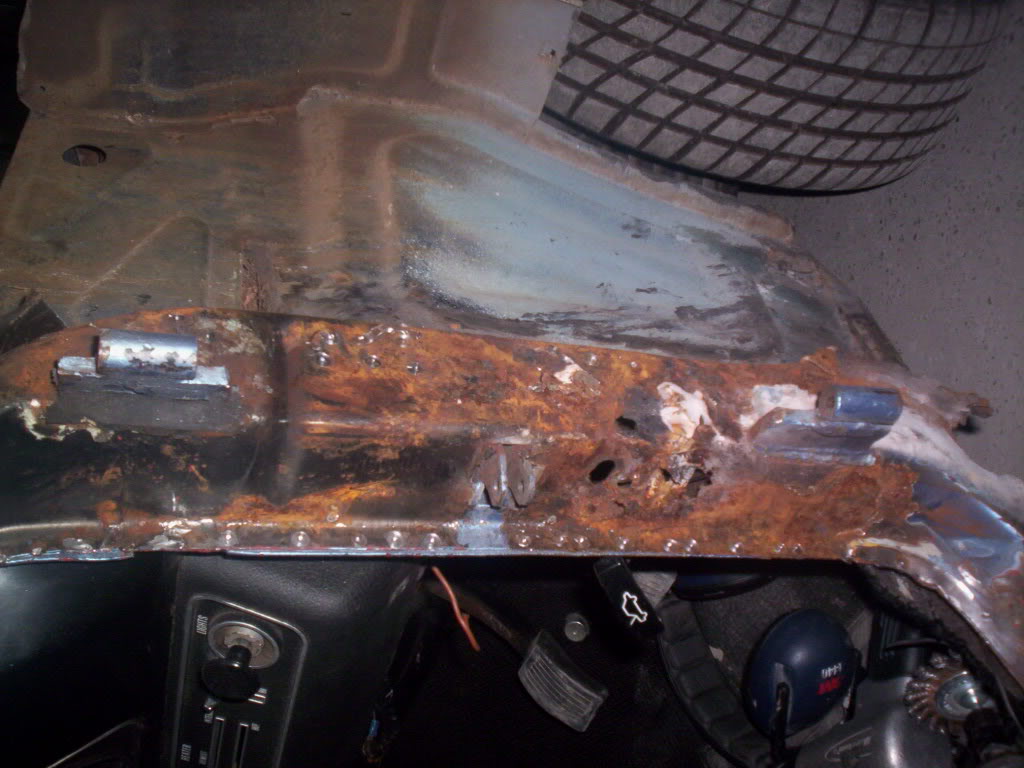

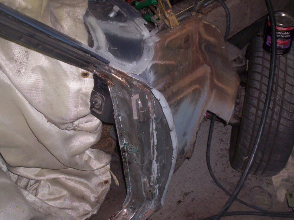

I had a look at the front A pillar.
After sandblasting....I discovered that it was repaired before...They didn’t do too good a job.. Actually they made it worse. The dodgy guys are back!
I knew when looking that the front body pillar that it will be a mess under it...and I was right...
Will have to think how to fix this as I’m not too sure about removing the whole piece as I’m worried that I won’t get the hinges in the right spot..Ide like to..The A pillars off the donor car are perfect..Shame to cut up really.
ANY ideas????
I was thinking of just taking off the first layer; fix/patch the reinforcing pillar. Then put a pillar outer piece off the donor car back on...That way I won’t move the hinges?
dodgy repairs
The result of the repairs
#79 S pack
Posted 15 June 2012 - 08:36 AM
Ill have a go at using them..If not, Ill get the complete seal with ends on them...
Hi Mike
Great job, keep up the good work.
It would be more expensive but a much better job to use the complete repro sills.
Personally I'd use the complete A pillars from the donor car if they are in good nick, just measure twice or three times and cut once.
You could even go to the trouble to make up jigs that lock into the door openings and attach to the hinges just to make sure the replacement A pillars hinges will be in the exact location.
Just a thought.
Dave.
#80 _Agent 34_
_Agent 34_
Posted 15 June 2012 - 04:18 PM
Mike,
give me a call as i just replaced both sides on my car and can help with some advice on how i did it and this maybe able to help you make a decision on how to attack you car.
you really need to at least to pull off the out skin of the pillar and then treat that rust and then fix the new outer skin.
OR it may be better to just replace back to the factory join as i did and it just slips in the same spot and then re butt weld up the drilled out spot welds. I was very surprised how well it lined back up with the door.
0401816661 call over the week end.
text me and i'll send some photos as well.
grant
#81 _mikecatts_
_mikecatts_
Posted 15 June 2012 - 08:25 PM

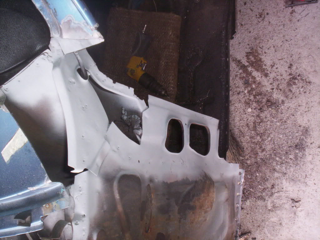

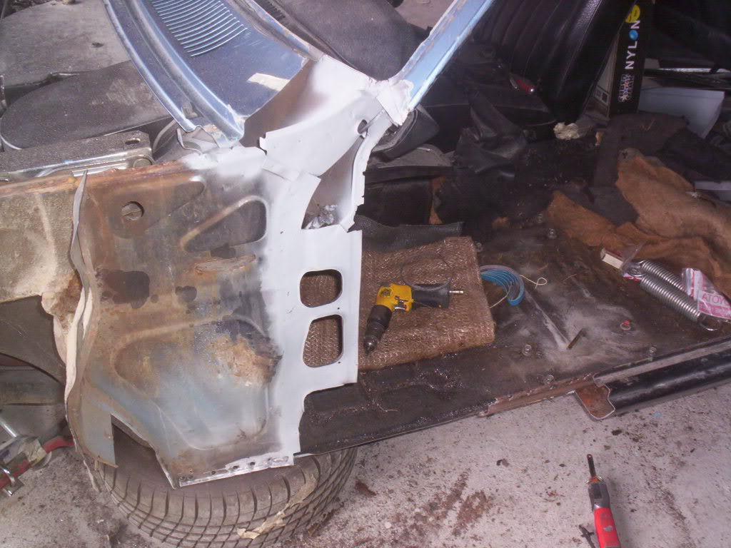

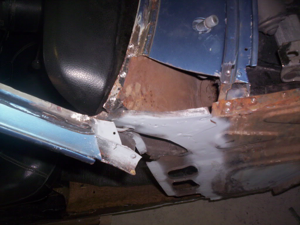

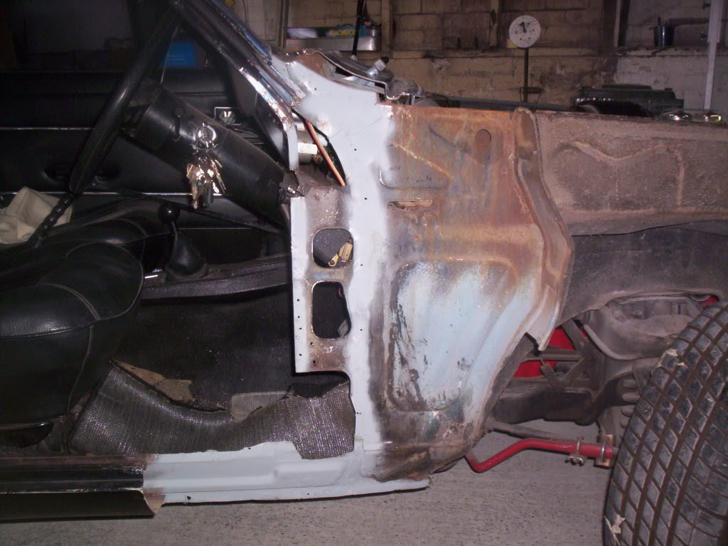

Hi all....Thanks for the advice.
I’m not working on the car this weekend, I’m busy else ware...I’ll call next week if I get stuck Grant, and thanks for the offer, you’re a champ and one day I’ll buy you dinner for the help/advice
I’m going to get the proper seal panels that have the ends on...Same old story, I tried to save a buck, but it just ends up costing more. That’s car resto I suppose. Live and learn.
After staring/ scratching my head ALL day over this, I’ve decided to replace the WHOLE A pillar. The inner panel is stuffed, totally, can’t be fixed... I spoke to Gavin at Retro Rods...he explained the best way to go about it. First I will make some bracing to keep everything as it is... Then Ill mount my door, with the guard on, get it right then tack in place double, triple check...Then weld in. The way Im going to do it to the orginal factory spots/joins as Grant suggested..no cut and shut.. Im going to do this right....So my next job is to fix a small hole in the RH guard and clamp on to aline the door properly...When the guard is in place, I will then fix the window cowl...so it all matches..Might be the go I recon...
What I think is strange is that I tried the donor LJ car door on my car...And it comes up too short to engage the lock, by about 7mm...Why is this? Is the LJ longer in the door opening??? Or being a Brisbane built car, are the dies/jigs different as to Adelaide build???
I measured both cars hinge placing and they are roughly the same.
I was hoping to use the donor door as its in better nick than the original...
I put the donor A pillar on my door and its fine in alignment...Then back on LJ door and it’s the same...but when I put LJ door on LC...it’s too short...
I can’t put LC door on LJ as I took off the A pillar...Maybe I should of!!!!!!
Ill place in my rust bath for a week just to make sure, then seal before it goes on.
Cut RH A pillar..in exellant condition..no rust at all..Im mad not to use.
The donor piece lines up with the door ok..Hope it fits as well.
poor donor car.. Getting lighter every week..wont be much left by the time Ive finnished I reacon

#88 _Agent 34_
_Agent 34_
Posted 17 June 2012 - 08:46 AM
Mike,
Rule No 1 don't weld untill it's all lined up.
OK here are my tips for you mike on this as you really need some detailed help here.
1) the cars are really flexible once you take out this part of the car ( window pillar) so don't do any repairs to the car unless it's sitting on the car stands so this means dropping it down off the rotisseri
2) once on the car stands make sure that they are all level and the car is sitting square- also the pillar does drop slightly and the dash does flex as you have taken out the support
3) select the best point to join - in your case this will now be up the pillar and not as per brocks 72 car, which is lower
4) prepare the donor panel and if you join on the factory spot welds ( this is the lower section only )it sould just slip in ( actually you will have to spend heaps of time with this )
5) once close to fitting start to trim the top pillar and stagger the cut - leave the top longer and join up the outside of the window pillar like a flap and weld where required - but weld not now -
6) fit and screw in place and then fit door to check gaps - this will also take a while and you then need to massage the A pillar around until you get the correct gap or the best is going to be
7) check and re check the fit then screw off properly ready for welding
8) you really need to also set the front guards on as well or dummy position it as you also have a front GAP between the guard and the door and you need to make sure that the rear gap and the front gap are the same or close
9) once butt welded ( through the spot welds ) you can still adjust the door with up and down movement - physical lifting
10 ) have a beer and then swear that you will never do this job again
11) remember to put a feeder wire up the window pillar for the interior light and it cannot be anything else as it will melt when you weld up the pillar and you will need this to drag through the new wire for the light
good luck and may the A pillar replacement force be with you

#89 _mikecatts_
_mikecatts_
Posted 18 June 2012 - 09:24 AM
Guys..you are legends...Thanks for the pics and desription...I will make some bracing to keep from moving first, then ill do as you guys say..I will keep a level head and look 3-4 times before ANY welding is done.
After reading, I am more confident...Ill keep you all posted..

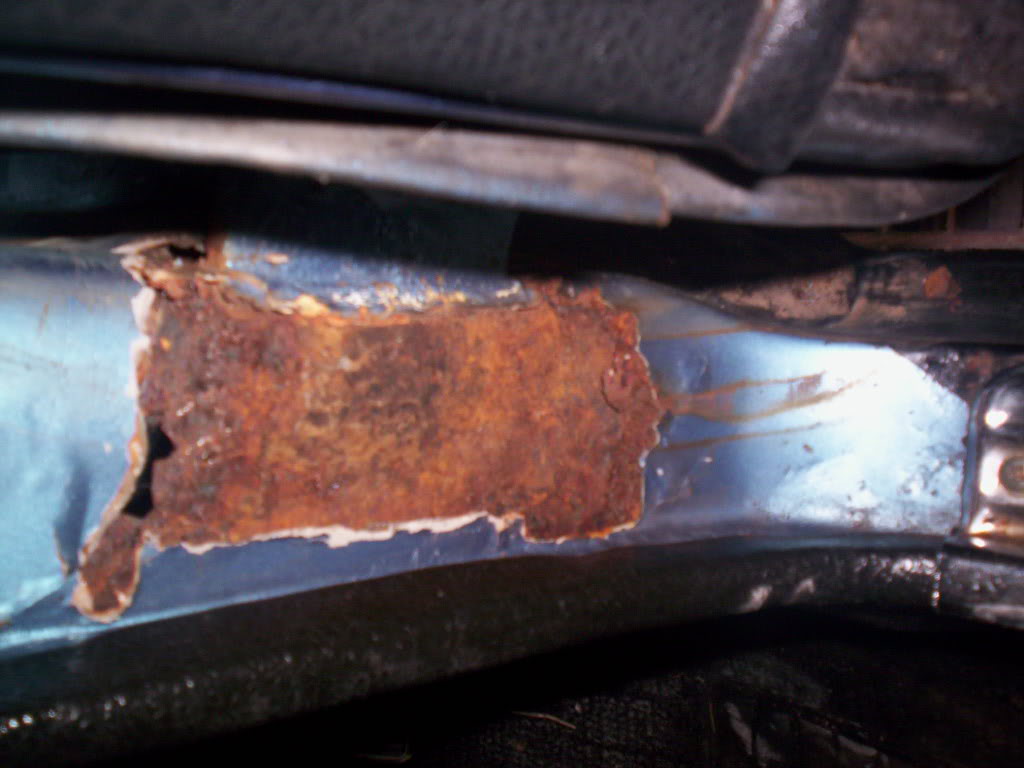

#96 _mikecatts_
_mikecatts_
Posted 26 June 2012 - 07:55 PM

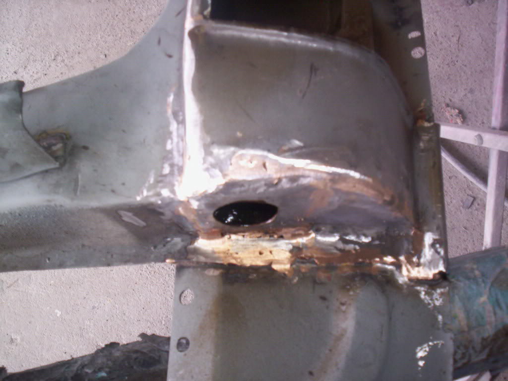

Hi all.
I didnt get a chance to do the A pillar over the weekend. Maybee this one
So I started fixing the RH door...I was going to use the original door, The LJ door is better, so thats the one to use..
As expected. A little rust hole reveals a major rust repair...
I had to custom make a new section as the outer piece is a mess, not worth fixing.
Wasn’t too hard to make, Just flattened out and traced, drilled the holes for rubbers, door trim and the latch. Held in place on door to get the right bend, the celco clips and a couple of pop rivets help heaps, bent, cut, fitted and welded. Done..
I want to fix the outer sections before I weld this in...I have access to the inner door with this off so I can rust proof after fixing the outer rust holes a lot easier...
Used pieces from the LJ guard to fix the sections...Looks good...
Now the top of the door...I wire wheeled and this is what I have to fix...Ill make a new piece...
I’ll continue tomm...
Mike.
Edited by mikecatts, 26 June 2012 - 07:59 PM.
