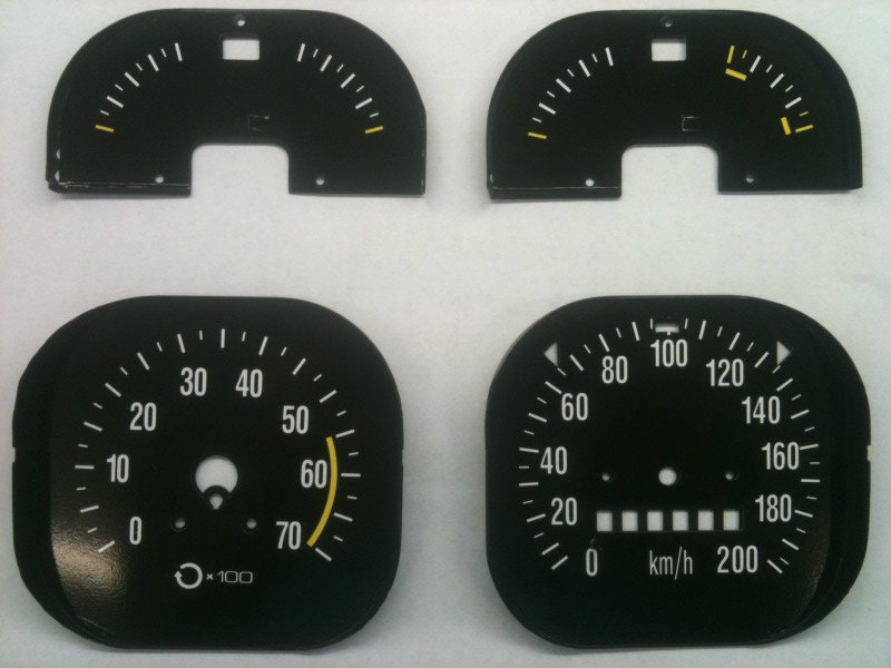

Has anyone fitted the rare spares yellow instrument decals? Have searched the forums, but can't find anything on this. I have LH SLR instruments (white) in my LX SS and want to put back to original (yellow). Is mainly just the speedo decal that looks tricky, do you need to pull the speedo needle off it's spindle? Also, have read here that painting the needles is okay, but what is the original colour of the needles, have seen some yellow and some orange. Thanks.
#2 hanra
Posted 10 June 2012 - 03:47 PM
Yep, gotta pull the needle off the speedo. I put the white LH ones on mine. I was able to re-calibrate the speedo at work when I re fitted the needle. I would be cautious about painting the needles as the extra weight may effect accuracy.

Yeah, have heard that about the paint affecting the accuracy, will look silly with white needles and yellow numbers?? Maybe just a light dusting of paint?

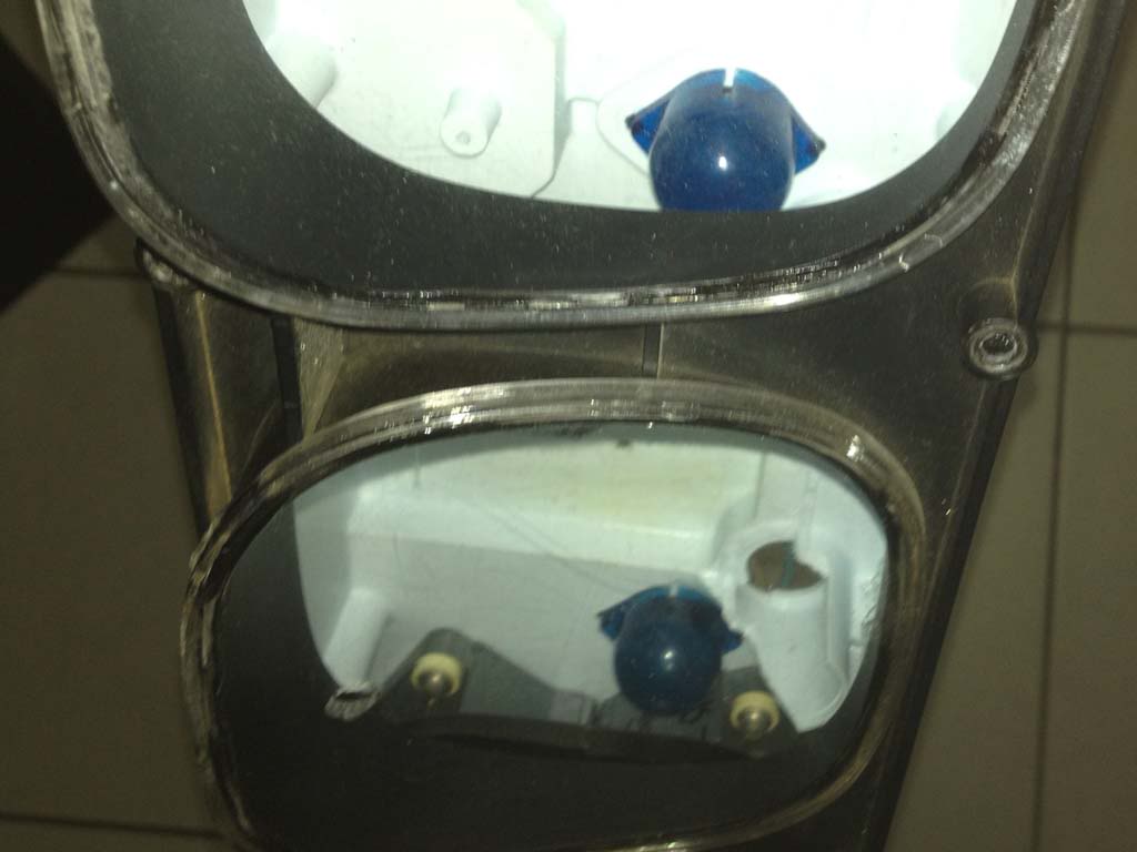

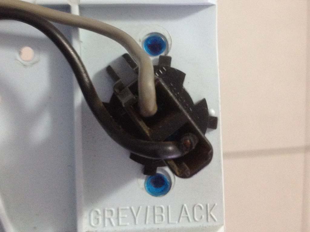

The LH SL/R dash I have has blue lenses fitted inside for the four dash lights. The speedo is the white needle 0-200 km/h only with a single slot for the odometer.
#21 hanra
Posted 12 June 2012 - 01:47 PM
Ah yes.. Been some months since I had my cluster in bits. Thanks for that one!
#22 ls2lxhatch
Posted 12 June 2012 - 02:21 PM
I think the green look may come from the old clear globes giving off a yellowish light through the blue lense.
The SL clusters I have pulled apart do not have the blue lenses.

Posted 12 June 2012 - 03:12 PM
Aahh yes the blue bulb holders, I stand corrected, interesting with regards to the SL not having them
The instrument lighting has always been abit on the dullish side, as suggested an LED style bulb sounds interesting
It would be nice to brighten it up a little without taking away the factory appearence
