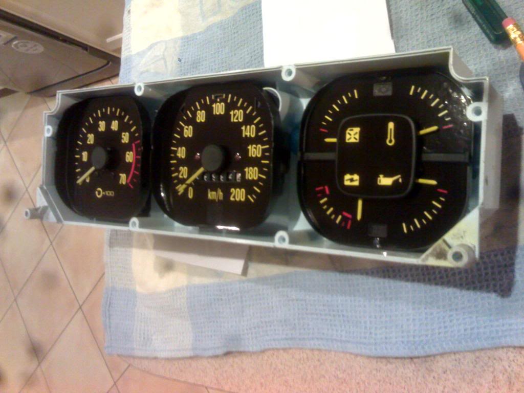

Well, no, thats my pic and my speedo now looks like this:
#30 _barbados1212_
_barbados1212_
Posted 20 June 2012 - 03:19 PM
Yeah, well all done, looks good. Took some pics, but not sure how to upload them to this thread. I ended up just giving the needles a light flick of paint, should be okay hopefully... Thanks guys.

Just adding couple of pics for you's, notice the very light flick of paint on tacho needle. Can hardly notice it when it is in place, and it works fine.

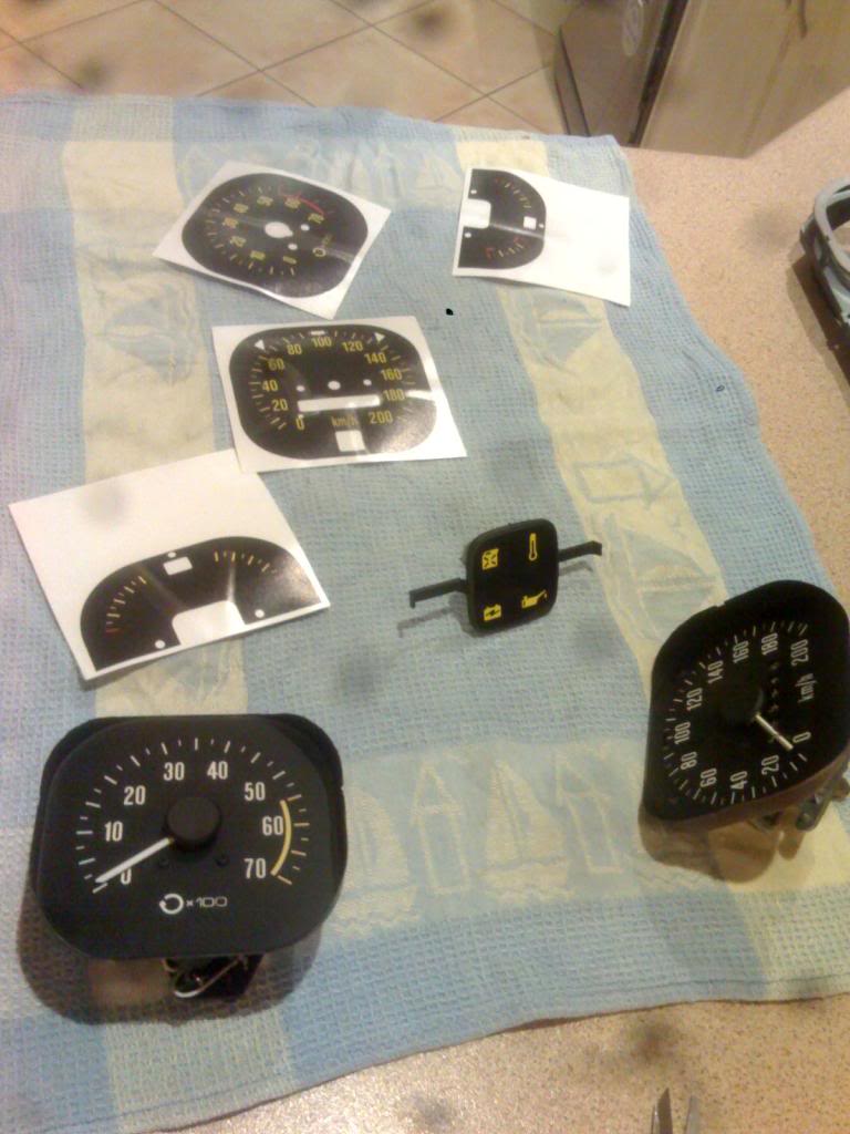

Thank Stu for those pics, are you guys just sticking those decals on over top of the old ones or removing the old stuff, if so how?

I sand blasted my fascias, primed and painted them black. Then stuck the decal on a fresh surface.
