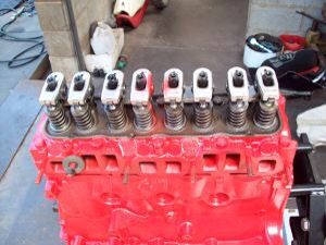

I came across some silly hill billy doing this?

niiiice! cept for the painted ports.
Nice! Can you send me the link where you found that please? I'd like to grab any photo's and info. .-.-.
#44 hanra
Posted 25 January 2013 - 06:46 AM
No link. A hillbilly sent it to me after he took the photo on his phone.
#45 orangeLJ
Posted 25 January 2013 - 08:09 AM
looks too neat to be Bombers shed? lol
#46 hanra
Posted 25 January 2013 - 09:51 AM
Bomber's not up in the Hills with the 2 country folk.

Posted 30 January 2013 - 12:13 AM
Other then the Roller Rockers, do you know anymore about the rebuild or it's intended future?

The hillbillies starfire
The head had ports cleaned up,v6 com valvles had heads trimmed to stock diamater
3 angle seats,new guides,top of guides cut to suit teflon stem seals,spacers made for
valves seats to acheive 135lb on the seat.
The block had 40th off the deck,rods balanced to roughly a tenth of a gram at both ends.
crank balanced,chrome top ring,10.5 cr,7.9 dcr.
This thing was going to be fitted with twin 40dcoe carbs, headers into a 21/2 pipe so cam ended up 289ex,292in(adv)
litf 329in,315ex. on 1.5:1 erson rollers.(they are lighter than yella terra)
As far as the future of it,who knows,starfires by general concesus are bad but this was going
to fitted into a uc which probably makes things worse.
It will probably just sit for now,was all just a waste of time. :P
cheers.....one the hillbillies.

Wow a lot of work for it to just sit and go to waste.
"starfires by general concesus are bad..." Got me beat why some people claim this?
I've had nothing but the best experiences with every one I've ever owned. And I've owned a few.
In what area's do you consider them bad?
