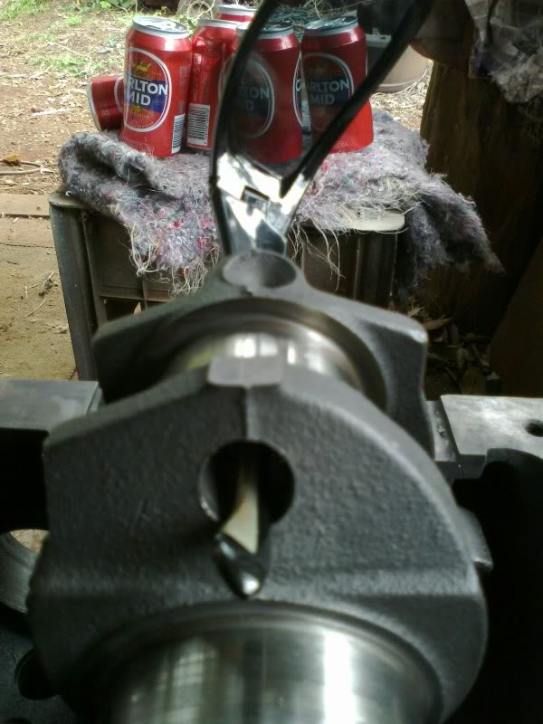

#131 hanra
Posted 04 July 2013 - 03:21 PM
#132 EunUCh
EunUCh
  • 2,774 posts
  • Location:not this planet
  • Car:japos
  • Joined: 23-November 06
Posted 05 July 2013 - 08:23 AM
^^^ WTF,wouldnt that weaken the crank so much that it would break?

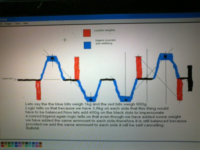

Yes I have heard of people boreing the pins on a six but as far as I know it was never fitted and tried for
some reason.
I have reduced the reciprocating weight by as much as practically allowable but I still dont think it will be enough
to come close to some sort of reasonable balance factor.
I think these things will need some extra weight on the counter balance weights but the popular opinion seems to be
that a mirror image crank does not need to use any sort of balance factor because of the fact that there is the same amount
of weight on each side.
Could someone expain in a simple semi scientific manner how on this earth that this type of crank can actually be balanced
if the pins are heavier than the counterbalance weights and  one pair is 180 apart from the other pair?.
And how using as much flywheel as possible would actually overcome the balance problems these thing have?
#135 hanra
Posted 08 July 2013 - 04:17 PM
#136 EunUCh
EunUCh
  • 2,774 posts
  • Car:japos
Posted 09 July 2013 - 08:56 AM
I would say with numbers like that the centreline would look more like the thick bent black line when its spinning?

Posted 20 July 2013 - 08:46 AM
That thing's got to be well under-balanced, I'm sure if you could pull some weight from the pistons, pins and rods you'd see some improvement.
Well observed,,,and just by looking at a picture.If my numbers are correct it is underbalanced by quite a bit,up in the 100's.
