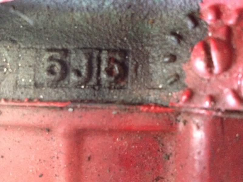

Here is the cast code from my HT 308.
Pretty certain its either 5 or 6 J 5
Which means 5th or 6th September 1975. My car is October 1975 so that is correct that the motor was cast a month or so prior to build date.
As far as I know its:
A = Jan
B = Feb
C = Mar
D = Apr
E = May
F = Jun
G = July
H = Aug
J = Sep
K = Oct
L = Nov
M = Dec
I isnt used as it can be confused with a 1 I guess?

looks like 6J5 to me as the top of first number is rounded and the last is square on top.. unless eyesight is failing me after a few cans :)

Brad, yours is 5 J 5. 5th September 1975.
Dave.
#5 hanra
Posted 27 October 2012 - 11:41 PM
Cheers Dave, depending which way you look at it, it sorta looks like a 6 but also looks like a 5....?
But yeah, Im gunna go with 5 also.

ok so it day/month year. what does the clock dial next to it refer to ?
#7 S pack
Posted 28 October 2012 - 12:55 AM
Time of the day.
The clock on Brads 308 shows 1.00 o'clock.
I presume it is 1pm, however if they had night shifts in the Foundry then it could be 1am. :dontknow:

Just behind the top of the timing casing/water pump.
