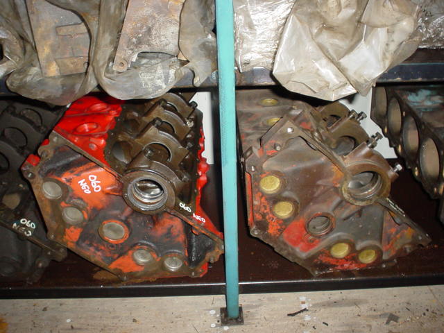

Posted 21 December 2012 - 08:35 AM
Block on left is first gen red neo seal, one on the right is second gen red rope seal.
Notice the difference on the rear boss where the dowel pins are?
The rear boss of my block date code J151 matches the pic on the left, so I presume mine has a neo rear seal. The 308 casting appears to have been ground off, perhaps when it was stroked to 355.
