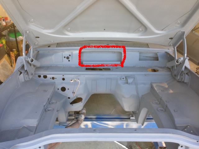

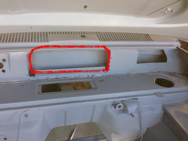

here is a little story for you fellers take it how you want but use this info in the right way...
in 1971 gmh had a plan to build the LJ torana and with this car they also planed to place a radio in the dash but like the early 69 and 70 model lc the radio would hit the back of the dash where the wiper arms bolt up
post-18834-0-83082200-1369464865_zpse9ee
post-18834-0-53808200-1369464778_zps1b98
as can be seen in these pics above^^^

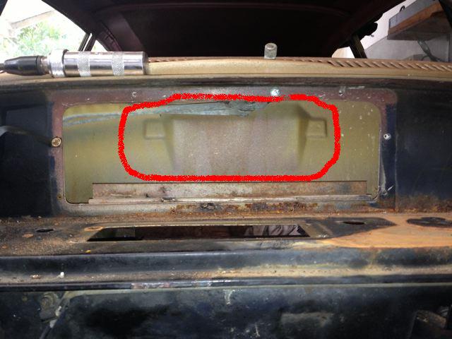

so in 1971 gmh changed the shells and added a recess like in these pics
post-29243-0-14889300-1358329074_zps1698
and my 71 CK BATHURST

Wow. Cool, thanks for that bit of info. Quirky.
So up until that change, did Torana's not have a radio in the dash? Sorry. I don't know much about little Torana's.

the lc had a under dash radio and bracket.

And this is just one of many changes that Gong has pointed out in these shells. Not only LC but LJ as well.
