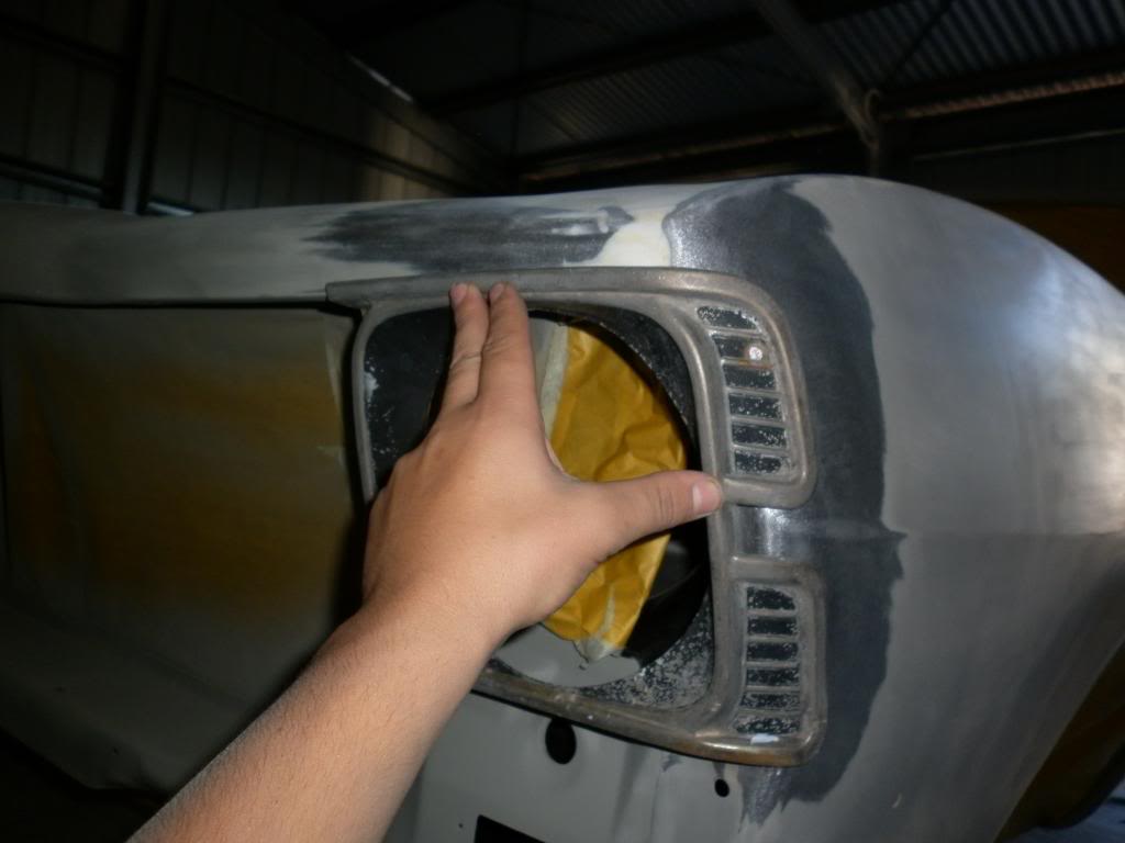

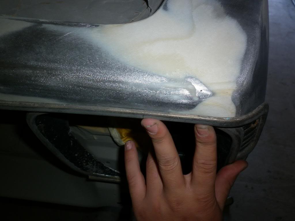

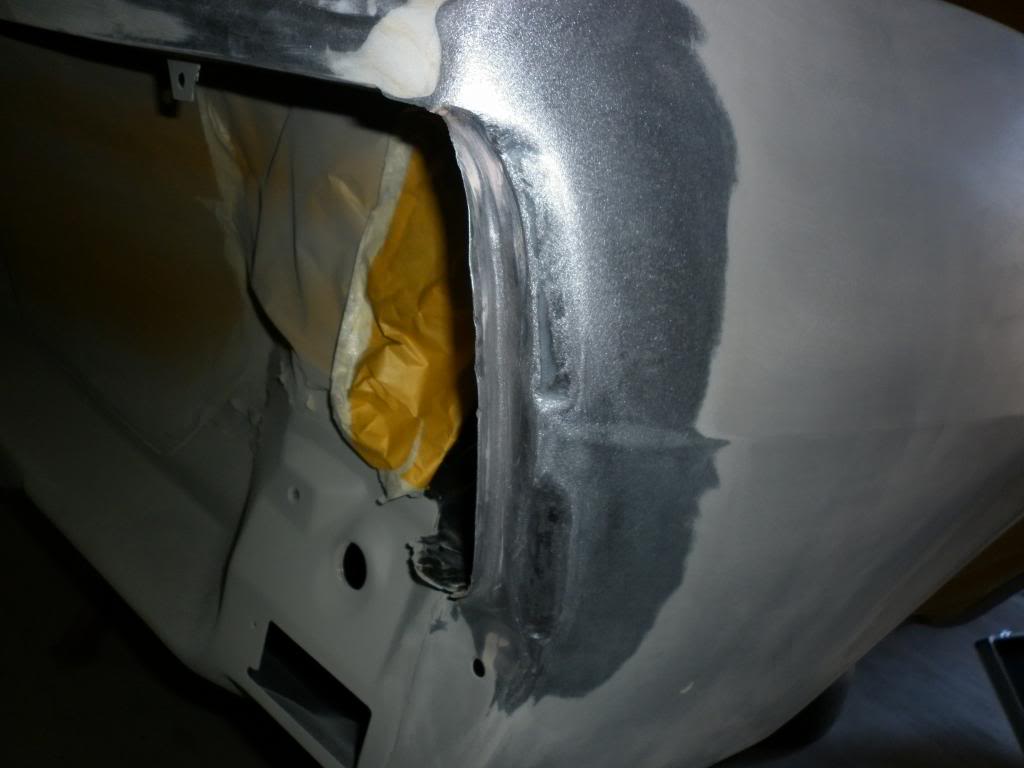

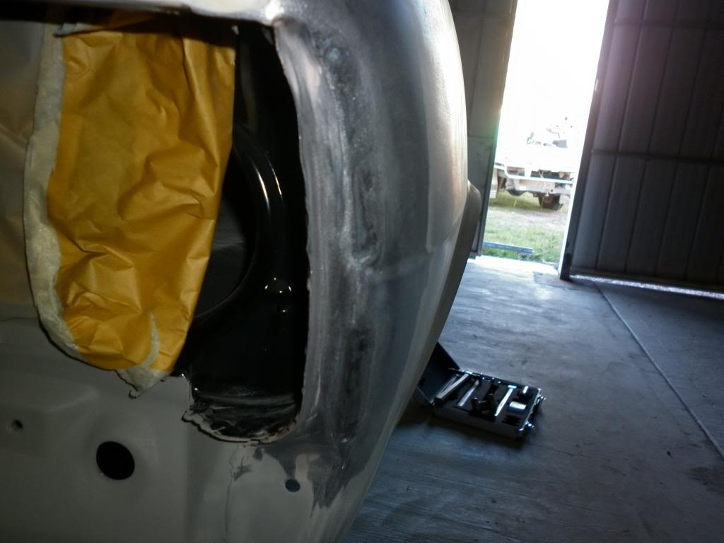

Posted 29 December 2012 - 10:18 PM
Here we go, this is my first attempt at uploading pictures. Hope they work haha :)
#60 S pack
Posted 29 December 2012 - 10:52 PM
Not bad for a first attempt Kieran. Now all you have to do is extend the section of the guard at the crease line to close up the gap that you can see in the middle of the bezel.
You can do this by heating it up and carefully picking it out from inside the guard with the picking hammer and finish it off with some filler or just build it up with filler but I'm not a fan of using heaps of bog.

now back to your guards mate, where dave just pointed out to you, the best way i worked it out was to tig build up this as its easy to control your feed and your heat.
they look great so far top job.
