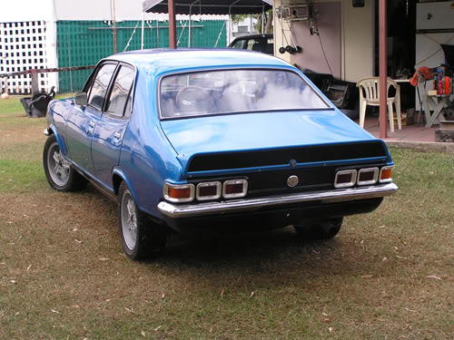

First time i painted my LJ, this is acrylic, did it when i was 15, long before i was the knowital trade qualified painter type i am now, in protec. This was done under a gum tree in the back yard.
Now re application, the way i sprayed it in that case was just lay everything on cause i didnt know any better.
If i was to do it again in acylic i'd go the latter method you mention. Dont sand between base and clear, but a bit of blocking here and there doesnt hurt. Makes the finish that much more special. Theres a reason guys charge 15k to do an acrylic job, and thats after the car is prepped ready for a prepsol mask and tack. Its because of teh time in spraying and blocking.
Good finish, lay everything on, color till hiding (no shadows) then clear till you think you have enough to buff.
Unreal finish, take your time and block between stages.
I agree dont sand before clear, perhaps your not understanding that properly. You should nto put down the color with a metallic, then sand, then clear, this will expose the aluminium fleck to much and make the color totally different. You are wshing to spray in black, so although i wish you would totally forget about a clear, if you really must put a clear coat on then you can sand that before clear, so long as its uniform.
