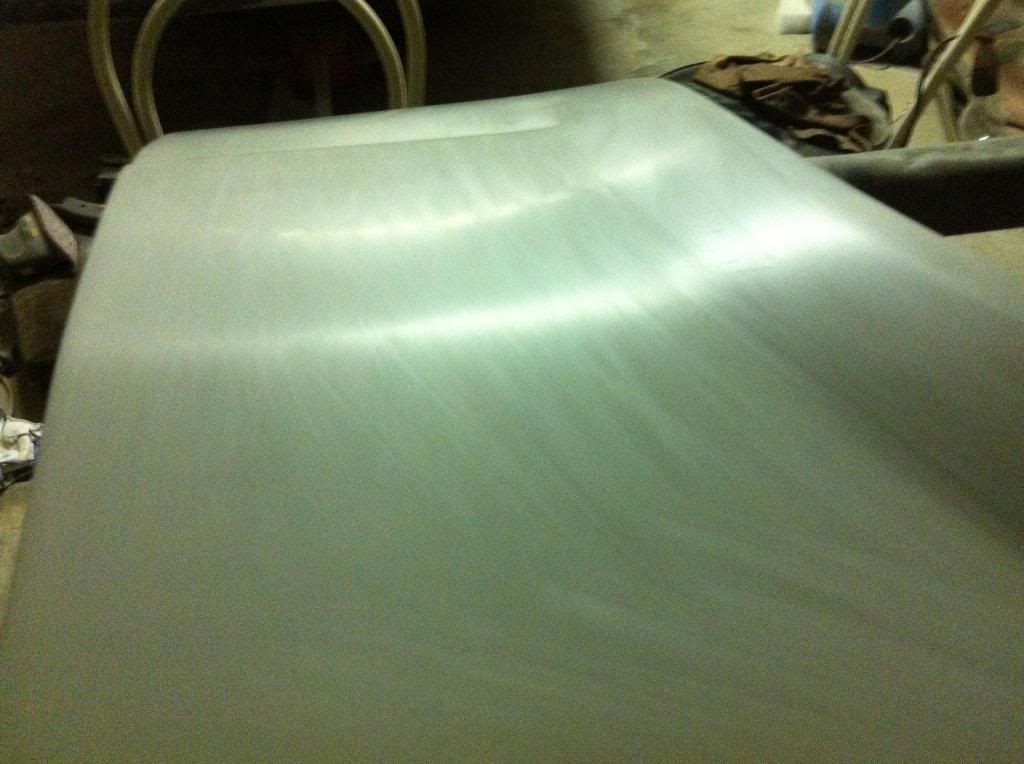

Either you have used black undercoat or there is no pic there sorry, can't see it.

Ah I see it now.
Oh fark, they look like train tracks, does it wipe off or are they permanent?

#68
Posted 18 February 2013 - 08:49 PM
Like this ^

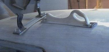

I refer to the equipment and technique, use the largest hardest blocks/boards that will contour to the panel.
Also I sand in a cross hatch pattern (70 to 90 degrees to each other) by sanding one way then sand again in another, ie top left to bottom right then again from top right to bottom left.
Never in one back and forth direction and never in circular motion.
#71
Posted 18 February 2013 - 09:09 PM
So like in this example I would use one board for east/west sanding and the other contoured board for north/south sanding.

As large (long) as you can comfortably fit to follow the contour of the panel.
Soft blocks are only good for colour sanding. JMHO.

Anything that is too flexible will not allow you to apply even pressure.
