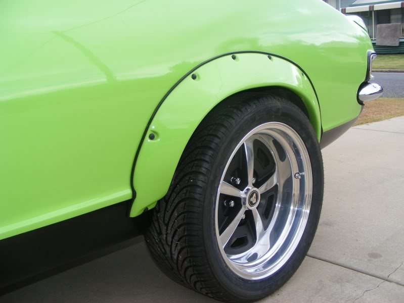

Fit flares and easily fit 295's ... I am running 17" 255's with plenty of room ...

Flares look great on your car, but not the look im after. P255/60R15 ET street radials on 15x8 with 51/2 backspace is what im thinking. Hope I dont have to cut and shut it to bad to get them in.
