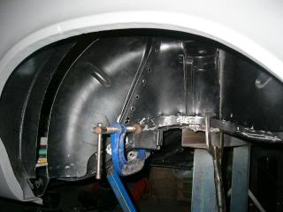

Here is and understanding of a standard LC / LJ inner guard with the biggest tyre to fit without too much work.
You can see here, is a 245/60/14 on 6 1/8 inch off-set 14 x 8 rims:-
good clearance under normal guard
Attached File  IMG_5481.JPG   47.15K   16 downloads
just fits in the side space
Attached File  IMG_5482.JPG   32.89K   12 downloads
needs the front of the inner guard moved in at least an inch
Attached File  IMG_5485.JPG   40.6K   16 downloads
plenty of clearence at top of wheel, except the shocky needs moving in at the bottom mount hard up
Attached File  IMG_5486.JPG   25.09K   16 downloads
and just needs a little shut job at the back of tyre, 245/50/14 don't need this bit done
Attached File  IMG_5484.JPG   41.39K   19 downloads
