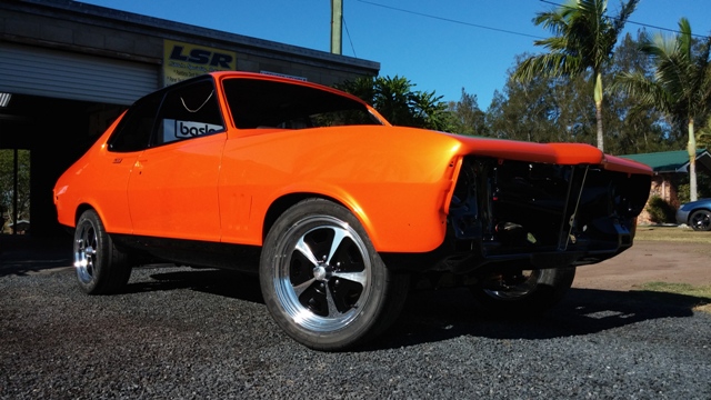

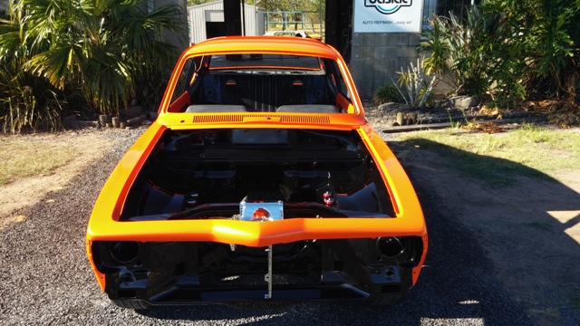

Are you happy with the Blackouts front and rear? I will be ready to paint my LC soon and these are the best pics I have seen of the lines without the bumpers fitted.
I think so, they are correct to the best of my knowledge, but someone like gong (LONA-CK) would be able to tell you with more experience than i can

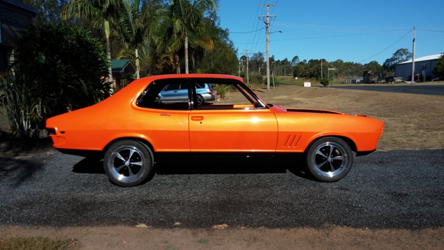

that looks great champ,,, what size wheels did you end up using mate, they really suit it, do you have much clearance under the front guards
cheers gong
Thanks, they are 15 x 8's and 15 x 7's. At the moment there is not much room because it has 235's all round because that was the only size I could get in the semi-slicks. We will probably take the front tires off and put 215's on the front. It also hasn't been wheel-aligned and it has a fair bit of positive camber, should be more than enough room once we put the 215's and get it wheel aligned.
Keep in mind we have leyland p76 hubs and custom stubs though.

Looking the goods mate! Love the wheels, 15's are perfect on LC/J's :)
Colour looks nuts in the sun too!

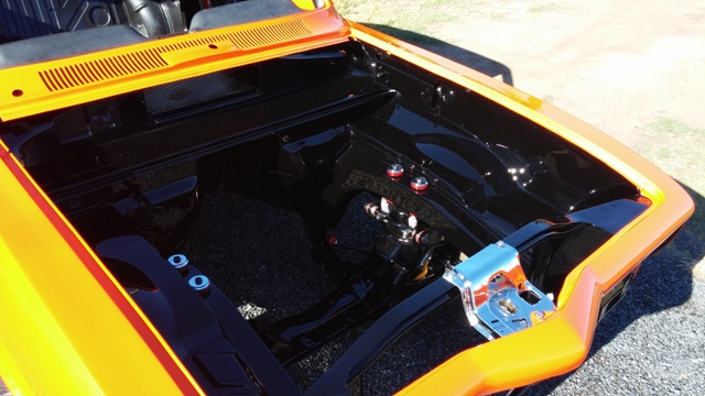

those 4x red rubbers thingies in the engine bay.  what are they called and where do i get them?  mine are stuffed

They are polyurethane bushes by nolathane. Depending on the company you get them from, you will get different colours. Nolathane is red. They are the upper k frame to chassis mount rubbers, there are 8 of them.
#475 _injlc304_
_injlc304_
Posted 18 February 2014 - 07:36 AM
no probs thanks mate.  where do you get them? rare spares?  whats the best ones to get?  my ones perished and integrated
