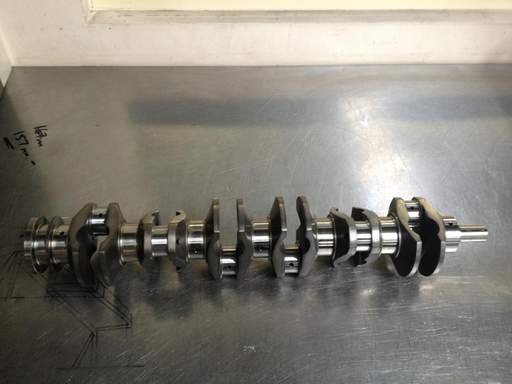

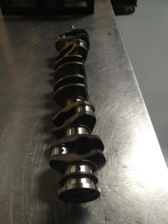

Ok, bit of an update on the engine, message from the engine builder;
"I'm waiting to see a 4340 crank that one of the top circuit car guys has bought. If it looks like a good deal I will order one as they are breaking the standard cranks often now. Once I have crank, rods and pistons things will be all go! I have to make a dry sump pan as we discussed, I have marked out pan to cut, but that's about it. Block has been line bored etc but not bored or decked. I probably should order custom steel cam and roller followers now..... that way we will have every ready to go. I will keep you informed"
Starting to come together!
After seeing the crank, he said that it looks good. Had large counterweights that he lightened, different in oil setup, but looks good.
Here's some pics/

Very Nice Ryan,
I have seen that Crank around somewhere, has the same counterweight shapes as your picture has. Dave I
and is it a Rope seal one or a neoprene seal
Do you remember whose it was?
The picture was taken at his sop, I think he had to do the lightening and balancing for whoever owns tat particular crank.
I have no idea, sorry

I will have a Scout around for You on the net,
I wonder how to tell what seal a crank has by looking at it. Dave I

may have been this RB30 one:-
http://www.gmh-toran...e-3#entry494736
but I will keep looking
Well, I have now looked at 100's of Holden Steel Crankshafts,
and there is noting that comes close, except the RB30 one,
RB30's went well, so you better find that owner Ryan.

is that one of the 'Tighe cams' crank's?
okay, interesting.
We are getting one made the exact same as the one in the picture.
Umm, I thought it might have been a Tate crank, will find out
You were right, got my names mixed up. Ivan Tighe it is.

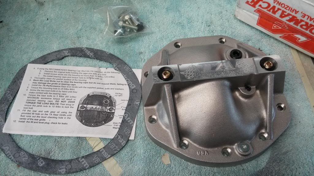

Poor packaging resulted in it being scratched. No drama, I sanded it with 400, 600... 1500 and gave it a polish on the wheel. Looks better than before anyway, so thanks to whoever backaged it with metal clips holding the box together! (Pic is before I polished it)

Few mods to make it fit (knew that before we bought it). American borgwarner is slightly different. Had to drill the bottom hole out to 12mm and had to slightly machine the bearing caps so the girdle had a flat surface to push/support.

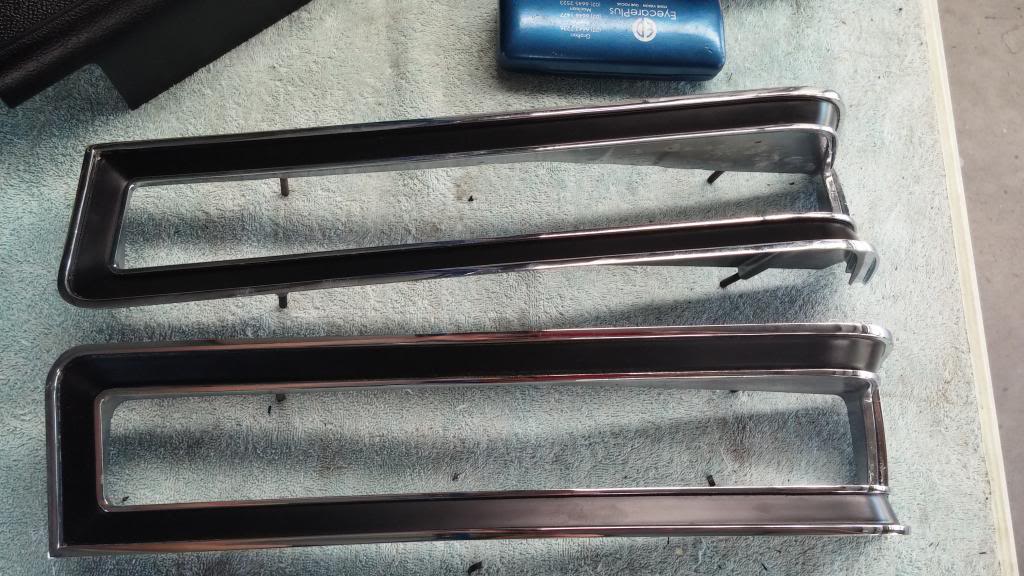

Had my tail lights electro plated by a 'guru'. Not happy. Same story as the rest of the chrome i sent to a different guy, outside; perfect, inside; far from it.
Looks alright in the pics, but all the inside edges are frOcking bubbly and shit.
Maybe i'm being a bit hard, anyone ever seen PERFECT chrome on tail lights before??

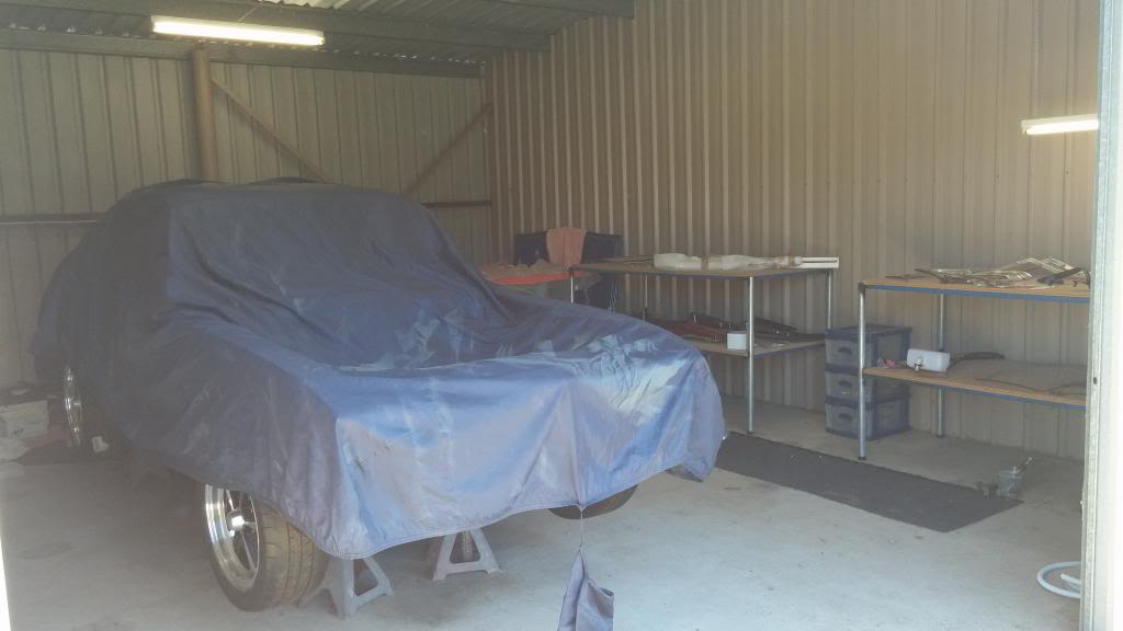

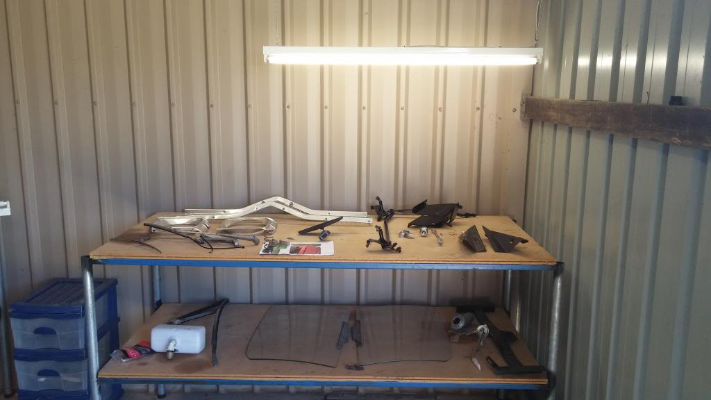

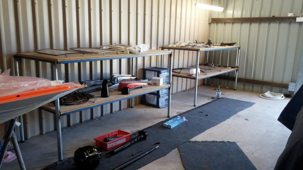

Starting to get the shed all set up!
Good idea Ryan,
also, you are good, a Crank like that for less the 5 Grand. Dave I
$3000 all up after some machining and balancing.
Edited by gorto, 22 April 2014 - 09:12 PM.

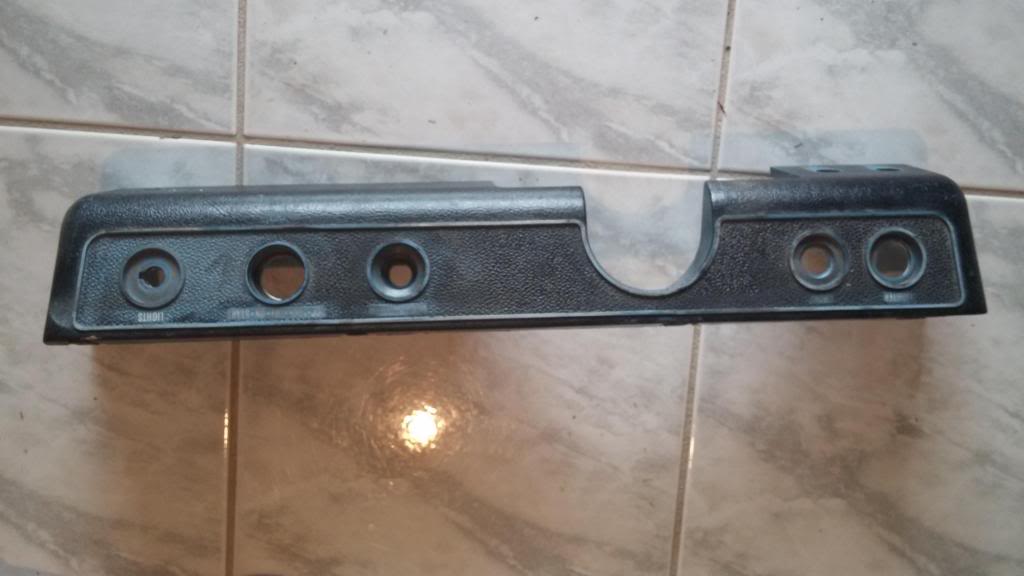

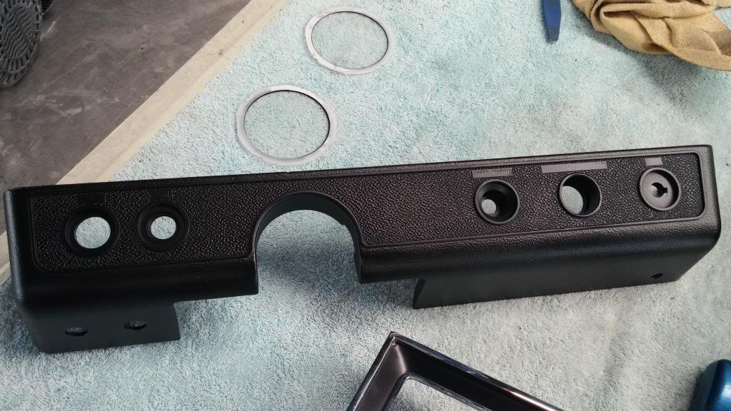

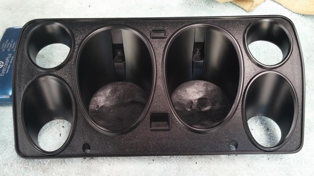

Here is the starting point for the under dash
Gave it a coat of Satin, now im stuffed if i know what im going to do now.. started masking it up to paint the silver lines, but its so hard to get it perfect!!
Will probs get tiny stickers made up for the lettering, i dunno..
Also painted the dash and gave the lenses a bit of a clean-up

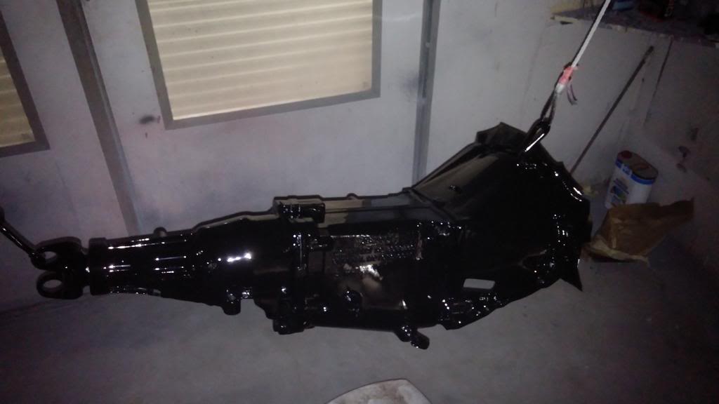

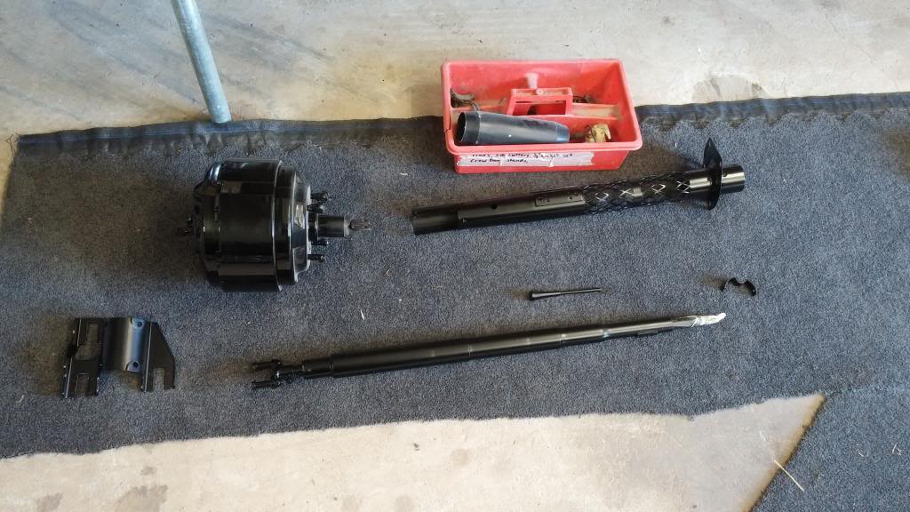

Started restoring the steering column, need a new lower bush. Getting that made.

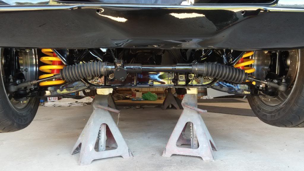

Fitted new rubber boots and lower ball joints
