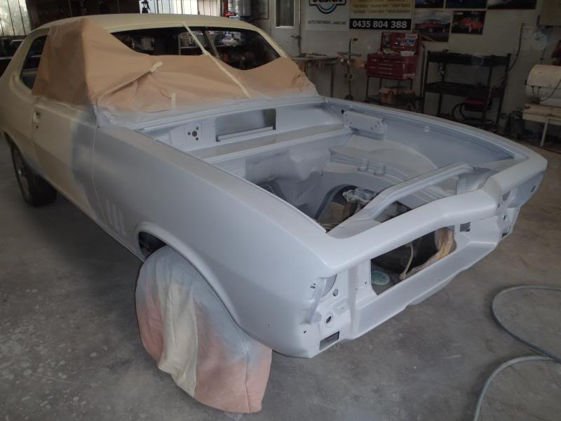

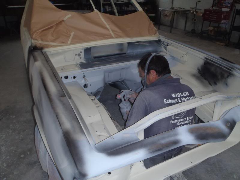

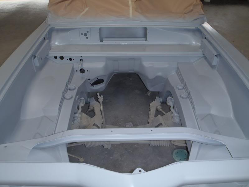

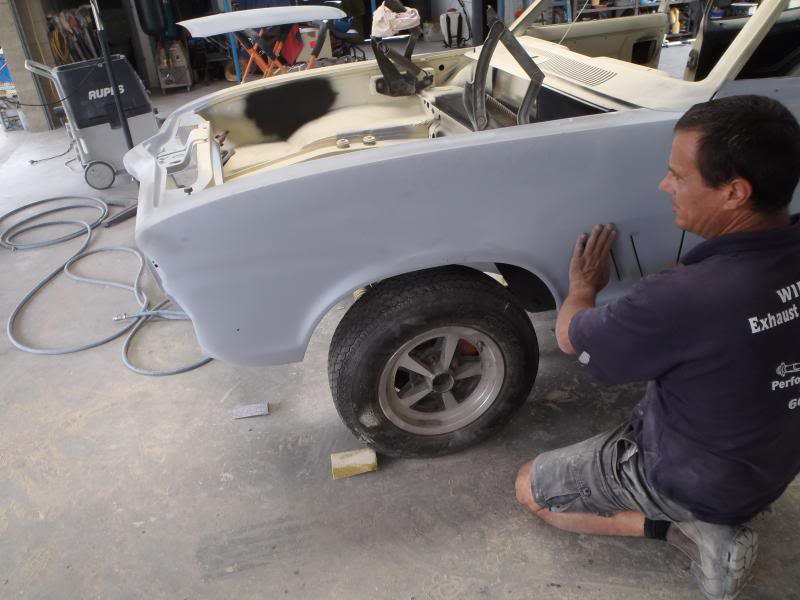

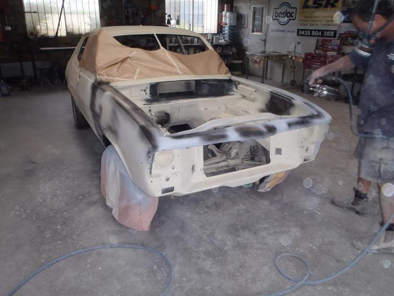

getting ready for final prime before paint
#52 _gorto_
_gorto_
Posted 18 April 2013 - 06:52 PM
car is now fully primed for the last time! but i dont have any pics unfortunately.

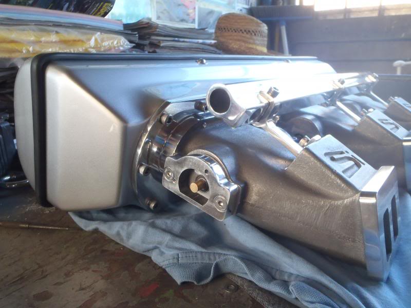

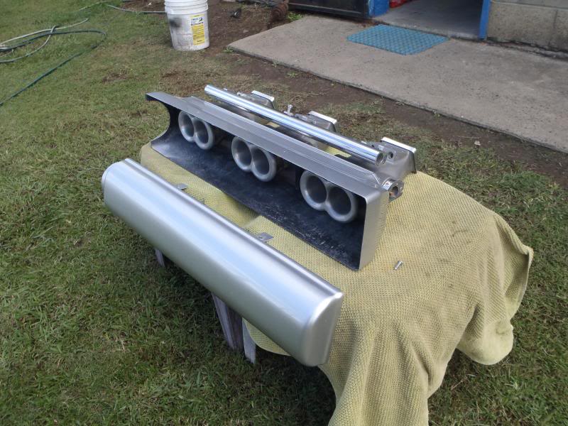

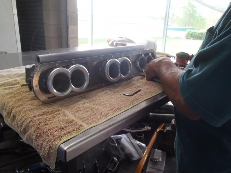

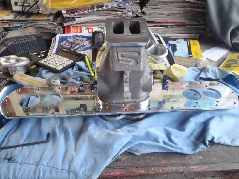

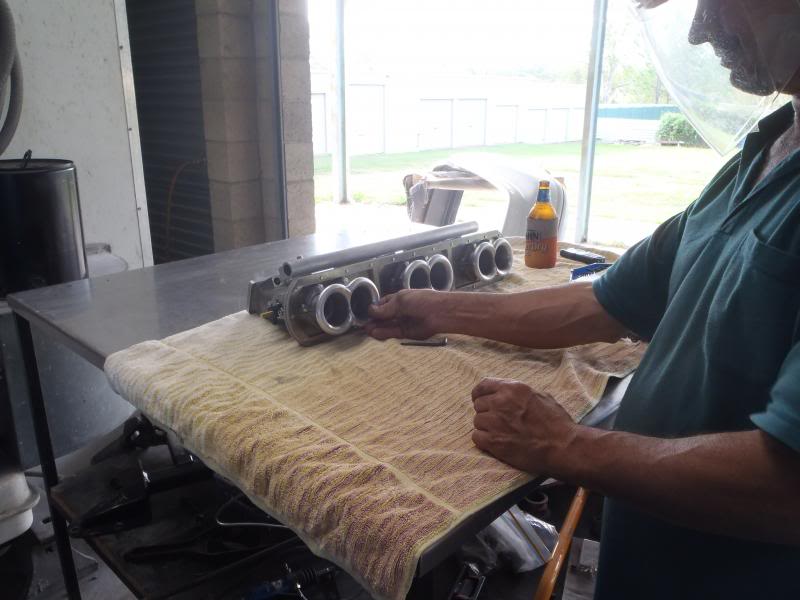

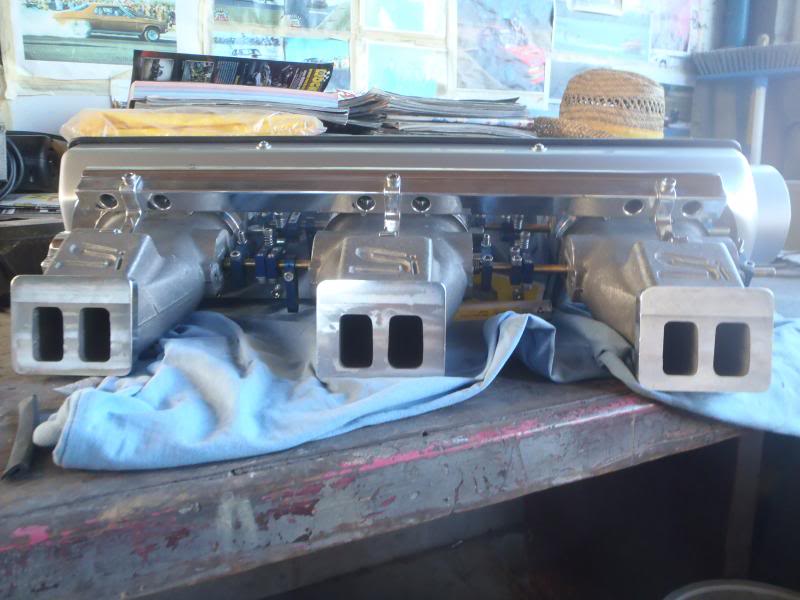

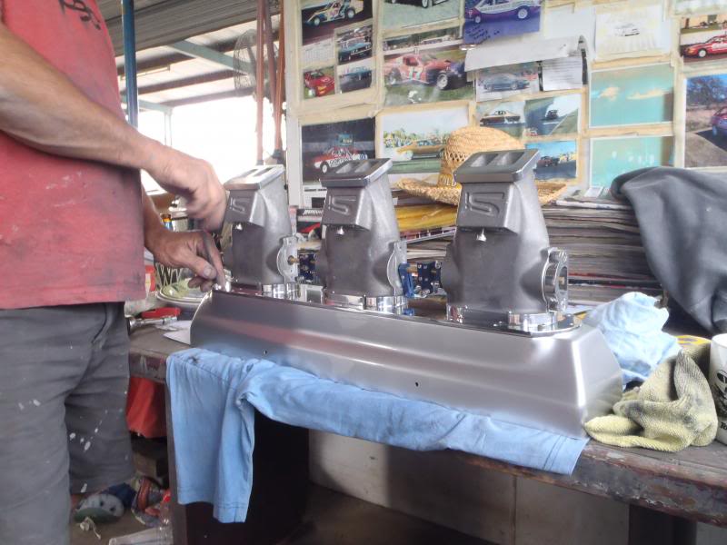

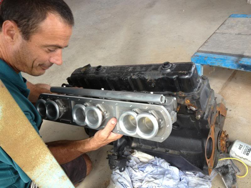

Here's some pictures of when the injection first turned up.. the latest photos are still uploading to photobucket
sitting next to an old 202 that we use as a dummy fit motor

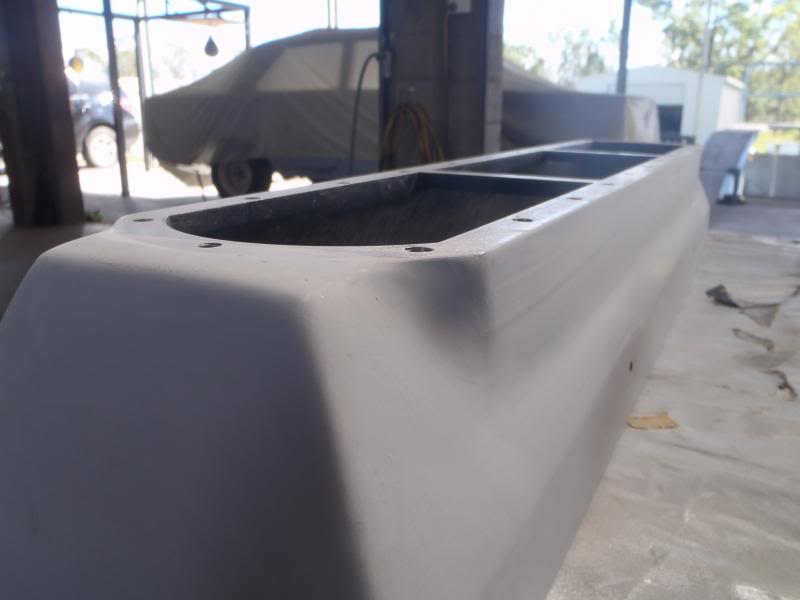

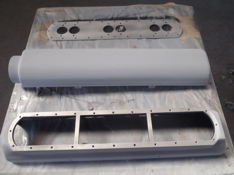

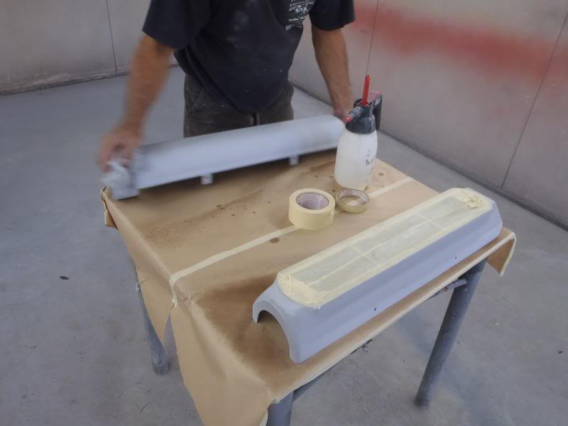

bought an efi hardware air box and moulded it onto the turbo plenum base plate, pictures to come...

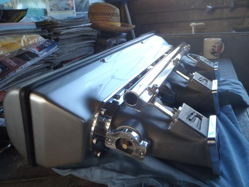

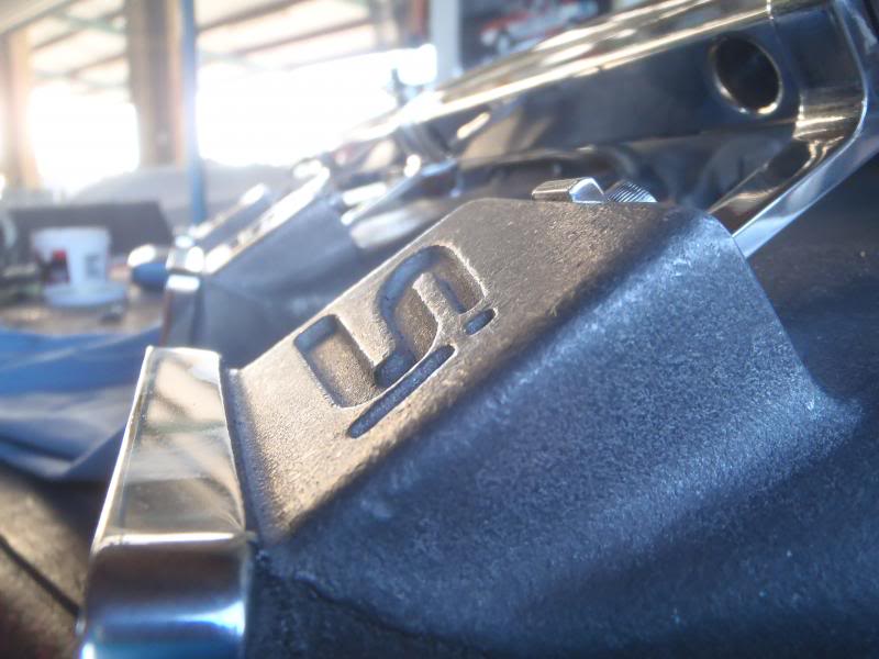

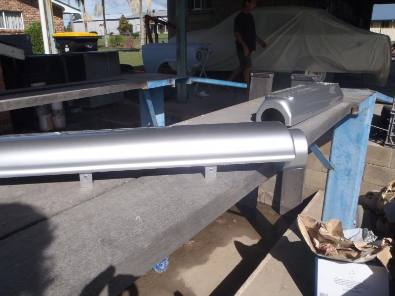

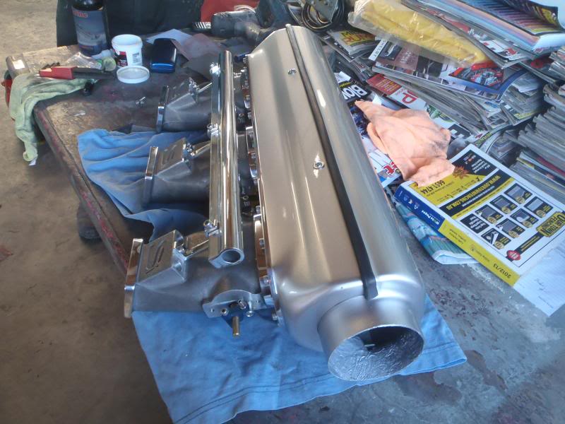

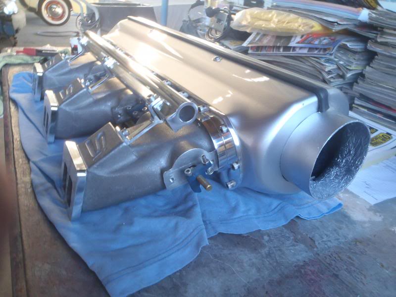

Ok, off to bed now, big day tomorrow, we are driving up to Brisbane to see the engine builder

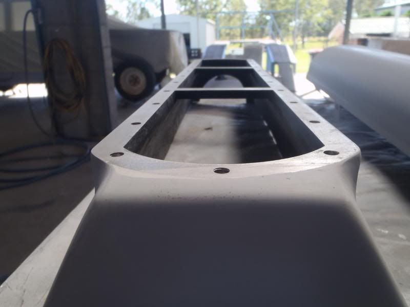

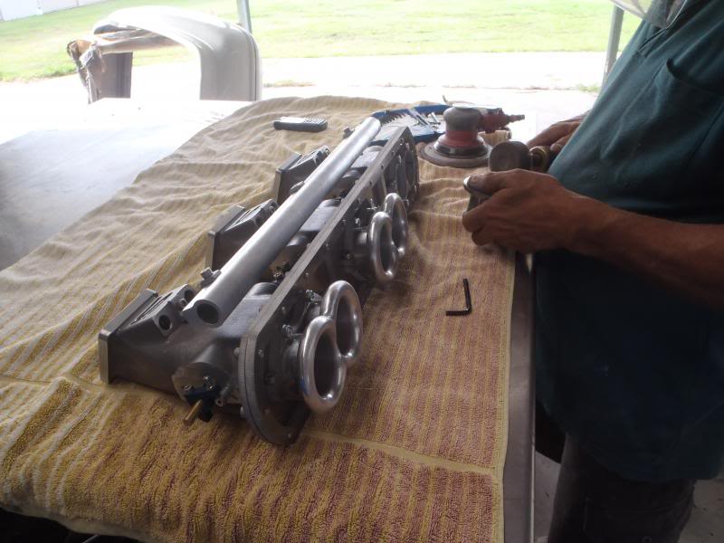

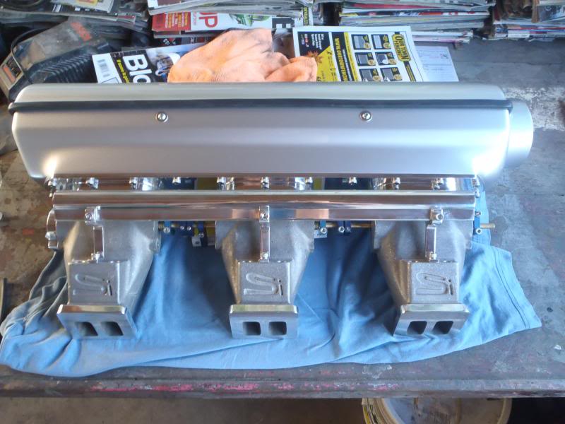

Heres some pictures of the polished injection
Your thoughts and oppinions on the build are welcomed :D

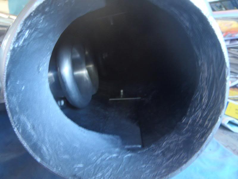

Air box needs to be changed slightly, needs to be tapered towards the back so that the rear trumpets dont suck air away from front trumpets and create an imbalance, or something like that?
computer will be a motec. i think it will be the m84, not 100% sure

That plenum looks awesome!!
Where bouts you going to run the air ducting? will be pointing straight at the battery as it is.
Its going to be a show car.. i dont think the battery will be in the engine bay
There will be a small length of pipe and then a pod (sensor inside the pipe)
