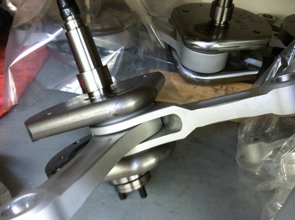

#70 _Bomber Watson_
Posted 29 June 2013 - 01:32 PM
Have a look at harley rods :-)
#71 N/A-PWR

#72 _oldjohnno_
_oldjohnno_
Posted 29 June 2013 - 02:19 PM
That's fine for a built-up crank, but how are you gonna do that with a one-piece crank?
