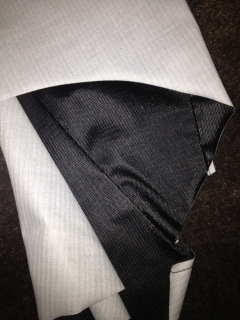

Hay Dave, is this what your calling herringbone?

Yeah Tony, ^^^^ that looks like it could be Herringbone pattern although a close up pic would be useful.

herringbone

i just read from the top... some call it ribbed... its herringbone.. they call it it ribbed as it has lines in it

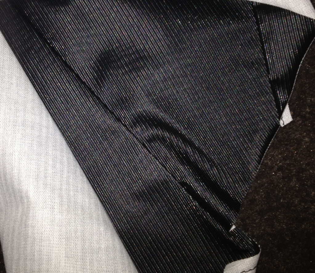

7c861b761347c9877c5dff9ad45b63b4_zps17e9
Yea, it's ribbed to me. I thought herringbone had angled ribs.

from what i can see from your photo that is the herringbone headlining that is used in the lj... hq and 4 door torana's lh lx
the other headlining are roeubck... lc and sandpaper lx hatchback and hz sedan
there will be variances in which models all my original patterns were removed from original vehicles many years ago
sorry hq monaro 2 door

Tony thanks for the better pic of your headlining. As Boomfunk said, that is Herringbone pattern.
