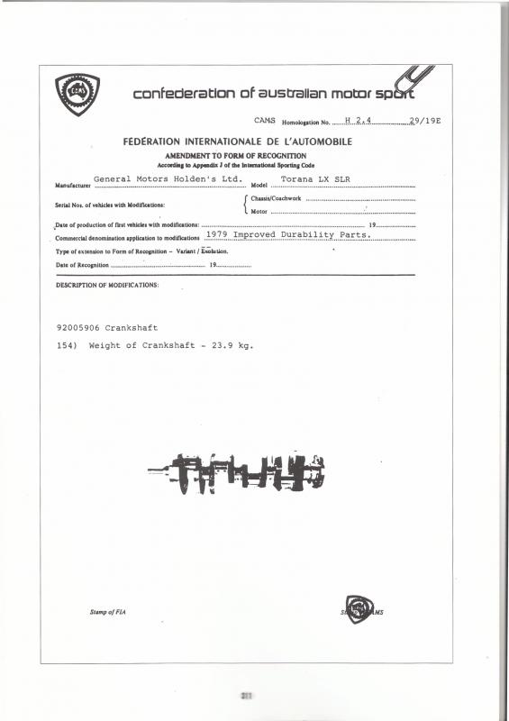

GM Parts & Accessories News 7th November 1979.
L34 High Performance parts serviced for LX Torana Performance Equipment Package Option A9X.
GMP&A have released the following L34 high performance parts for fitment to LX Torana vehicles equipped with the A9X option package.
92005960 Crankshaft
92011190 Pistons & Rings with Pins
etc etc etc
The high performance parts will enable owners of LX Torana models equipped with the A9X option, to increase performance of their vehicle for trial, rallying and other competitive sports. So let prospective customers know that the above L34 option parts can be supplied.
Just on a side note. Another GMP&A News from 1980 lists the L34 replacement block (lip seal type, presume that's a neoprene type seal) fitted with pistons as currently available.
Nice summation a few post back there Red, however it still leaves me wondering why GMH would send out the above info to the Dealers with the crankshaft mentioned as being an L34 part and advising that it can be fitted to LX A9X as a performance upgrade if the A9X L31 engine already incorporates said crankshaft? Admittedly this advice was sent to the Dealers in November 79 and the A9X's mainstream racing career was near it's end, so I'm thinking maybe GMH just wanted to move their remaining stocks of L34/A9X performance parts from the shelves.

This thread has given me a headache. I don't know why people take what the rock spider says as gospel, but he is wrong once again. Dave, you were on the money. The L34 came with a rope seal, not neoprene, however Les Small has said that a few race teams wanted the Neo seal as they believed they were more reliable (remember all the smokey Toranas on racetracks in 1974?) and they also produced less drag. The difference between rope and neo was only the machining at the end of the process, so would have been easy to set up for the guys who wanted them. I have seen 3 of the later blocks with neo seals now. A mate of mine has seen one that was cast in 1985.
The CAMS amendment that Shaun posted above looks to me to show a neo seal crank. By 1979 it would have been getting hard to find good second hand ones as they hadn't been produced since April 1974, and as the 1985 block shows, there were racers who wanted to keep using the neo seals.
