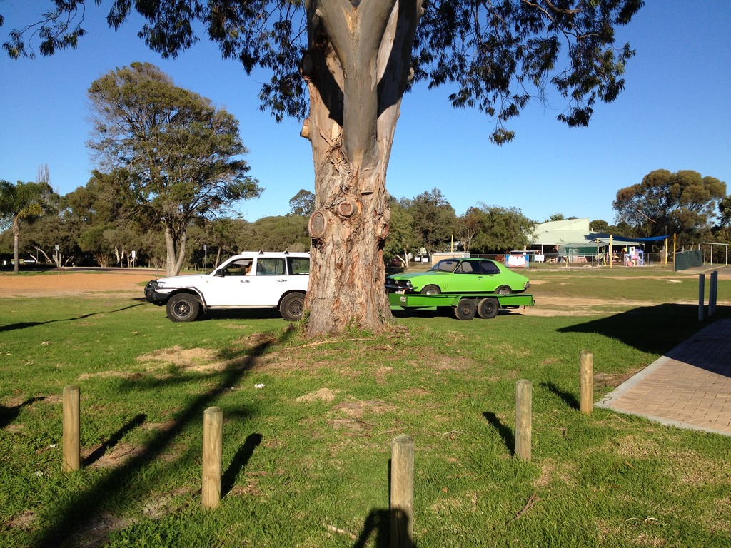

I was reading an Oct '74 West Australian yesterday and it had a "Lime green LC GTR" in the for sale column.
Hmm.....interesting.....unlikely it was mine though cause it is a Queensland car.
The guy I bought it off seems to think it was here then Qld then back here but as far as I can tell that is unlikely.
She aint no trailer queen Gene, this is from the day I picked her up, matching trailer and all lol.
Was testing the new Photobucket plugin, seems to work for some but not others.
