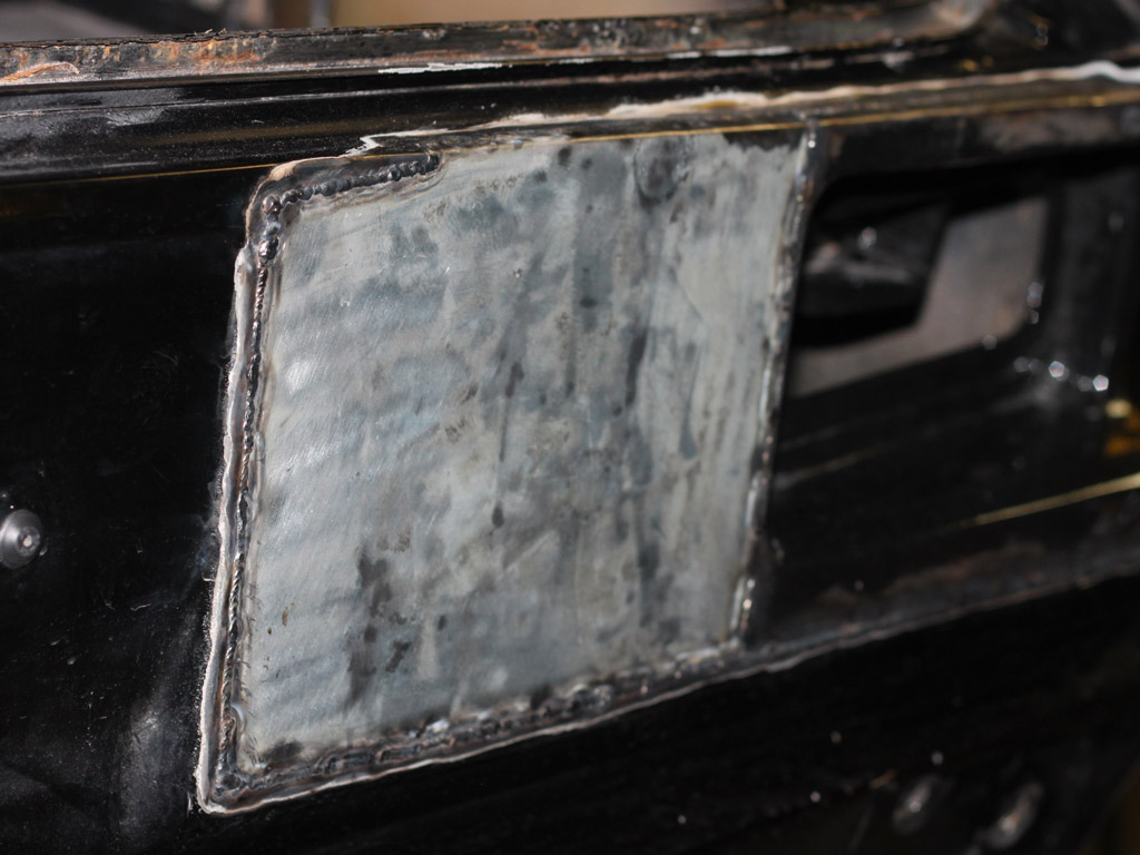

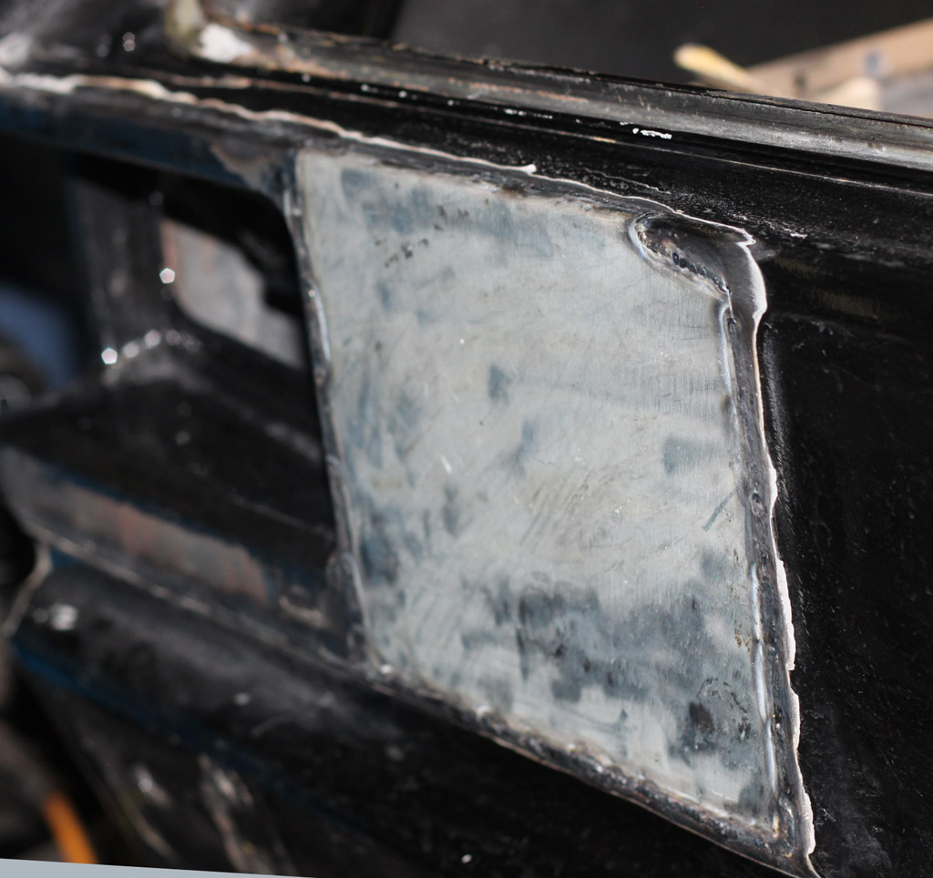

#417 Heath
Posted 02 April 2015 - 09:44 PM
Just some better photos of the welds on the flat panels the other day.
Actually getting a better TIG nozzle this weekend with the gauze etc. like the ones the guys on YouTube always rave about. Too bad I've already done basically all of the external welding.
#418 _AD_75_
_AD_75_
Posted 02 April 2015 - 09:53 PM
Looks like those patches welded in good health id be happy with that.
Edited by AD_75, 02 April 2015 - 09:53 PM.

#420 _76lxJAS_
_76lxJAS_
Posted 02 April 2015 - 10:44 PM
gas lenses are great. they provide so much better shielding than a standard nozzles..
its all i ever use. #7 for me for most work,,
if you have the $$ the stubby lenses are pretty good also. they make the tig head so much smaller and bit easier to get around tight spots.
tig fingers are a great help. allowing you to rest you finger on the job without burning yourself.
