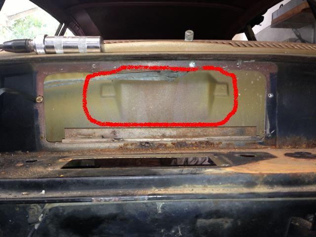

yes dave it was a 10-70 xu1
research has showed that this change
post-29243-0-14889300-1358329074_zps84e0
was made very early 10-70
cheers gong

OK thanks John I thought it didn't happen until mid 71.
Cheers Dave

Posted 05 September 2013 - 06:14 PM
Keen eye gong
