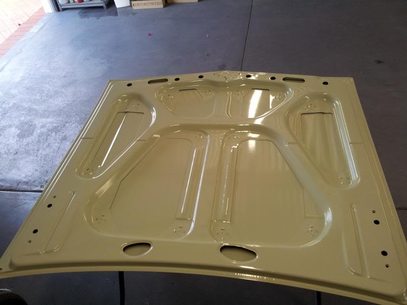

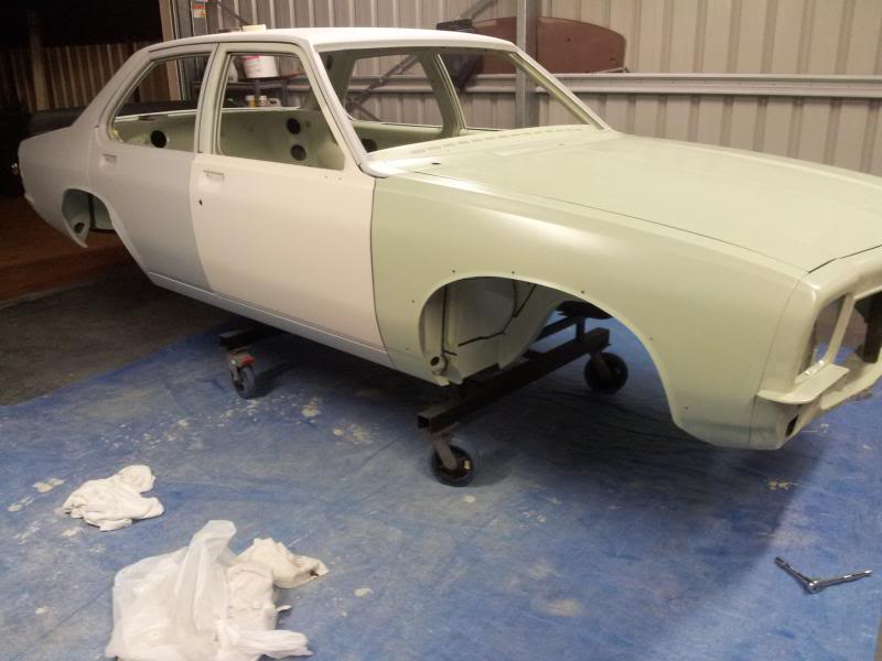

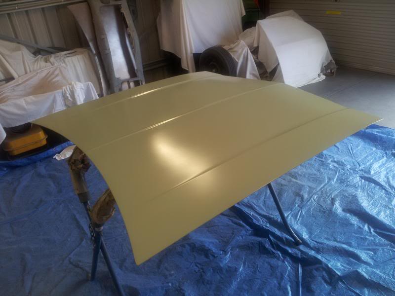

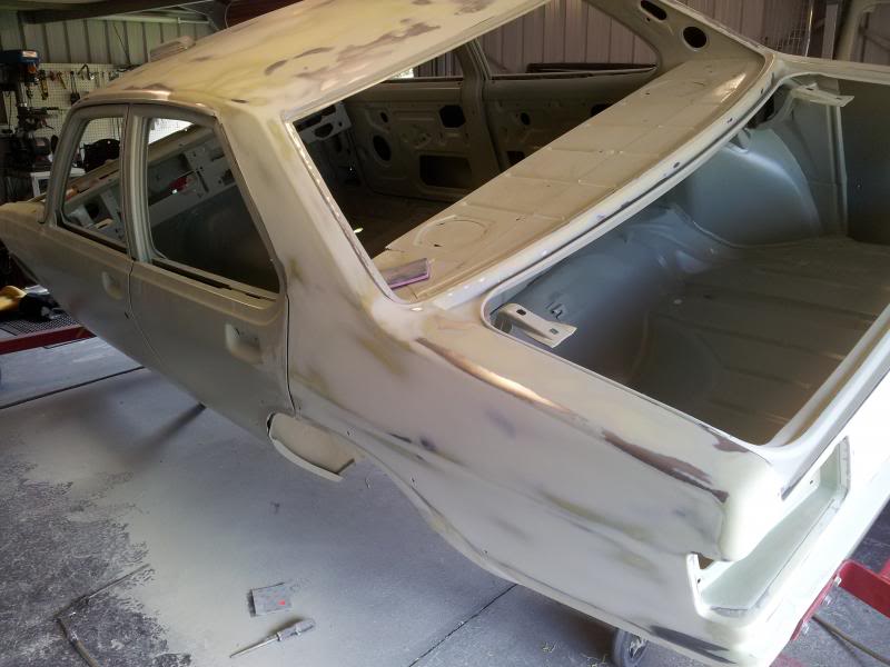

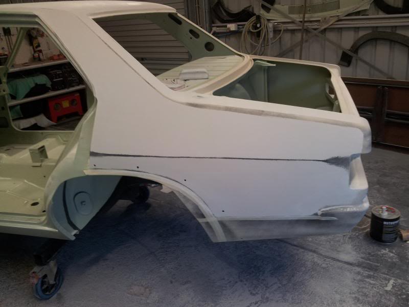

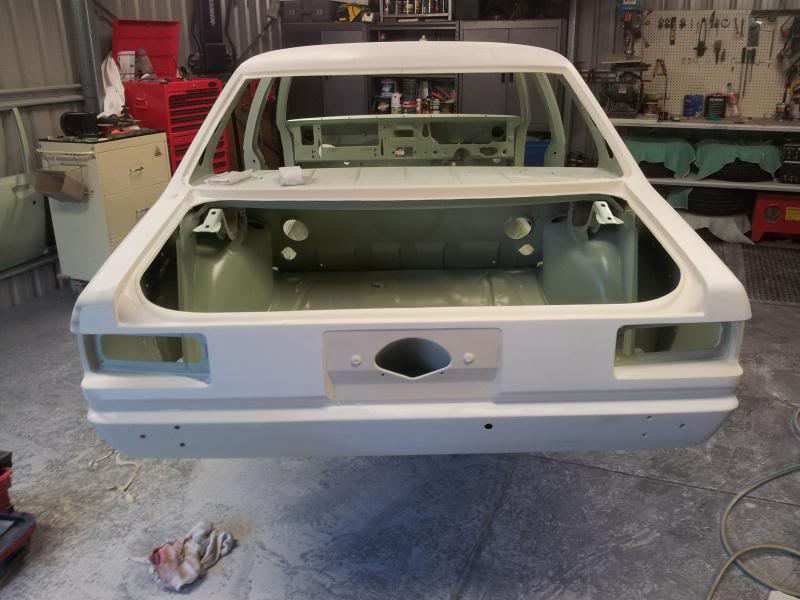

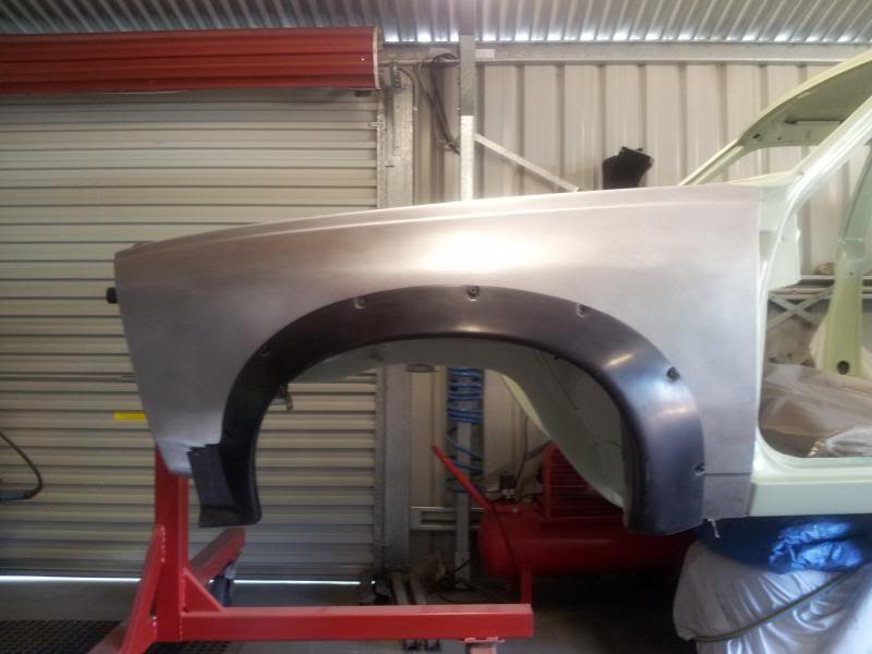

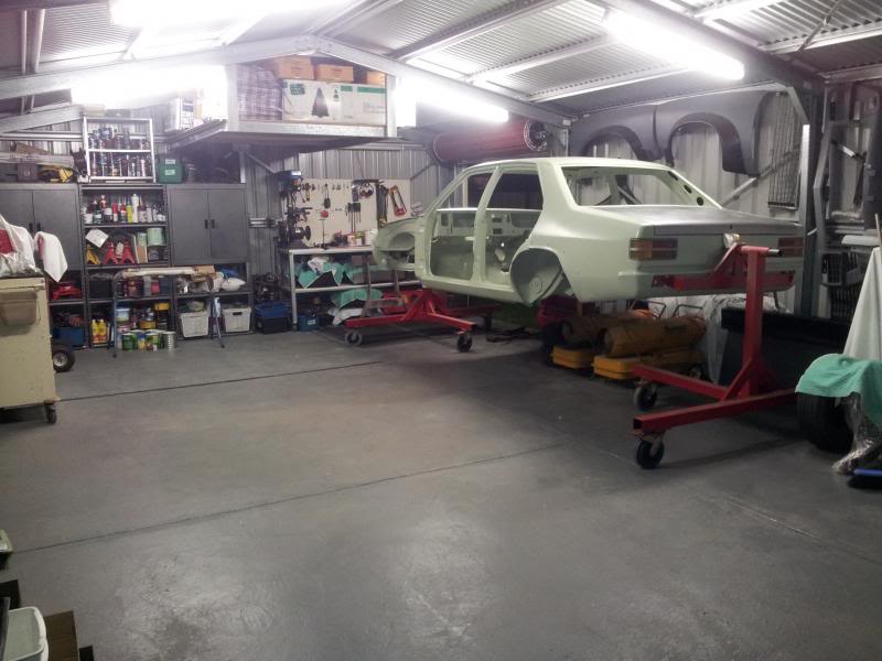

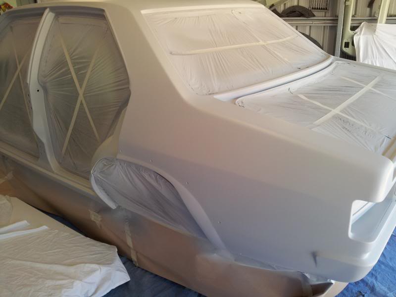

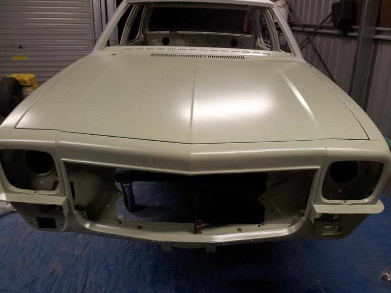

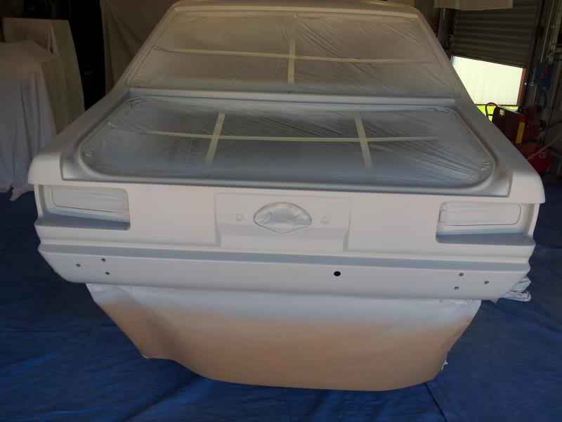

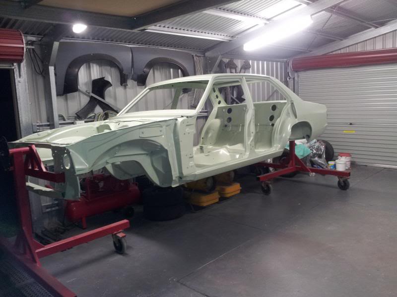

Well its been months since my last update but the work on the Torry hasnt stopped.........been doing the body work, skim coating panels and spraying polyester filler to refine the profiles even further.
So far so good......spent a lot of time blocking and making dust......certainly messes up your shed thats for sure :sucker:
Heres a heap of pics of the progress so far.
This is where I was up to in my last posts
Gave the bonnet a strip and a coat of epoxy 408
Then the doors and front guards
Had a little trial fit of the body kit
Started skimming the panels flat.....its amaising just how ripply the body was so it took a lot of work and guide coat to get her flat.
Smoothed out the apertures and sills and re epoxied.

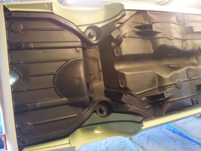

Seam sealed the floor pan and gave it a coat of Sika Guard rubberized under body coating......nice stuff
Time for the Reface polyester spray filler.....I like this stuff... sands like chalk...gave the body 3 coats and allow to set up for a week.
Blocking the reface using guide coat and tape to keep the lines nice and straight.

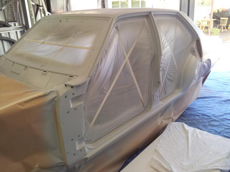

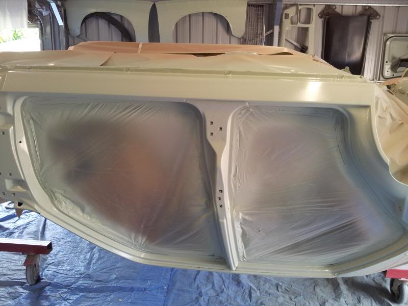

Scuffed the apertures and tapped her up ready for high build primer.
Gave her a 4 shot of primer
Nice and straight again

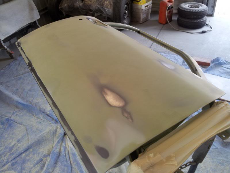

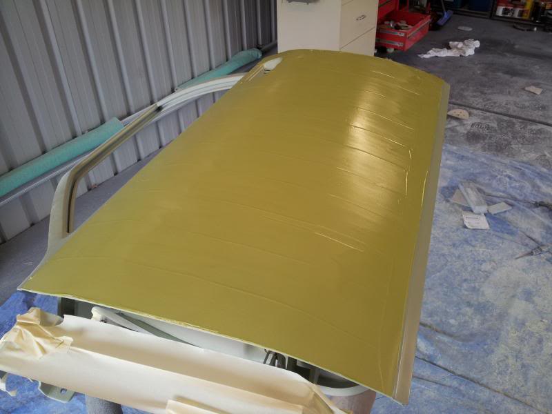

Skimmed the boot lid....thanks to lousy sand blasting that caused ripples in the skin
Refaced and ready to block flat

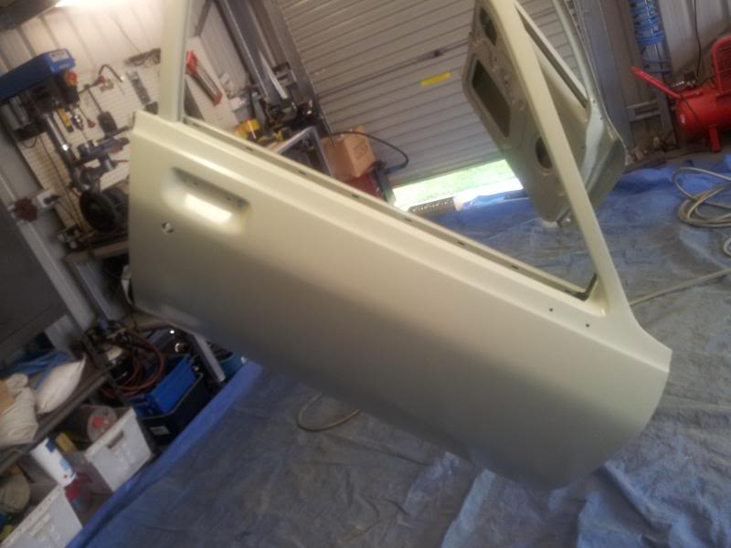

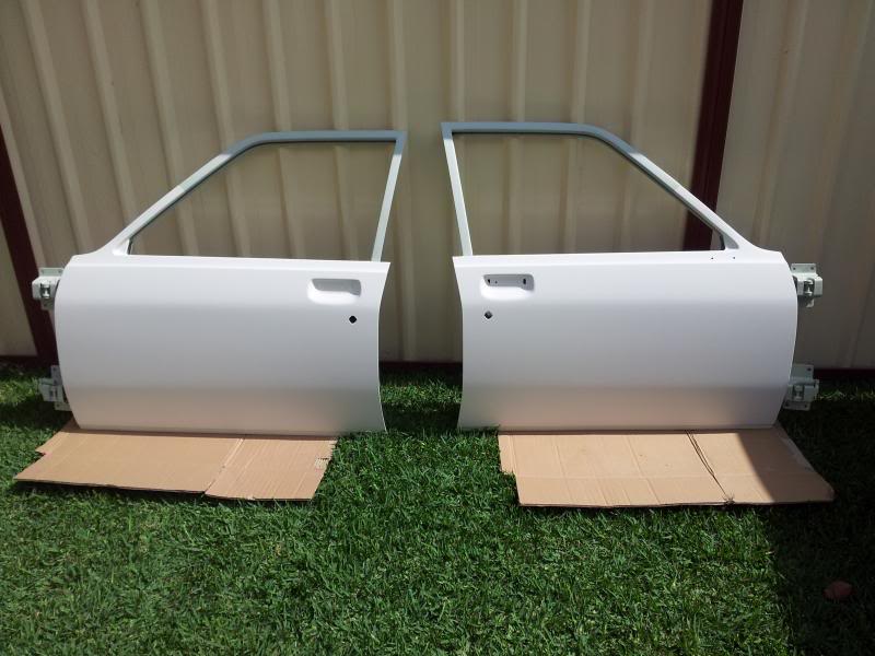

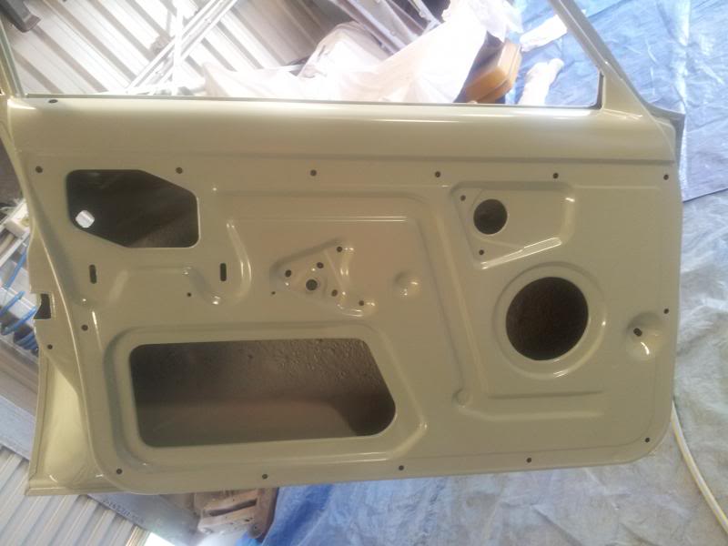

Skim coated the doors....blocked flat and refaced
The spray filled doors are looking very good.....ready to block for Hi build primer
So thats where im up to with the body work.
As of tonight I have bolted all the doors back on and set the gaps and swedges so I can start on the alignment of the front guards and nosecone....Its all coming together really well especially since this shell was a rusted hulk when I bought it and has had that many welded repairs done that I thought it would be a lot more work straightening her up.
So far so good and I hope this helps someone on there build.

Gday Scott.....i use Rage Black Gold by evercoat same as rage gold but the aussie version.
For skimming i add a dash of diggers fiber glass resin to help it flow out over large areas and it helps extend the working time of the filler.
You could use evercoats plastic honey filler thinner but its hard to get.
The diggers resin does the same anyway and is cheaper...has a similar styrene content so it works excellent.
After this coat i refine the level with Upol dolphin glaze.....sands really well

Nice work. I like the method of covering the entire panel with filler, you would get a much better result than the way I did it with my race car which was spots here and there. I will do it that way next time.
Good stuff mate,
#42 slar
slar
  • 498 posts
  • Location:Newcastle
  • Joined: 14-September 09
Posted 01 April 2014 - 12:27 PM
Hi Eyepeeler....you get a much flatter surface but its a bit more effort bocking it out.
It looks like a lot of filler however you can basically see through it so theres not much left on the panels.
Some say its the cheats way to do it and for real quality it should be file finished metal but unless you have the know how to file it this is the best wsy by far.
Good luck with your car

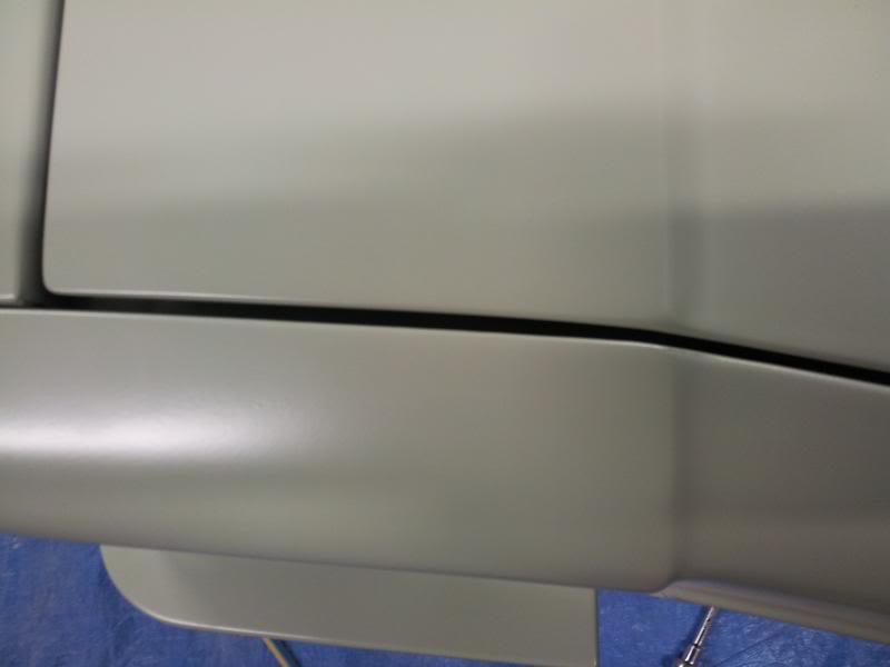

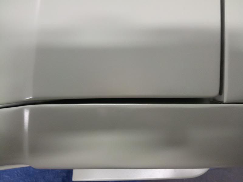

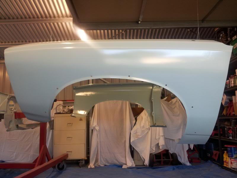

Well finished putting the front panels on tonight..............aligning them ready for a skim coat of filler except the bonnet which is near perfect.
Found a couple of small imperfections with the bonnet gap to nosecone.
Left side looking from front is ok but the right side tapers into a bigger gap......just enough to be noticeable
Left
Right is not as good
But looking not too bad from a distance.......cant wait to finish this off so i can get it painted.
Left the front doors just coated with polyester until I skim the guards......I will profile the front guards to the door profile so I can get a good shape and alignment.
Ok thats it for a few days......should be finished this weekend....cheers
