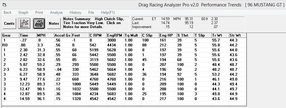

This is a typical formula used by a simple HP calculator.
HP = ( MPH / 233 ) ^ 3 * lbs
This is the formula used by a simple mph calculator.
MPH = ( (HP / lbs ) ^ .333333 ) * 233
This is a typical formula used by a simple ET calculator.
ET = ( ( lbs  / HP) ^ .333333)  * 5.825
They are handy calculations to be used as a rough guide but that's about all it is. Relying on a formula with two variables to accurately predict the performance of a car on a drag strip is rather optimistic.
At the end of the day such a simple formula will only be able to produce a rough guess that is not bad for a NA engine. If you have a forced induction engine then it is going to be even more inaccurate. According to the simple formulas a 600 hp 3.0L turbo engine will perform exactly the same as a 600 hp 8.0L naturally aspirated engine over the 1/4 mile.

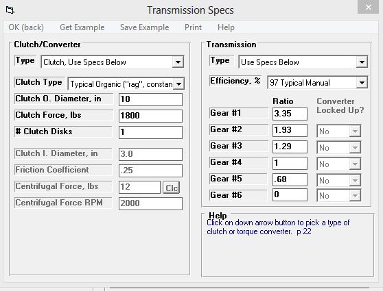

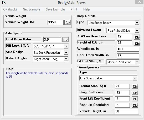

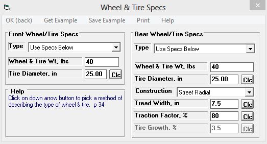

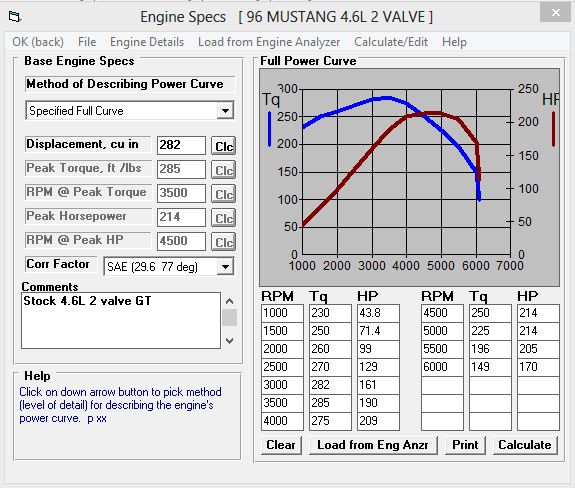

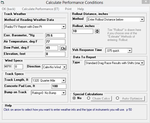

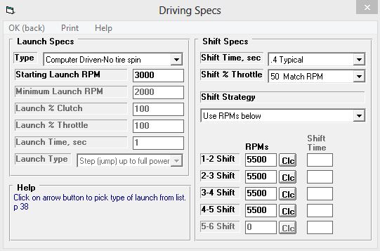

This is what the parameters for a more comprehensive computer model looks like. If you were to input the figures from a dyno run into this sort of computer model then you would expect it to be reasonably accurate.
You can download a free trial from here.
http://performancetr...ag_race_pro.htm

#19 ls2lxhatch
Posted 10 October 2013 - 02:14 AM
I have a Moroso slide rule, 425bhp and 3,130lbs indicates 10.9s ET @ 122mph.
Same power and weight with the above equations from lslxhatch is 11.3s @ 120mph.
I have seen the constant 233 in the formula above vary between 230 and 234. You will probably find a number in that range that lines up the Moroso slide rule. Any answer that is generated by a slide rule or two variable formula should only be considered as a wild guess at best. The peak HP of an engine tells you nothing about the power curve of the engine.
A far more complicated computer model with 100 plus variables like the Drag Race Pro software plus accurate dyno results throughout the rpm range and vehicle weights with driver and fuel is required if you want to get a more accurate idea of a vehicles 1/4 mile potential.
Edited by ls2lxhatch, 10 October 2013 - 02:16 AM.
