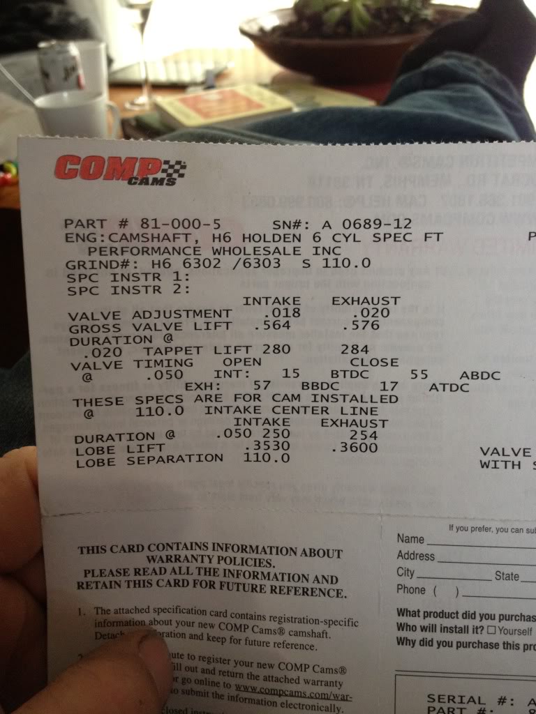

#341 N/A-PWR
Posted 30 August 2014 - 02:10 PM
that's a great Compression Test James,
I have 250 psi using my head and a race cam.
Comp test today came in at 235 psi static
Gave you a Like Button for that

Posted 30 August 2014 - 09:10 PM
Hey James that's lots of comp. Can I make your late reply even more worthwhile & ask what cam spec you have in that beast?
Loved the sound of it.
#343 _Bluejinx202_
_Bluejinx202_
Posted 30 August 2014 - 09:15 PM
Pretty similar to yours I think.

#345 SA EH
SA EH
    Another Holden 6 tragic
  • 1,050 posts
  • Name:Jonesy
  • Location:SA
  • Joined: 14-October 13
Posted 30 August 2014 - 09:37 PM
Yeah that's the one, reckon I saw that cam spec sheet somewhere else.
It says 6cyl though not 5😆
Time for another go....
