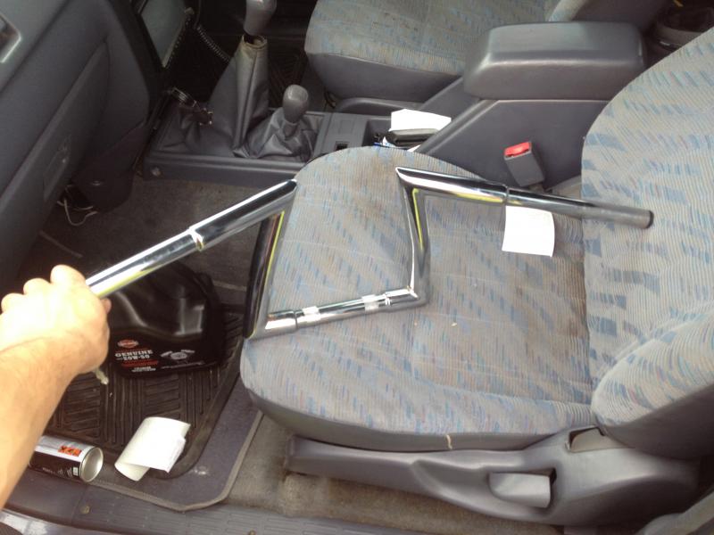

The bars on the bike now are pretty gay, recon the ones pictured would be a fair bit cooler.
Expect epic issues with fitment though lol, cables etc.

Way better choice of bar there...

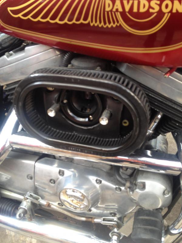

Without a cover it'll suck in the rain but then you just pop on the rain sock. Zip into your local HD dealer and grab the 600 page parts and accessories book. They're free in the dealership or can be downloaded on the line.

Well I don't ride in rain, but then again if I was gonna leave a great big hole in the middle I might as well take the filter off all together as it would be useless. Was hoping I could cover the inner part and leave the filter element exposed. I'll check out the catalogue cheers
You could use this one without the black cover or they do a round version also.

Thats exactly what i have, except my filter doesn't have the internal galvanized plate like you pictured.
