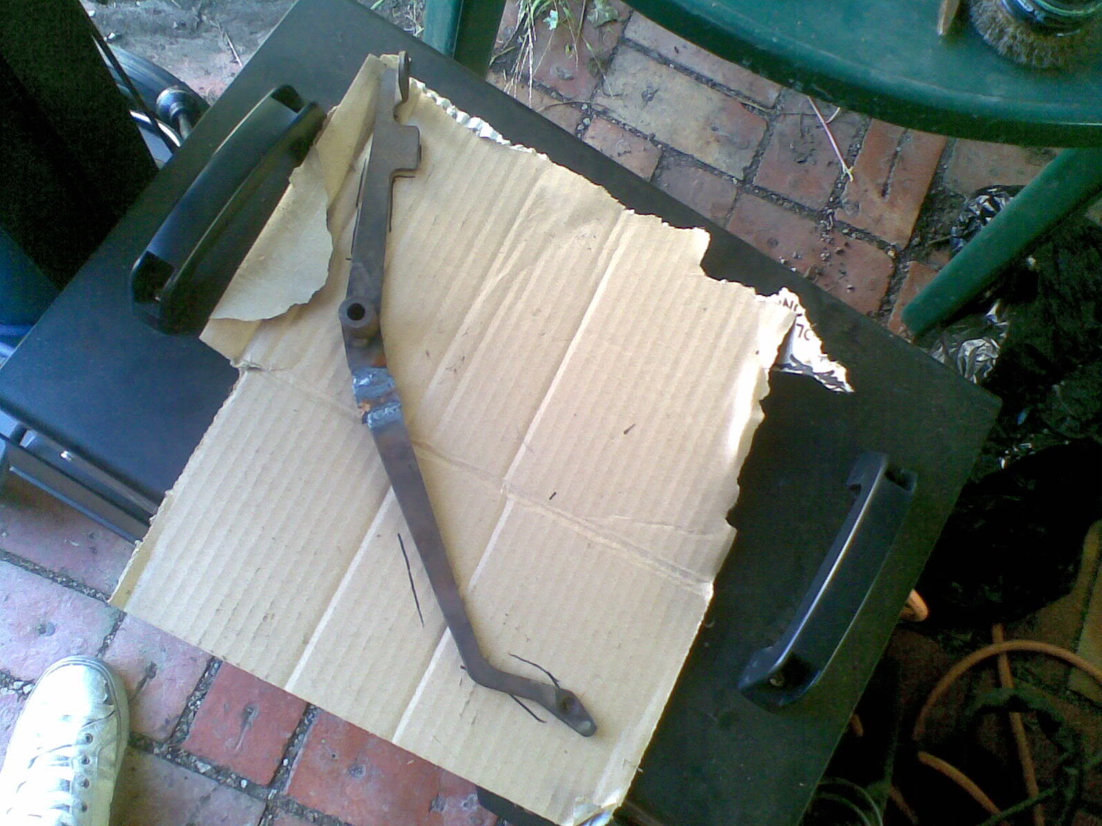

Photos in the car are difficult to get. This thing is twisted towards the driver and a lot closer to the brake pedal. Obviously I cleaned it up the welds and added some bracing on the side too.

Is that because the brake fade meant you had to push it almost to the floor and it lined up better with the throttle ?
