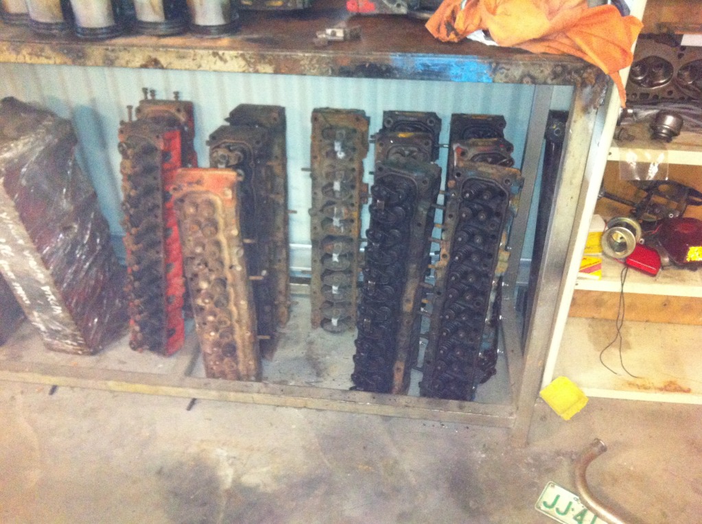

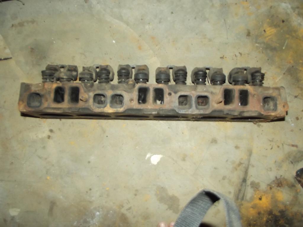

Firstly, a quick shot of part of my collection which i went through to find the different types
97FBFA27-F5B9-4FEC-975D-F674F3D554A4-208
Now, in my mind there are four generations of holden six head, Early Red, Late Red, Blue, then Black EFI.
These in my mind have significant enough changes to warrant a class of there own.

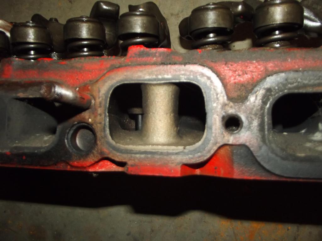

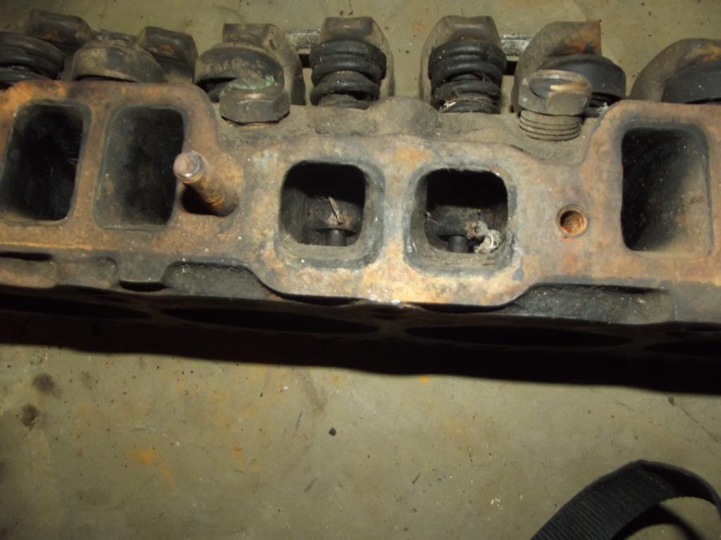

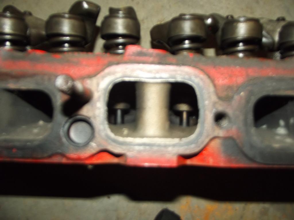

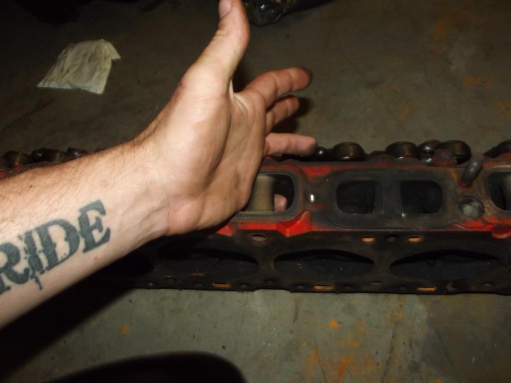

All Reds are of a 9 port configuration. THey had a Siamesed inlet port with a large boss running down the center for the bolt, and individual exhaust ports. 3 inlet ports + 6 Exhaust ports = 9 POrts.
THis is the inlet, including a pick of me fingering the port to show how the big wadd of shit in the middle is just the boss for the head bolt

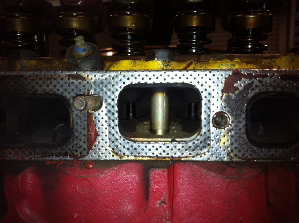

And the exhaust

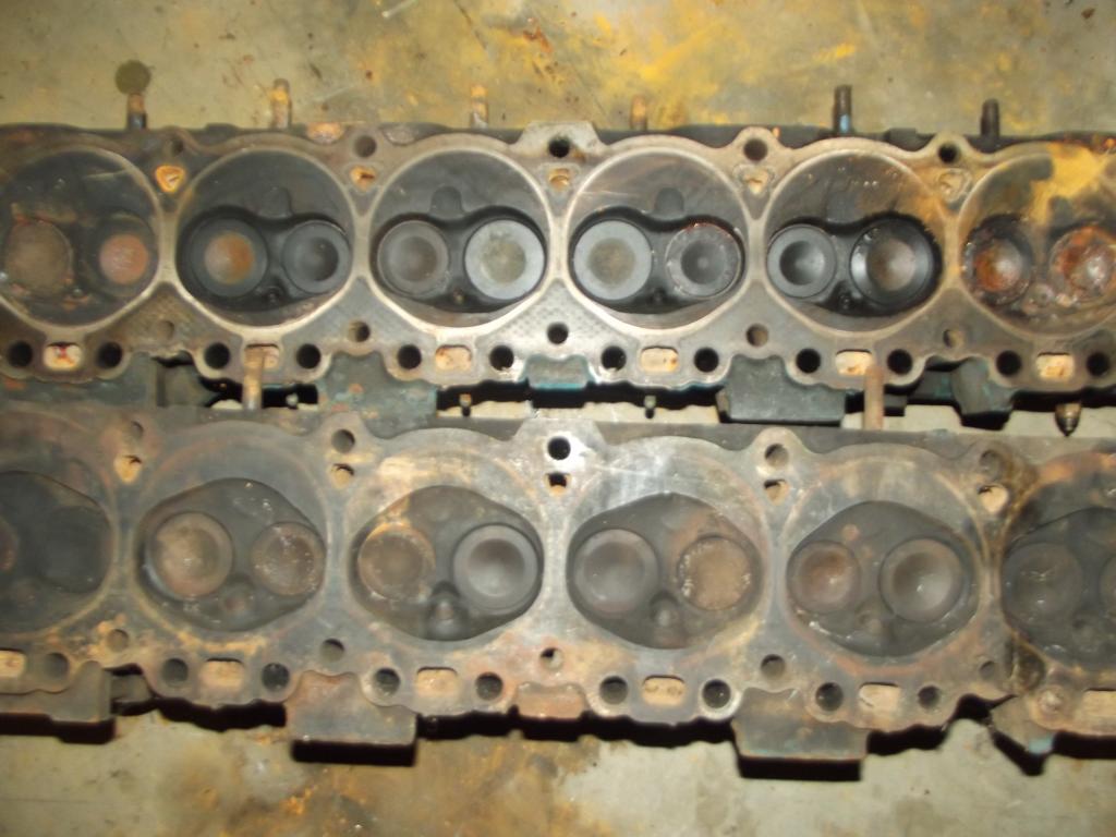

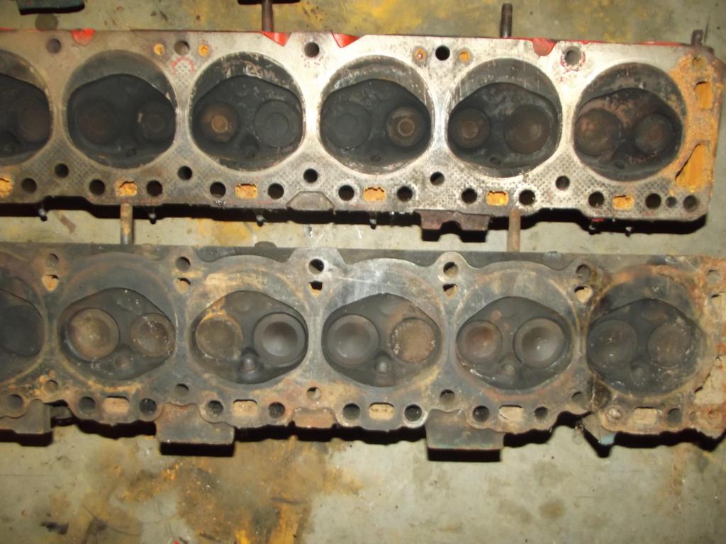

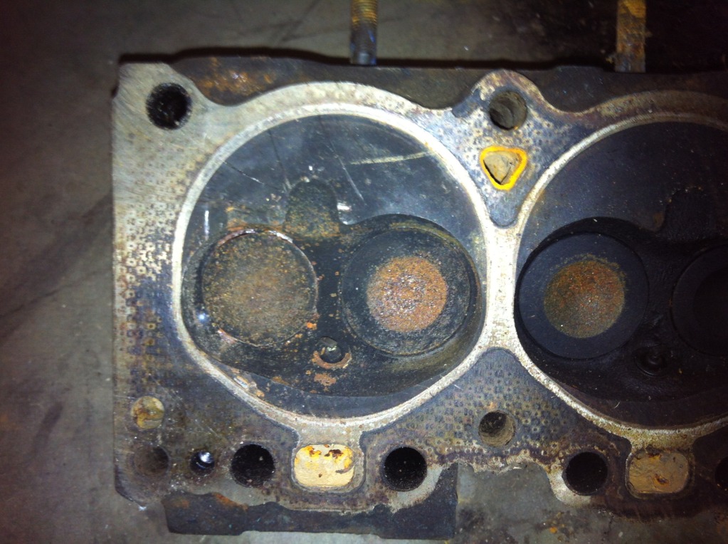

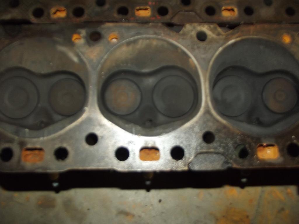

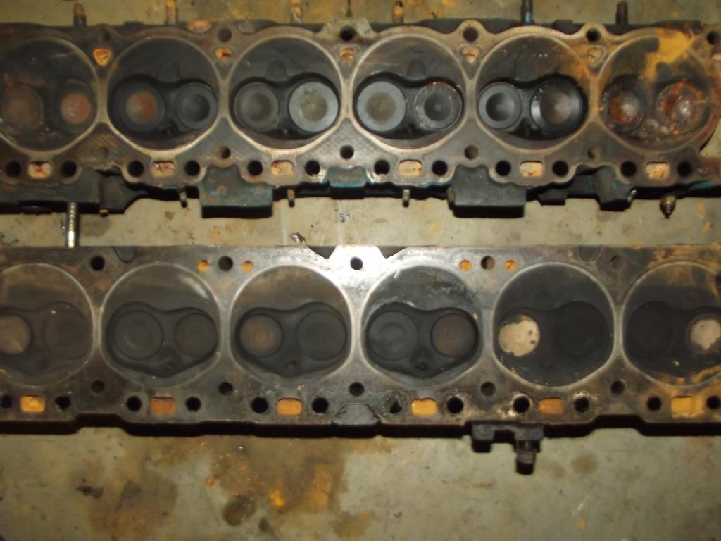

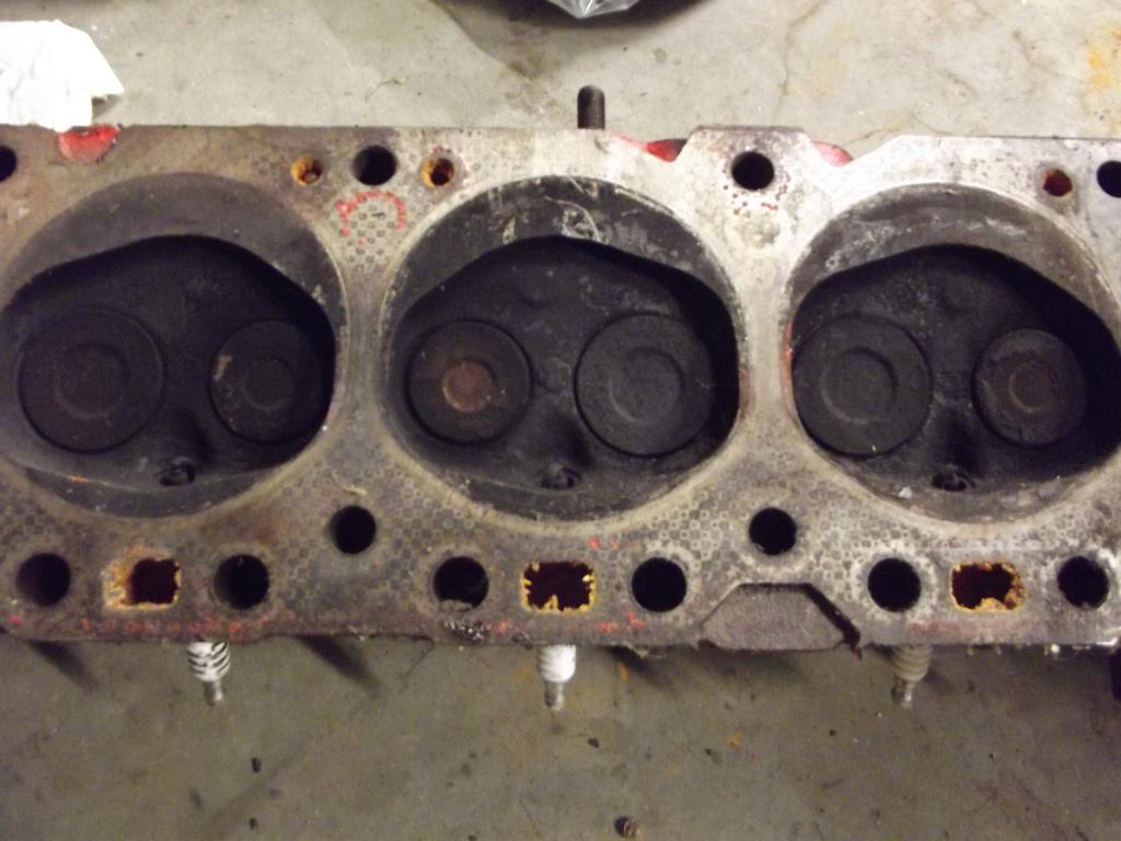

Here are picks of the two different chambers on the 9 port heads.
Low comp
High comp
And both side by side

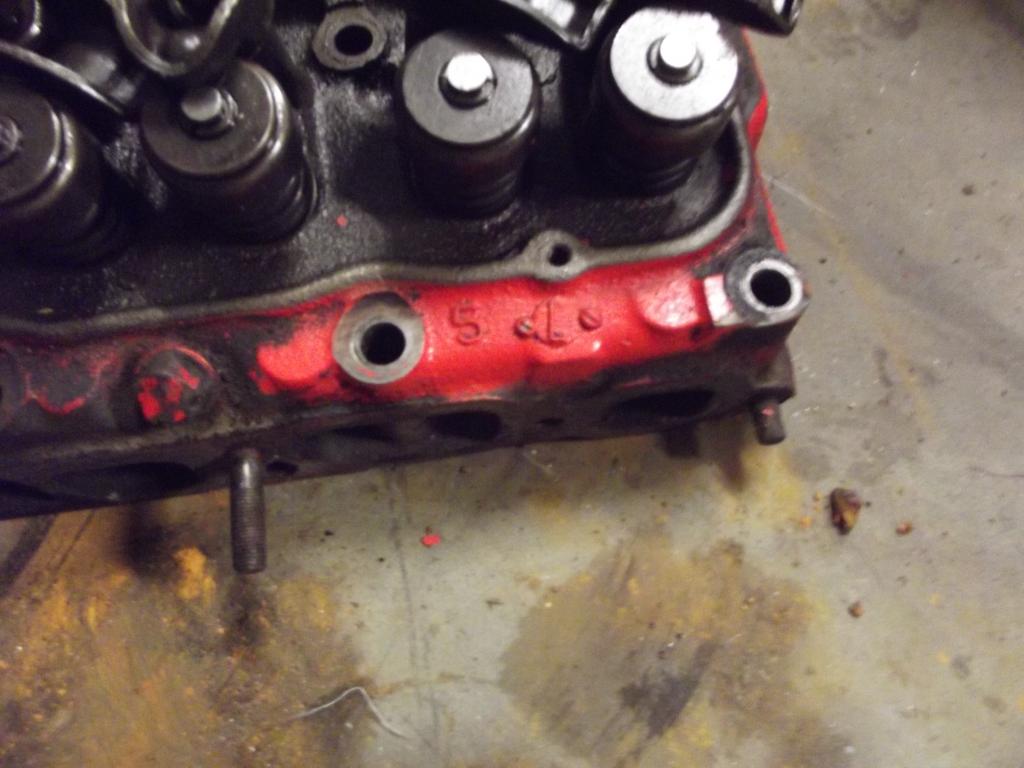

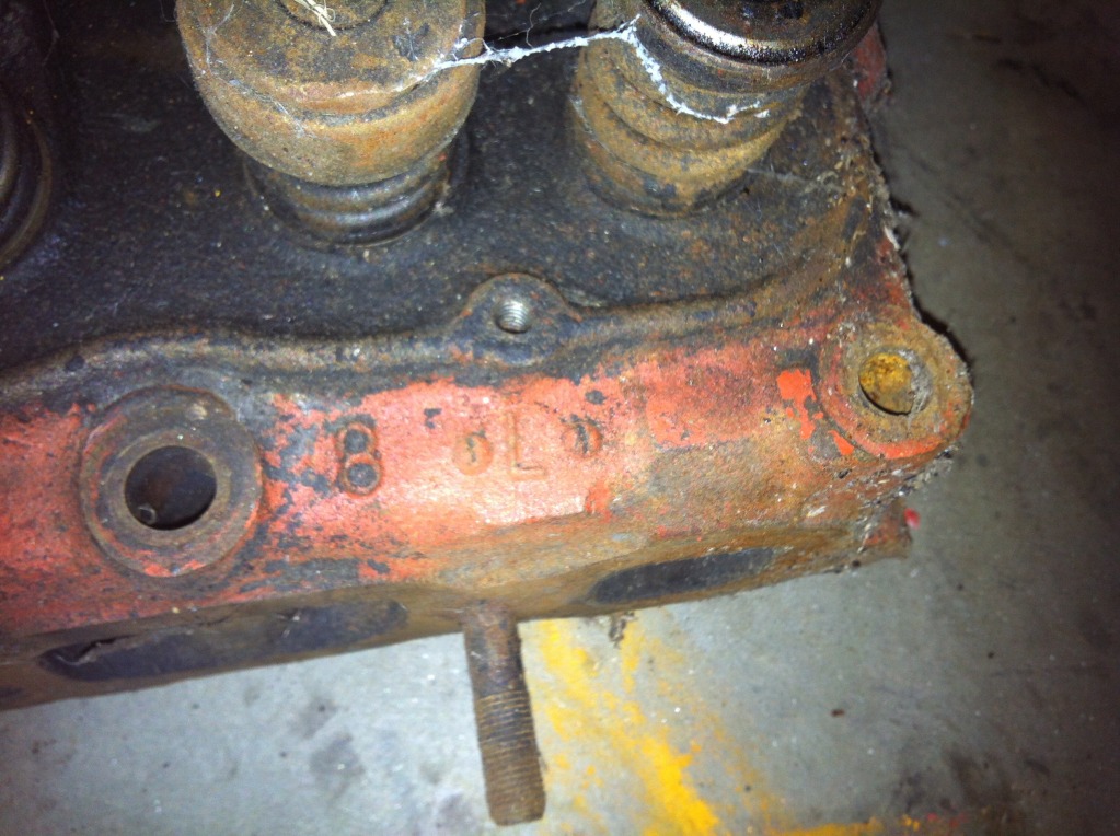

And the location of the "L" or "H" to designate which shaped chambers it has, on 9 ports it is located on the manifold side of the head towards the rear, just between the last exhaust and last inlet port.
THese are low comps:
9FD0ED54-6085-4516-9824-13A3336E1AE6-208
And these are high comp
4522F885-17A6-4549-96E2-EB1B3C37DB23-208
As i mentioned earlyer, i personally split them into two generations, each of which has two basic types, low and high comp. THere were a few minor running variations throught the cycles, but personally i dont think they really warrent mention, and i dont have enough data on them to comment with any authority anyway.

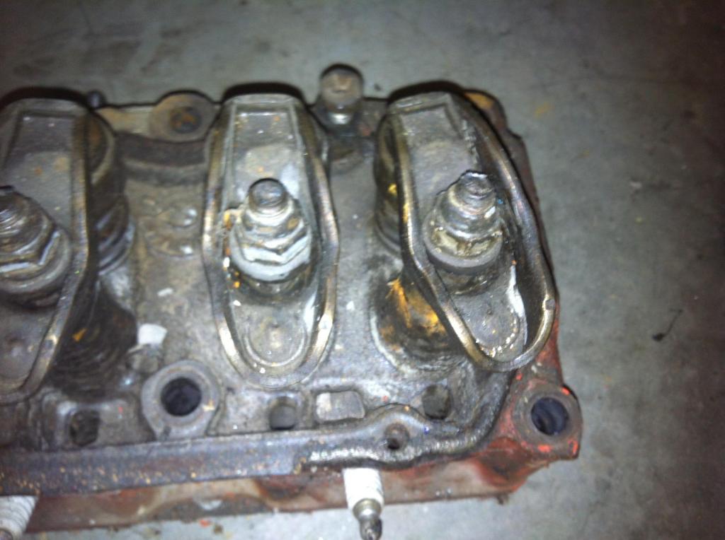

The early ones are identifiable by there adjustable rockers on 3/8" pressed in studs, Square sided pushrod holes, a washer seal spark plug and five extra oil drain holes at the base of the rocker pedestals.
These are the ONLY holden six cylinder head that you can fit stud mount roller rockers to and not have to use guide plates. All of the other heads you MUST use guide plates if going to stud mounted roller rockers, or use shaft mounted roller rockers.
Early red head showing adjustable rocker gear:

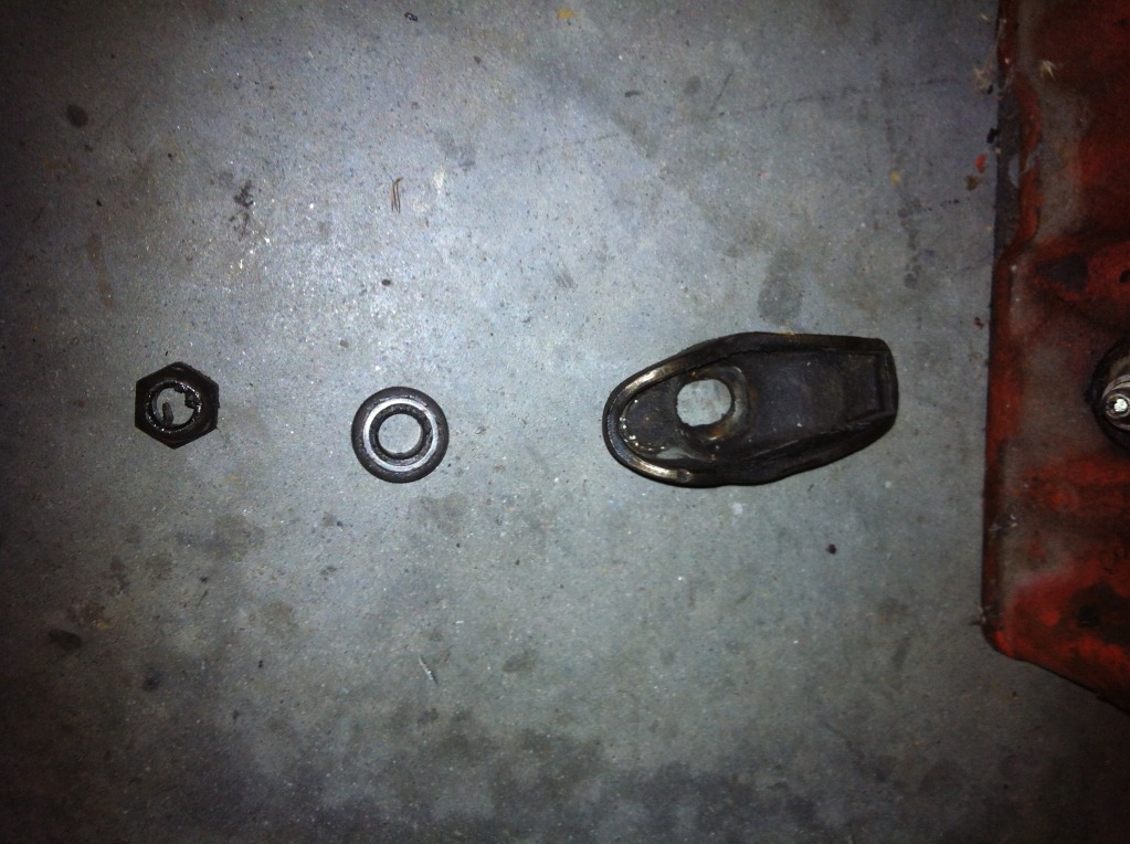

Rocker gear dissassembled showing rocker, round pivot, and nut
804D4379-7276-4938-AA71-B9DDBA182873-208

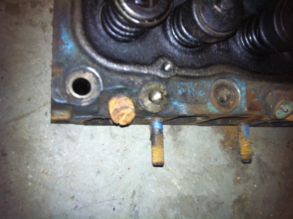

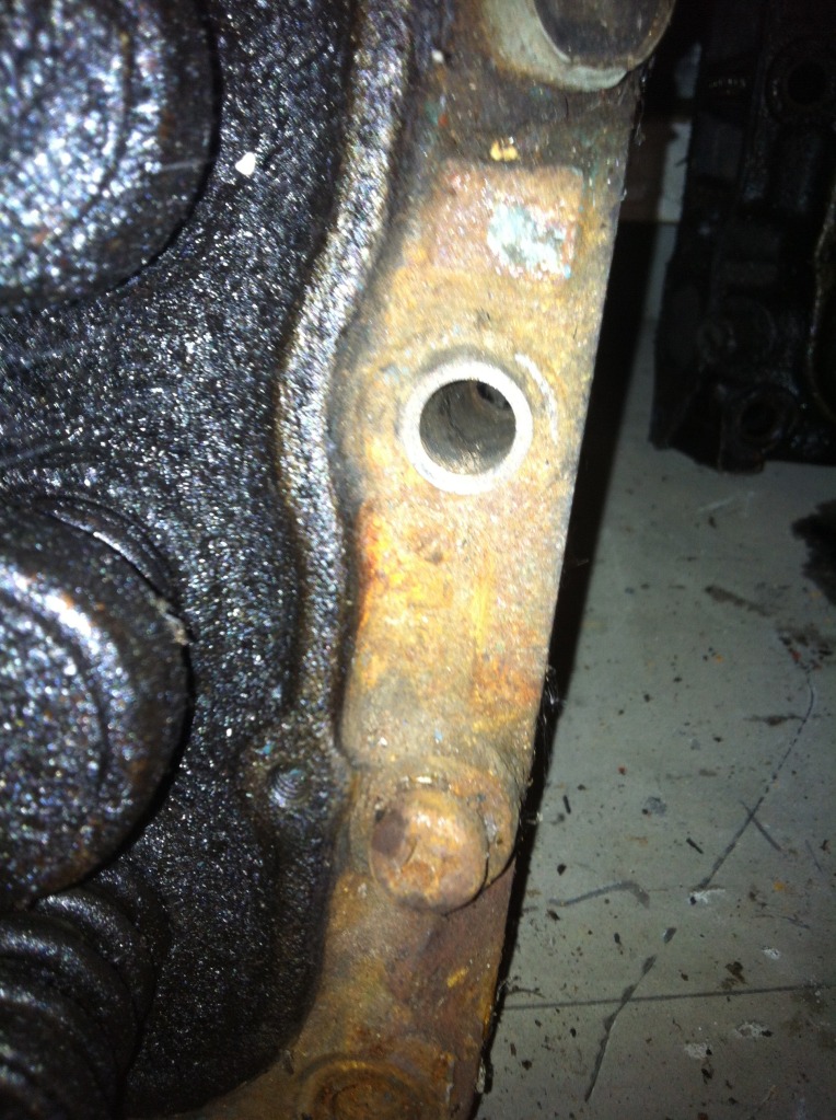

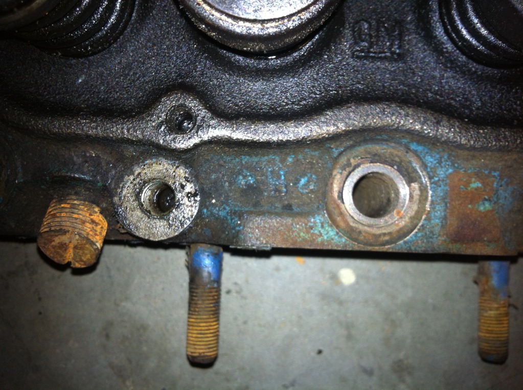

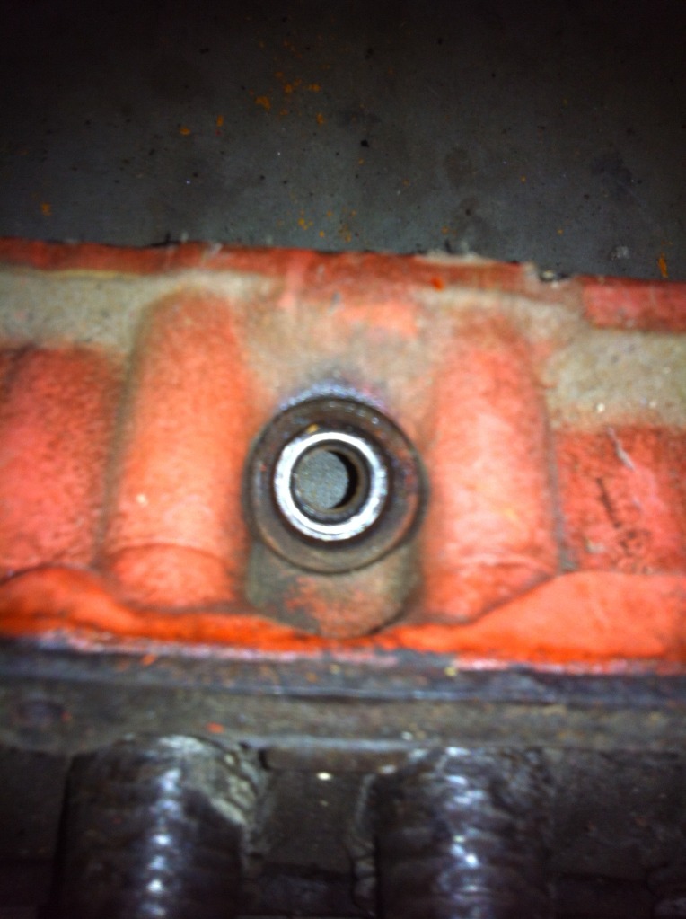

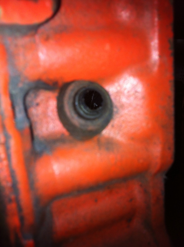

One of the five extra oil drain holes, this is at the base of the rocker pedestal just inboard of the head bolt.
CDC8BB82-4D10-489B-8B3F-EDE7BD4D3C6A-208

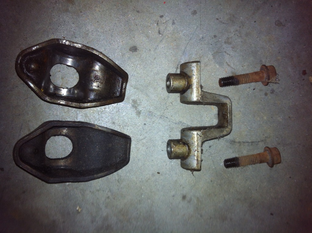

They went to non adjustable bridge mounted rockers with 5/16" bolts, which to the best i can tell remained unchanged for the rest of the lifespan of Holdens greatest engine.
The pushrod hole became a 15/32" round hole, The extra oil drain holes at the base of the rocker pedestal were deleted, and they went to a taper seal spark plug.

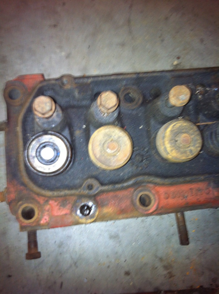

Round pushrod holes, bolts instead of studs.
378B1600-5D8C-4F3D-844C-6FB721B1B09F-208

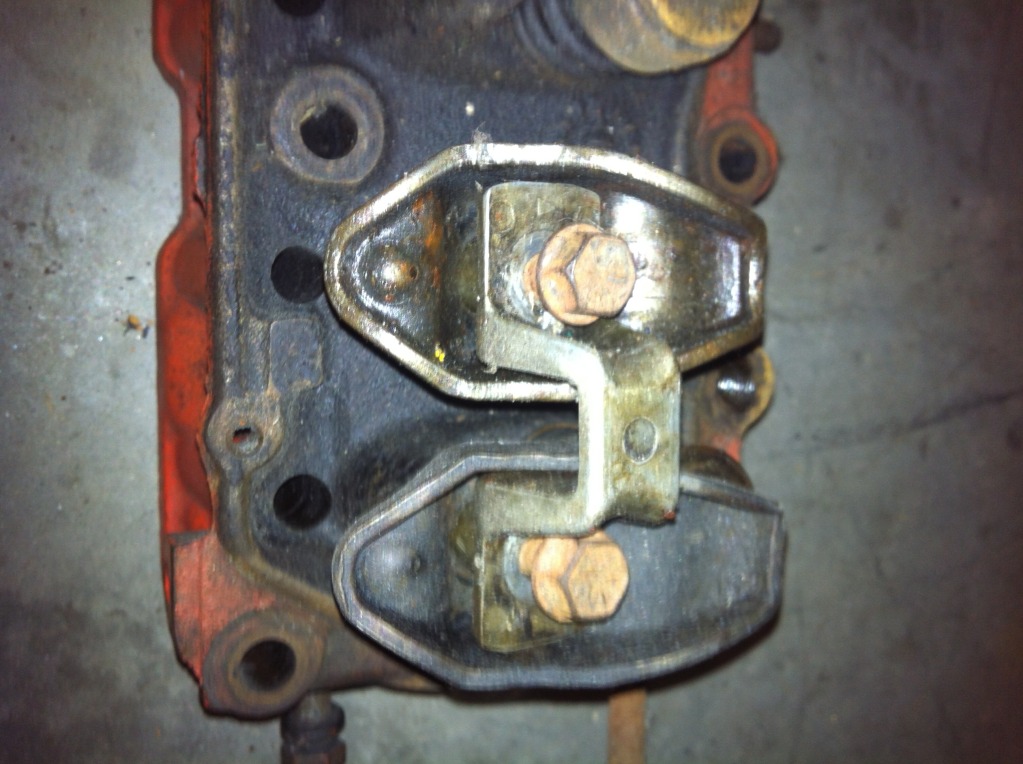

Bridge type rocker gear dissassembled. Note the square pivot of the bridge, which stops the rockers rotating sideways negating the need for square sided pushrod holes. This is why you MUST USE GUIDE PLATES if you go to stud mounted roller rockers on any of the later heads.
F83E5522-6881-46F5-A606-97FCBDC0E7F7-208
C19FAD39-EC27-4E6F-B42A-03F4499F3DE6-208
Closeup of the bridge assembly as fitted to a cylinder head. Note the two little arrows on the bridge, these face toward the valve upon assembly.

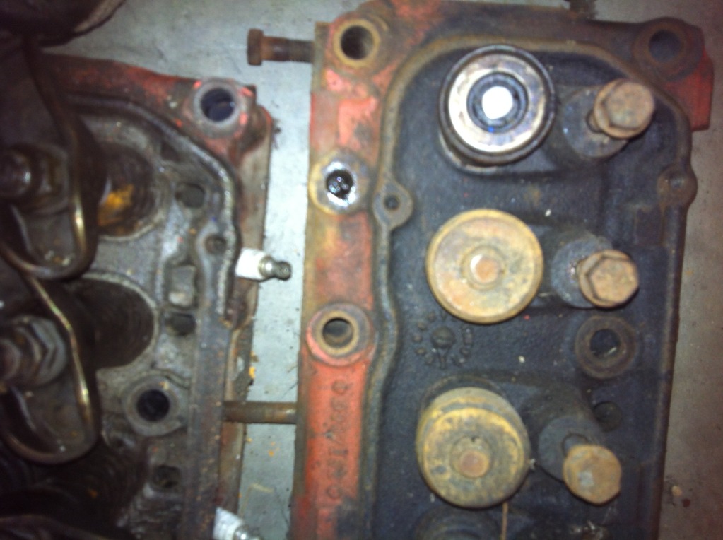

Early and late side by side.
17C8A237-F11D-4BC2-8E31-79345A91A87F-208

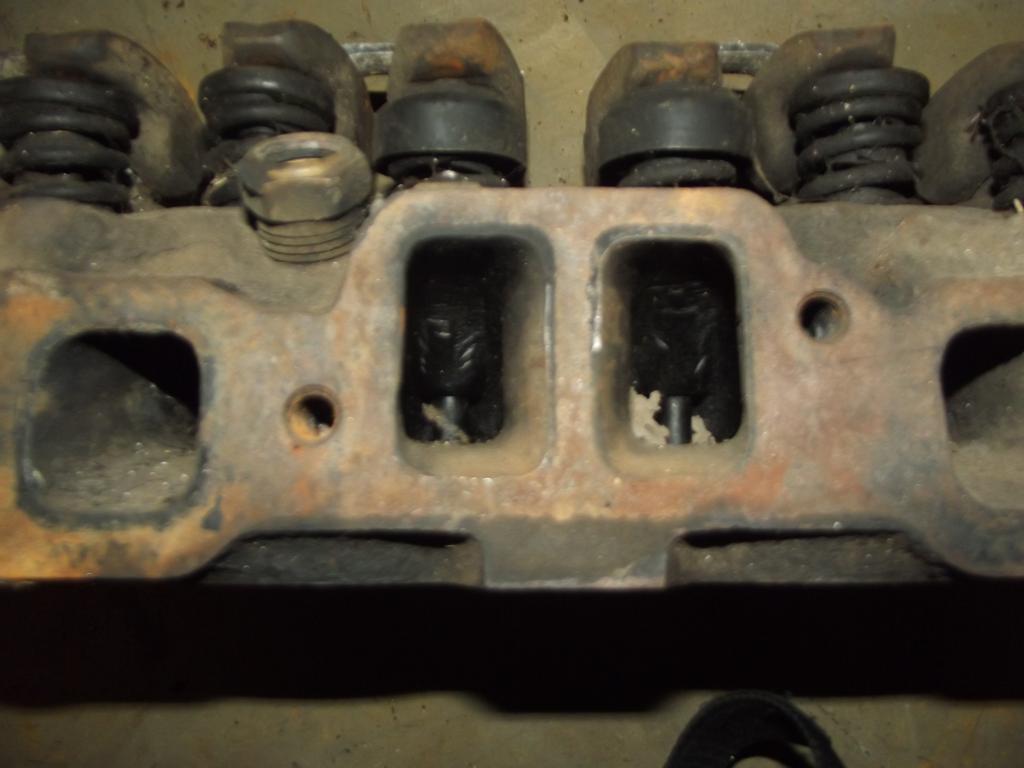

12 port port face
Close up of the inlets
And the exhaust

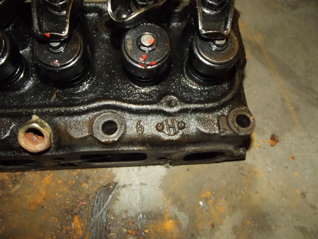

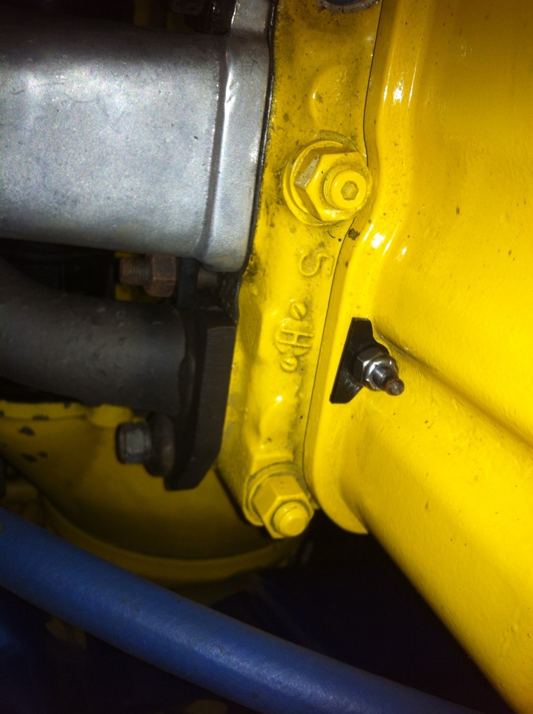

"H" stamp, this is a high comp head. The stamp is located on the manifold side toward the front of the head, directly above #1 inlet port and just infront of the second head bolt from the front...... Followed by a pick of a 12 port high comp chamber
6A512837-918C-4E40-B2A5-73D3EC3BA4E8-208
5C47B7A8-BF86-4ECC-8F95-7A9551C8F626-208
04BF3B4B-025D-47C3-B753-8738825CBFC1-208
And "L" stamp, same spot. Hard to see, its much smaller than the reds. Followed by the chamber.
7EE10CA1-A781-4231-9F70-5B51E2E765CA-208

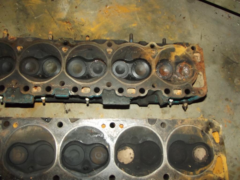

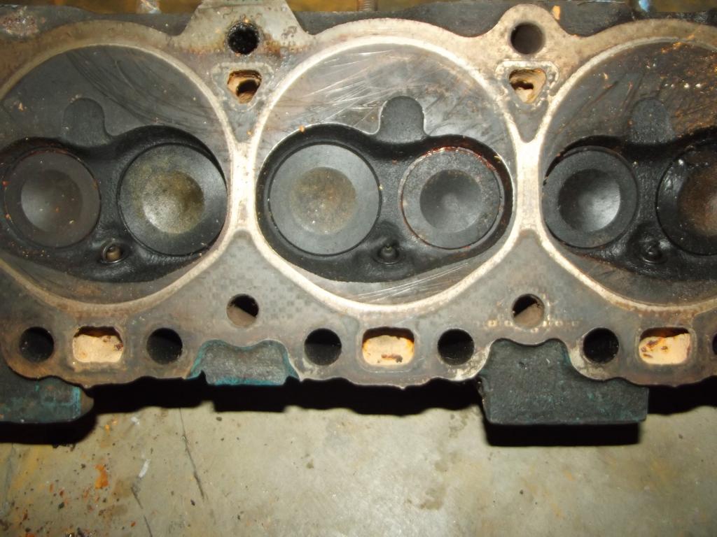

12 port high and low chambers side by side.
12 port low chamber below red motor low chamber.
And 12 port high comp chamber beside 9 port high comp chamber
Note in the last picks the different water galleys in the heads. THe 12 port head has triange shaped holes just inboard of the head bolts on the spark plug side of the head, the 9 port does not, but does have two holes outboard of the head bolt hole.

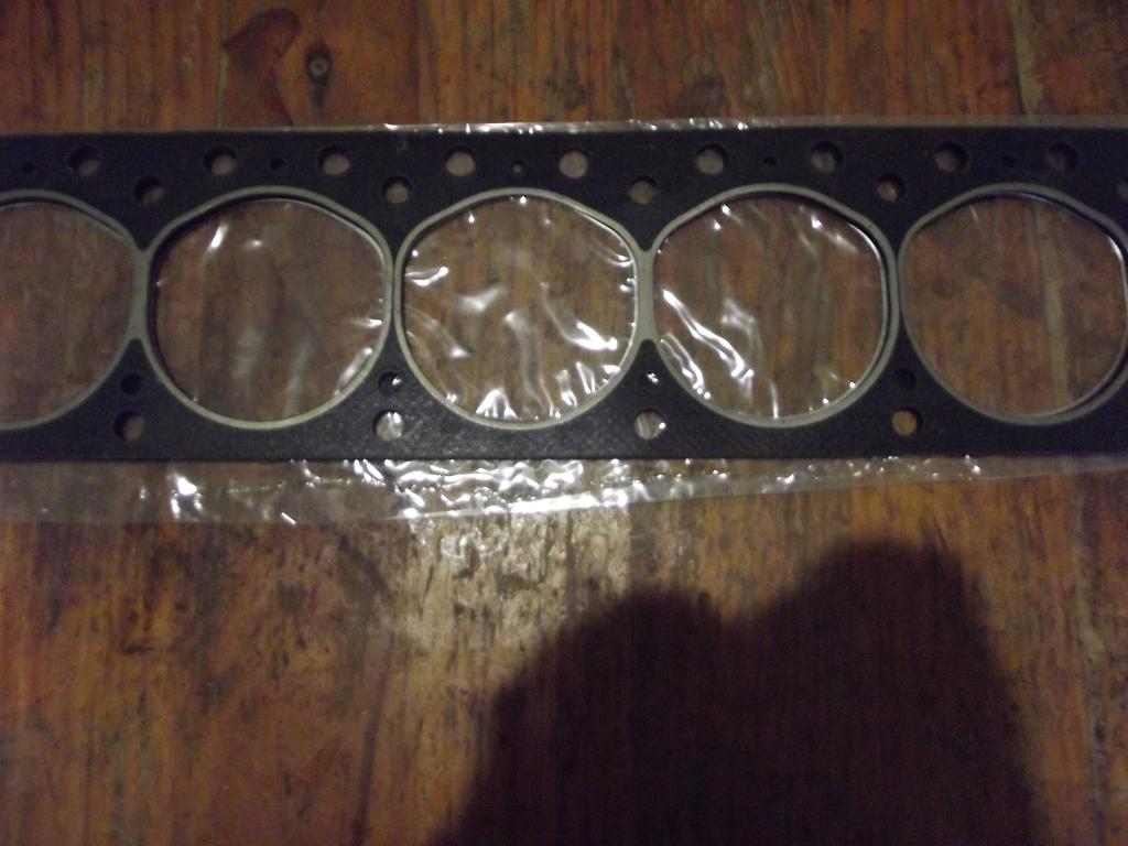

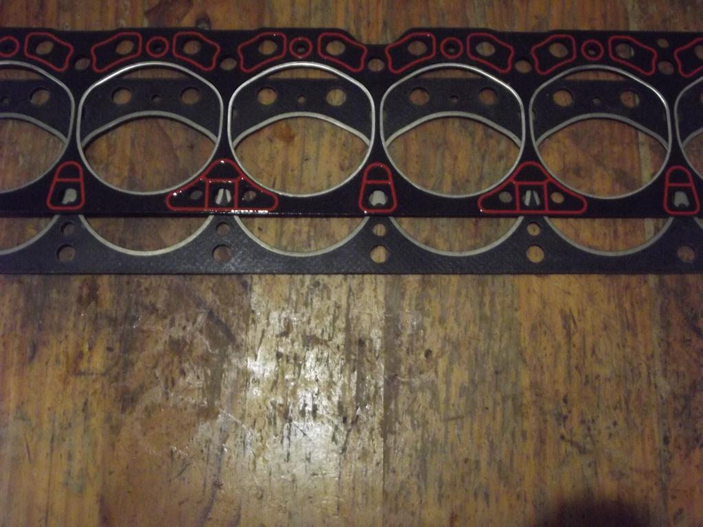

Here we have the blue motor head gasket sitting attop of the red motor head gasket.
The picture doesnt seem to show them up properly, but not the holes between 2-3 and 4-5.
These dissimilarity's are all on the manifold side, and i will get back to them in a sec, but i noticed one on the pushrod side which i was not previously aware of whilst doing this comparo.
Thats between 5 and 6, and i'd never noticed it before.

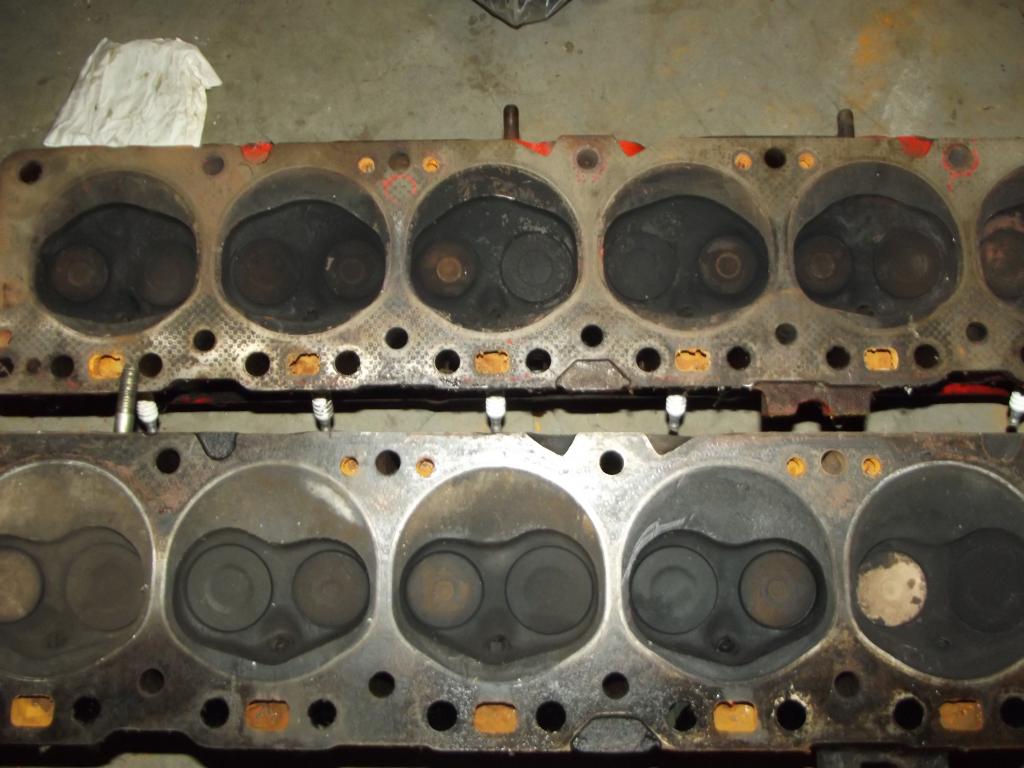

Now moving back to the major alterations on the manifold side, some picks with the gaskets offset to give you a clearer view.
Red ontop of Blue.

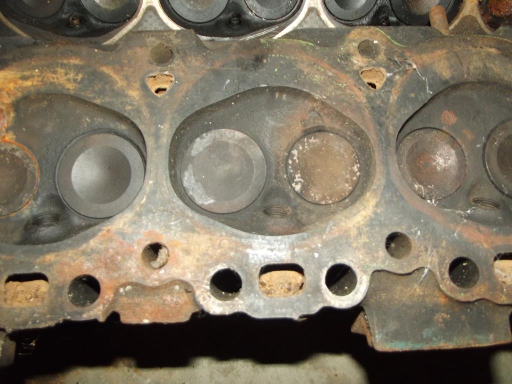

Have a good look between 2-3 and 4-5. There are two ports in each point outwards from the head bolt in each section that do not correspond to the blue motor gsket.
Now note the holes in the blue motor gasket, just inboard from the head bolt holes, between 1-2, 2-3, 3-4, and 4-5.
This is the difference.
A shot of the heads, blue motor has little triangle holes, red has two circular holes.
Also note in the pick that the red head gasket ontop has little sealing swirls to seal up the holes in a 12 port head if you were to fit it to a red motor.
This is a Proform gasket, same as Durapro.
The ACL 12 port gasket i have has no such things, indicating to me again that ACL is over rated rubbish, but thats a different topic.
So basically if you wish to switch from one to the other, Hook into Ripco, Autobahs or Superjunk, or jump onto precision, have a good look at the gaskets they have on offer, and from there choose which side you wish to drill.
You can either drill your block out to suit your head and run a corresponding gasket, or drill the head out to suit the block and run a corresponding gasket.
The best way to go will depend on gasket availabiliy.
If your somewhat excited, you can drill and tap the unused holes to fit grub screws, its probably reccommended but i dont think this is essential.

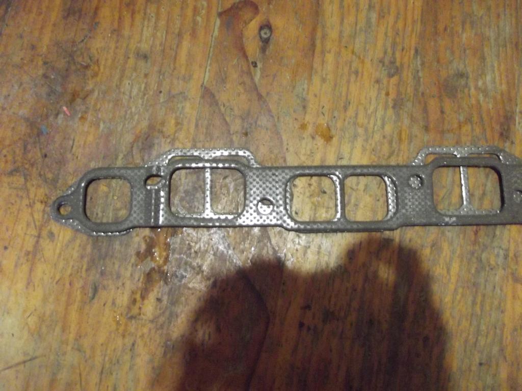

Next we move onto the manifod face, the various differences, why red inlet mani's wont fit blue etc, and why red extractors dont really fit blue.
12 port up the top, 9 port at the bottom.
In that pick you can see the drastic difference in the height of the inlet ports as opposed to the exhaust ports.
Also note the manifold studs, disregarding the two very end holes, 9 port goes "up down up down up down", whereas 12 port goes "up down down up down up"
THis is the first problem you will run into trying to swap between 9 and 12 port manifolds and extractors and the like.
9 port inlet manifolds are pretty well an entire no go, looking at that pick you should be able to see that the 12 port inlets are substantially taller than the 9 port.
Also the exhaust ports of the 12 port are a bit narrower.

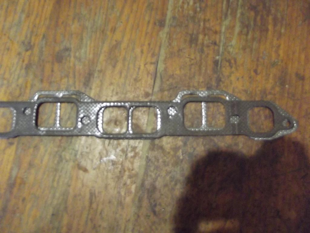

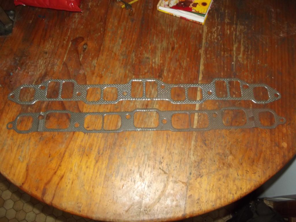

Now heres a few picks of the 9 port gasket layed ontop of the 12 port gasket.
I tried to line it up as well as i could with the #3-4 inlet port in the side to side plane and with the height of the exhaust ports.
You can see somewhat clearly that nothing fits, and its a fair way off.
Your best way if you wish to graft some 9 port extractors to a 12 port is to buy or make a set of 12 port flanges, cut the 9 port flanges off, line everything up the best you can then weld the 12 port flanges on.
As far as inlet manifolds go, IMO dont even bother.

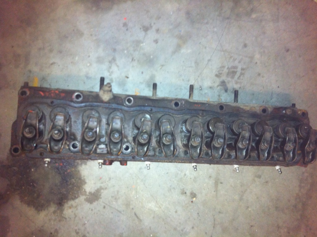

#3 N/A-PWR
Posted 25 December 2013 - 10:51 AM
So thank's to you DJ,

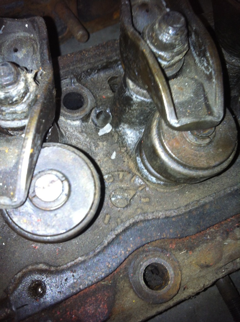

I have an Early Red ( slots ) and had adjustable 3/8 studs put in:-
Attached File  IMG_4426.JPG   40.97K   22 downloads
also this is a Stage 5 Port:-
Attached File  IMG_4427.JPG   32.83K   27 downloads
