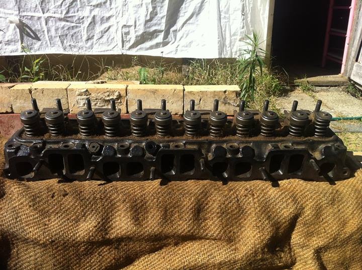

so any idea what one with the flat blank section but still has a lump in the port is from?

#55 rodomo
Posted 28 December 2013 - 09:52 PM
Black EFI I'm tippin'
#56 _Bomber Watson_
Posted 28 December 2013 - 09:59 PM
Stinga
I was only speaking of 12 ports.
Have a look at stevemc's top pic. There is a flat blank section above the exhaust ports. On the non-EFI heads this would have a threaded hole leading into the port. The lump below it, inside the port is quite pronounced. The EFI head exhaust ports have a smooth roof.
I find this interesting.
I have a couple of 12 ports here that TMK are blue motor heads but they also dont have the boses drilled out.
The bosses are there, but not drilled.
I also have a few more that are drilled but bunged, the one i took picks of in the third post in this thread is actually such a beast.
Can anyone confirm this before my restructure or will we leave this one in the open for now?
#57 _barana_
_barana_
Posted 28 December 2013 - 10:08 PM
yes I understand the efi heads have the lump but no hole (from distant memory, could be wrong)

#58 S pack
Posted 28 December 2013 - 10:11 PM
DJ, I don't know much about the different 12 port heads however I can state that I know of a WB blue 3.3 and a VH blue 3.3 both were manual and both had their original heads and the bosses were not drilled.

#60 _Bomber Watson_
Posted 28 December 2013 - 10:16 PM
Right so as i expected its not a black EFI only thing.

#62 _Lazarus_
_Lazarus_
Posted 28 December 2013 - 11:00 PM
I can't confirm the smooth roof from personal experience but I was researching this subject online earlier in the year when considering buying a complete motor. I think I did find pics in another forum. Anyway Johnno says he has one there.
He also says some Blue with air pump, some without. Maybe some were bunged and some not ? The Blue one I have came with bungs.
The one Stinga has there is painted black by the looks of it but has lumps in ports.
Curiouser and curiouser.
And how come the two EFI engines I looked at buying were both painted red ? Is that normal ?
#63 _tryhard_
_tryhard_
Posted 28 December 2013 - 11:12 PM
I have a early efi head and the short turn radius have all been done in the factory to give more torque I believe all early efi heads where done on a nother note early blue heads have smaller ports than the later black heads
#64 S pack
Posted 28 December 2013 - 11:39 PM
Just been doing a bit of research on the net and found some info that suggests the Air Injection was only fitted to the EST engines.
Also found some pics of supposed original EFI engines/heads with exhaust port bosses drilled and factory plugs fitted and another purported original EFI head with bosses untouched.

#70 stevemc32
stevemc32
  • 324 posts
  • Name:Steve
  • Car:LJ 4 Door
  • Joined: 14-September 12
Posted 29 December 2013 - 08:54 AM
Still can't offer any insights but only observations of the head I have on hand.  It's dated 29H5 which I believe puts it squarely into the VK production and does not have the air injection bosses drilled so I'm assuming it is an EFI head.  I did remove it from an EFI black block (VK prefix) and it was fitted with all EFI gear so the chances are pretty good.
Attached File  1dscn2058.jpg   142.22K   11 downloads
Temp gauge sender is at the back of the head on the right hand side, not sure if this is the same with all 12 port heads.
Attached File  1dscn2060.jpg   146.99K   13 downloads
Large combustion chamber with inlet size 41.3mm and exhaust size 35.8mm.  Exhaust valves have an "S" marking.
Attached File  1dscn2063.jpg   147.32K   13 downloads
The air injection bosses definitely still exist inside the exhaust ports.
Attached File  1dscn2066.jpg   148.07K   13 downloads
Ancillary mounting points on the right hand side, from the front air-con compressor, second back is coil and third mount is aux air valve and fuel dampener.
Edited by stevemc32, 29 December 2013 - 08:54 AM.
#71 S pack
Posted 29 December 2013 - 09:02 AM
I read that the 'S' on the exhaust valve denotes 'Sodium' filled. Apparently only used in the EFI heads.
