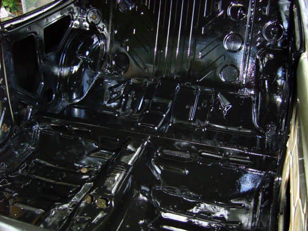

Posted 29 December 2007 - 10:24 PM
Hi just por 15 my whole inside inner guards engine bay etc. I have never used Por 15 before but am happy with the results. Thought i would send a picture of my floor. This stuff should protect her. Used Metal Ready product first before applying Por 15. Not a cheap product but quality product. Well we will see in 10 years LOL
Michelle
