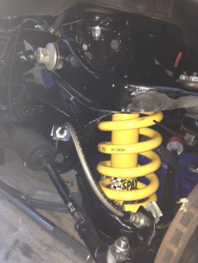

Hey Grant, you do realise your front suspension doesn't have any compression bump stops???
#352 S pack
Posted 31 January 2016 - 09:44 PM
Remember that odd UCA that had the platform on the top, the 1969 - March 1970 LC UCA. Well, hate to say mate but  looks like it wasn't the wrong UCA for your crossmember. You appear to have the rest of the 1969 - March 1970 crossmember that goes with it.
Edited by S pack, 31 January 2016 - 09:45 PM.
