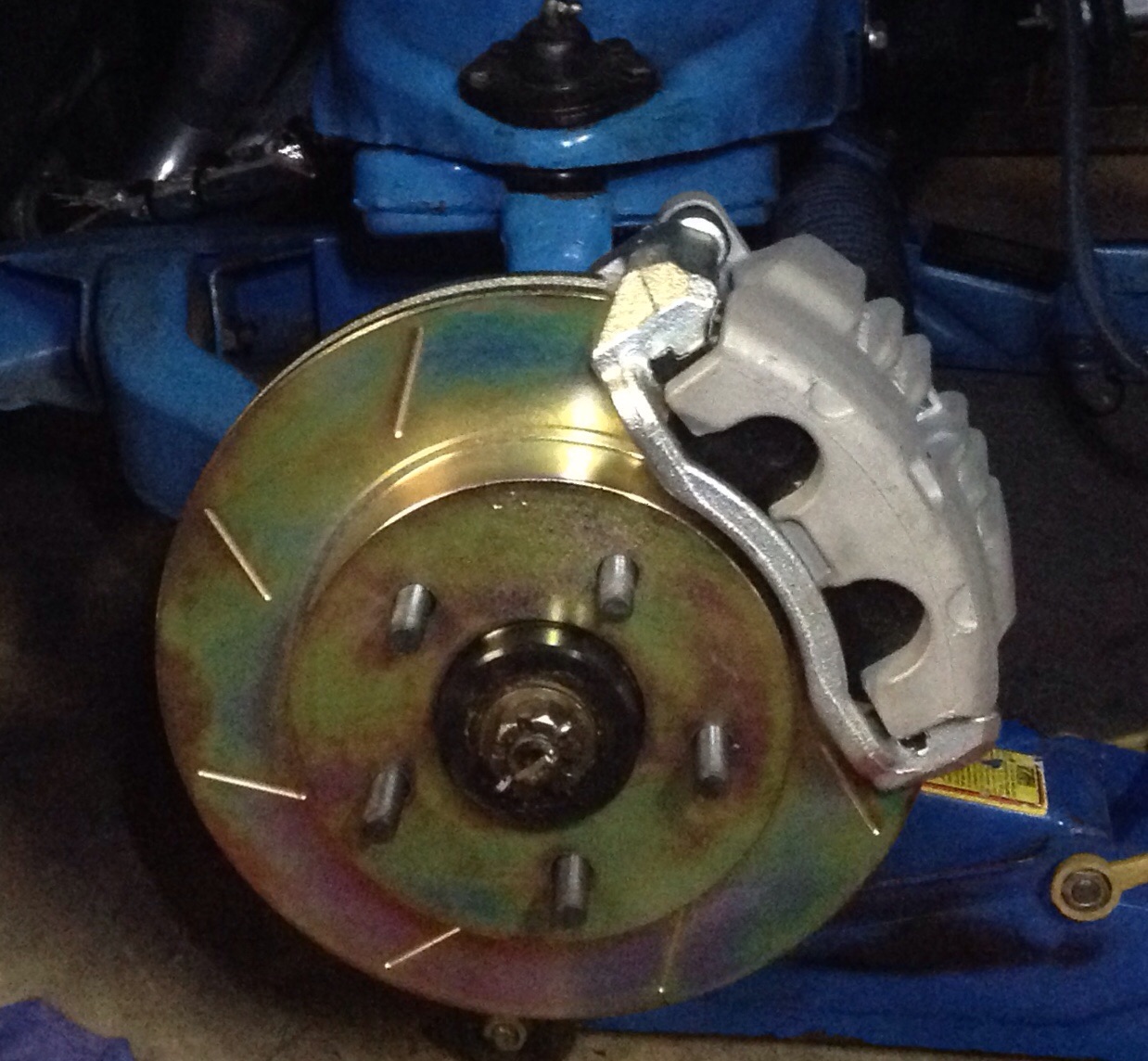

Having spent some time in the car now it's clear these perform better than the old setup. I am also very pleasantly surprised by how much better the handling is with the Torana stubs back in the car.

Now it's time to install the new provided brake line. Make sure you use the provided copper washers. One goes between the head of the bolt and the line, The other between the line and the caliper body.
Undo the line from the old caliper where it joins the hard line in the upper inner wheel arch.
Very quickly attach the new line as the brake fluid attempts to escape.
I found the system gravity bled itself quite nicely.
Top up brake fluid.
Reinstall wheel. You will need new wheel nuts unless your old setup had half inch studs (std holden is 7/16). These cost me $20.
Check you have a brake pedal.
Trundle around the block to test.
Recheck on return for brake fluid level, leaks and check bolt tightness.
