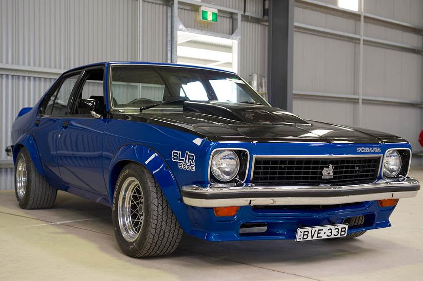

( The goal...)
The base.
1977 LX Torana Sedan S
( now running a 253 )

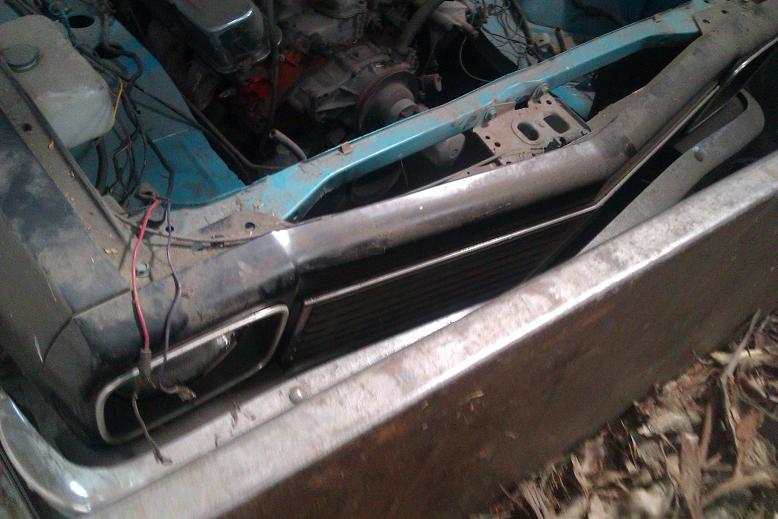

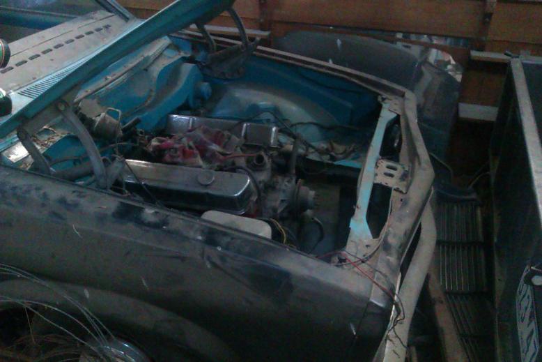

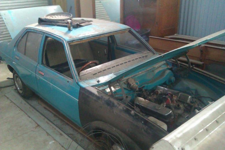

Car not mated to engine, just plonked in, am told.
Firsts things first, to see if she runs. (Massively goodness willing... she does.*)
*is there an emoticon for fingers crossed!
