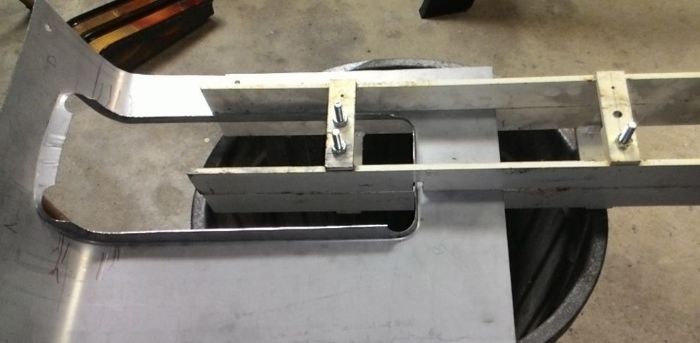

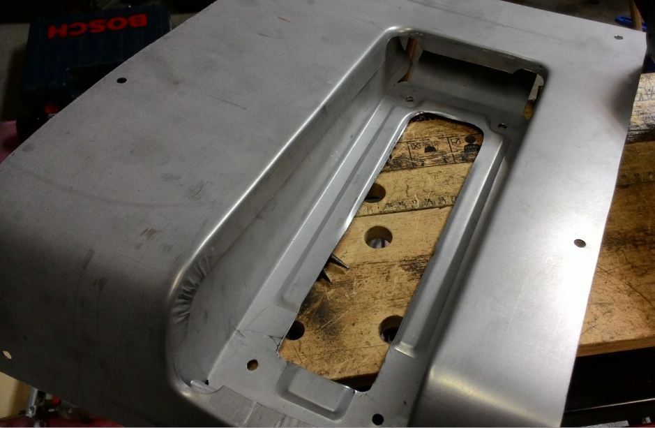

Hi everyone,
                     Late last year I asked for some feedback on whether people would be interested in LH and LX tail-light buckets as they seem to be an area that always rusts and is very difficult to get to and try and repair, not to mention some UC owners wanting to swap to LX rear lights. So I have made a series of prototypes of them and have slowly worked through the minor teething problems to get them to resemble the factory made item. Luckily I have a new old stock original to use as a guide but for a relatively small item they are a bit of a bugger to make, which is why not too many others have tried. Looking through old posts today and someone from the Gold Coast (Paul maybe?) hand made a few years ago but it sounds like he got busy with work and hasn't posted on the forum for a while.
                     Well here are a few pics of what I have come up with so far, so let me know your thoughts and where I might be able to make improvements. If people are interested I am looking at selling them for about $120 each but only when I am happy that they are as close to the N.O.S. one as possible.
                     If anyone would like any further info on them either send me a pm or give me a call on 0478 732274.
Cheers,        Grant

Geez very nice work....they look very good indeed....$120 is very reasonable for a part thats impossible to get....i would buy for sure if i needed them...excellent

Well done they look good may need some in about 12 months when rebuild starts.

Looks like a great quality product judging from the photos, and perfect for rust repairs.
My question is if you are doing a UC-LX conversion, just having the 'bucket' piece doesn't completely get you out of trouble. I imagine you'd still have to be a bit of a skilled sheety to construct a nice 'turn' on your sheet metal to meet the bucket, wouldn't you?

Your right, the tail light bucket is only part of the job to convert a UC to a LX. The bucket sits up against the inner part of the rear panel while the edge of the rear panel is folded in to form a flange and that overlap is spot welded (see the photo below). The hard part is making the opening in the quarter panel for the side of the blinker. At the moment I am trying to make a new rear panel as per a NOS one I have, but whatever method you go with it is a lot of work.
From the pictures you have posted it looks like you are doing a great job, and I can only imagine the hours you have spent measuring, cutting, welding and grinding so far. Keep up the good work and I'm sure it will look terrific when completed.
