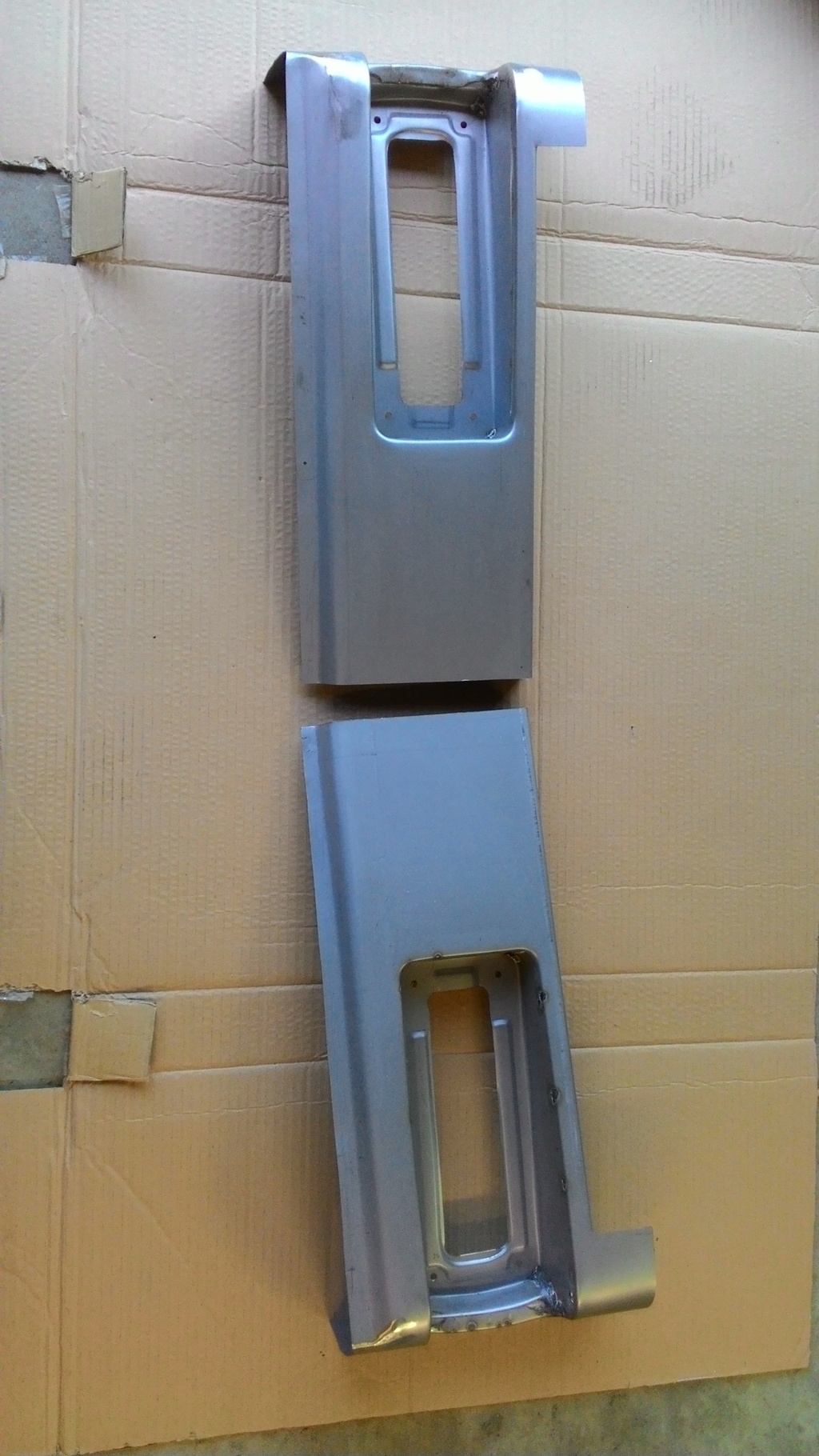

Okay, using the 1mm sheet (0.9) now. These ones are for a hatch.

Nice job Greg! Someone asked me about doing an outer patch section for a UC conversion just the other day. I will have to have a go myself when I get a bit of free time, I hope mine look as neat.

Hi Slippo, yes I think I can do some more, but my lead time is a bit slow.
Thanks Grant. As with most things, they look quite simple, but take quite a ton of time to develop and make.
When I made them from the thinner 0.8 mm metal, I got feedback that grafting onto the rear quarter resulted in shrinkage at the weld, so I'm hoping the thinker metal is better.
Yeah, time is what we all want most, but use the worst. Wow, I kinda like that sayin'.

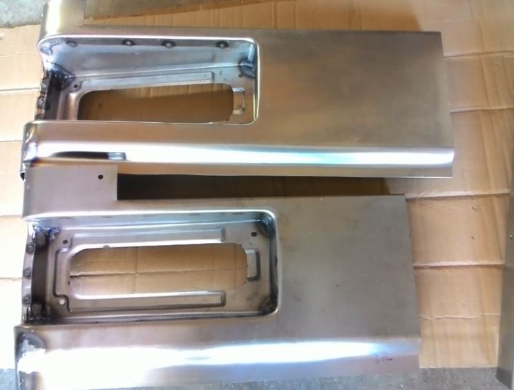

Attached File  Capture.JPG   49.27K   15 downloadsJust a bit of an update, my UC to LX conversion rear buckets and panels have been updated a little. The joint to the rear panel has been extended so the joint can be under the numberplate section. I have sold a few sets already, but no feedback except that they look great. Here are the old and new versions:   Top is a Hatch version, bottom is a sedan.

Looks good mate :)
