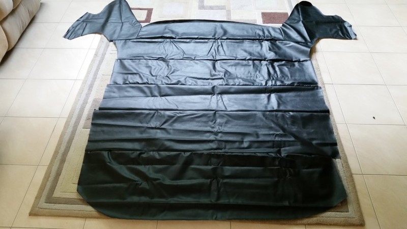

This is what mine looked like when I unpacked it.......this was from Boomfunk......dont worry about the creases
This is what it looks like stretched out......creases gone
You have to stretch it my friend......centralize the calico strips on your roof bows and wire then insert the wire onto the roof support and tap the little triangles over the wire to hold it firmly.
Then stretch front to back first.....use lots of peices of pinch weld to hold it around your window frames......then stretch it from side to side using the same method...try to keep the rear quater section central as you do this.
Once I got mine tight...I contact glued the front and rear to the window frame to firmly hold it in place then moved onto the sides doing the same thing...dont panic about the quaters leave them til last.
Once its tight start to work the quater sections little by little until you you pull them into shape.
Heres a little tip use a hair dry to warm the lining as you go...helps it stretch slightly.
Another tip when its all glued in and relatively tight....i used a paint stripper gun on LOW to tighten sections as the heat from this will shrink the lining and pull all the creases and wrinkes out....BUT BE CAREFULL with this method.....too long in one spot and you'll stuff it completely.
Had it done in about 6 hours no worries.
Cheers Al

that looks 100% ^^ - its perfect, but it also take some no how and the way people go about it
well done to you Al

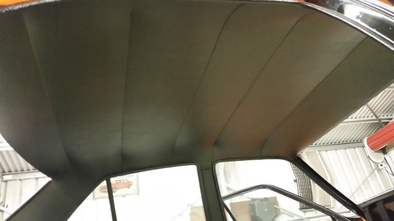

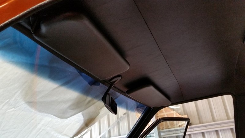

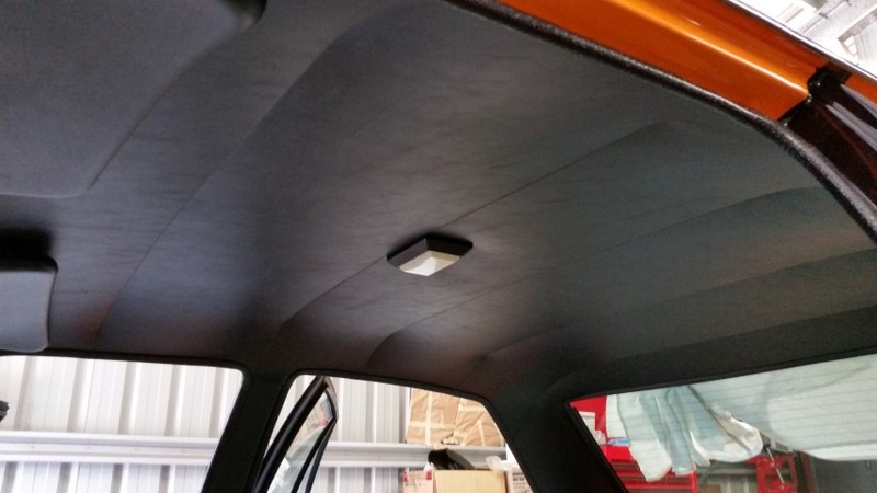

Im just going to dump a heap of pics I took of my install, completed images appear to be first I think, the last few look like it was still being fitted. Supplied by Boomfunk. Boomfunk also supplied templates for the dog leg and door tops and b pillar, I had my trimmer make these out of the Chamois vinyl that I supplied.
