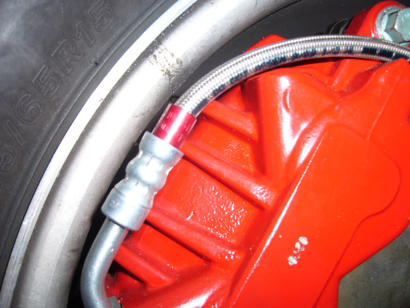

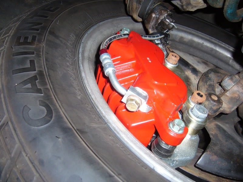

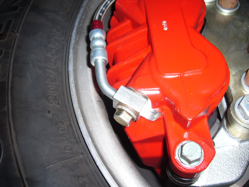

#81 _76S.L.R_
_76S.L.R_
Posted 03 September 2012 - 10:42 AM
Hey guys, I was thinking about purchasing one of these kits because I haven't really come across any negative feedback and it looks relatively hassle free. Just wondering if anyone can confirm whether a set of convos will go over the 290 kit? I read on another thread which I now can't seem to find again that they probably wouldn't fit but just wondering if anyone knows for sure as the 15"+ seems more of a guide than a definite due to the obvious differences in wheels.
Hope I can help?, I went through hell trying to find out what wheels would fit and in the end had to go drive about and measure the inside wheel wells myself with a tape measure to see what wheels would fit!!.
I measured up the inside wheel well area of 15" CONVO PRO and I got a measurement of 340mm.
The overall dimension of the 290mm Hoppers kit comes in at 360mm overall so I believe they wont fit on Convo's , in the end I went with 15" Weld Draglites.
290mm Hoppers dimension spec sheet here mate
Clearance on my 290mm Hoppers kit with 15" Weld Draglites below
Edited by 76S.L.R, 03 September 2012 - 10:46 AM.

Any photos of side on to see the rims ?

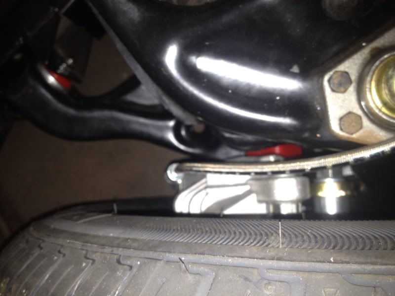

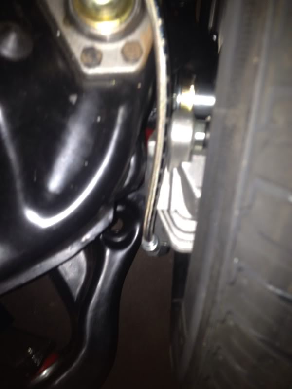

#95 _Holden89nut_
_Holden89nut_
Posted 18 June 2013 - 10:13 PM
Just before full
Lock
98145354-5184-4D59-8948-1C633CD77052-564
Hard on the steering wheel locked but steering stops still 10 mm away from k
Frame, caliper is touching the actual main cradle
514D1DE2-232A-43F9-B5C4-20B0DD3FD351-564
#96 ls2lxhatch
Posted 19 June 2013 - 12:26 AM
How much camber do you have?
The more camber you have the closer the caliper will be.
Are you checking the clearance at ride height, full rebound or full compression?
#97 dattoman
Posted 19 June 2013 - 02:27 AM
Would using the UC upper arms change this any do you think Andy ?
Looks like its on the ground.. but is it loaded ?
#98 _Holden89nut_
_Holden89nut_
Posted 19 June 2013 - 05:38 AM
Car has no motor, slr height springs so it's full rebound, no sure how much camber didn't think it was adjustable
#99 76lxhatch
Posted 19 June 2013 - 07:49 AM
Clearance does get better at ride height (you wouldn't get full lock and significant suspension movement at the same time). I have UC uppers with just over 5 degrees caster (was more like 1.5-2 at installation though) and 1 degree negative camber, I also have UC lowers with the steering stop on the arm, I wonder if that reduces the amount of lock just a little?
I still think I remember the banjo fitting being one of the closest points to the cross member so something's different here, not sure if its just the height. It would be OK to trim the cross member a little there but a pain in the neck.
Can't find any photos of the right angle, will see if I can get some from under the car as it sits to compare.
