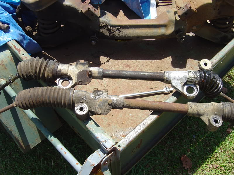

If you're going custom, it may be an idea to consider a solidly mounted rack. Holden ditched the rubber bushes when they designed Phase II RTS for the UC Torana.
You can see the difference here; LH rack on top UC on bottom..Totally different mountings & bolts.
