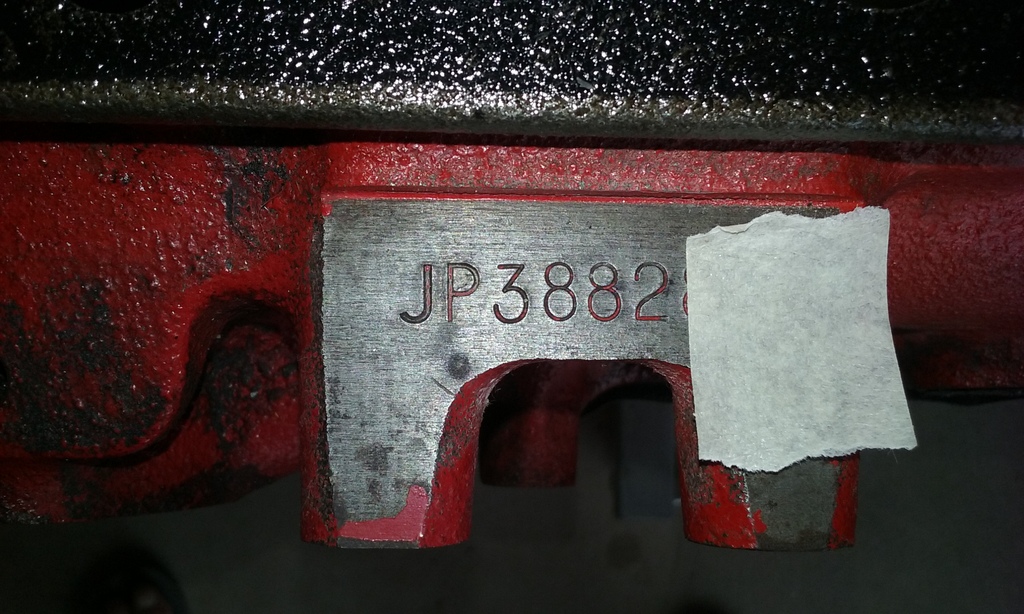

don't know much about them really,have been told it is real,no harm with a picture,dodgy or fake,stamping looks a bit all over the shop?
Attached File  DJP.JPG   290.17K   47 downloads
#53 _Skapinad_
Posted 19 February 2016 - 06:24 PM
Looks like the paint is thick over those numbers, remove it with a non abrasive method and post another pic please... ;)
#54 EunUCh
EunUCh
  • 2,774 posts
  • Location:not this planet
  • Car:japos
  • Joined: 23-November 06
Posted 19 February 2016 - 06:39 PM
^ you mean i gotta climb up on the mezzanine floor with an angle grinder to remove the paint from that pad?,it could be a fire hazard with all the other stuff around,it might be a disaster,not to mention the dust mites i might breath in getting to the thing :)
#55 _Skapinad_
Posted 19 February 2016 - 06:40 PM
Cast date would help to ?
Grinder is not non abrasive !! Lol. Put a bit of paint stripper on it ;)

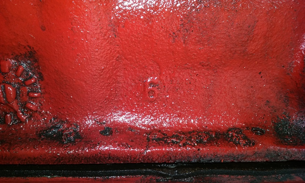

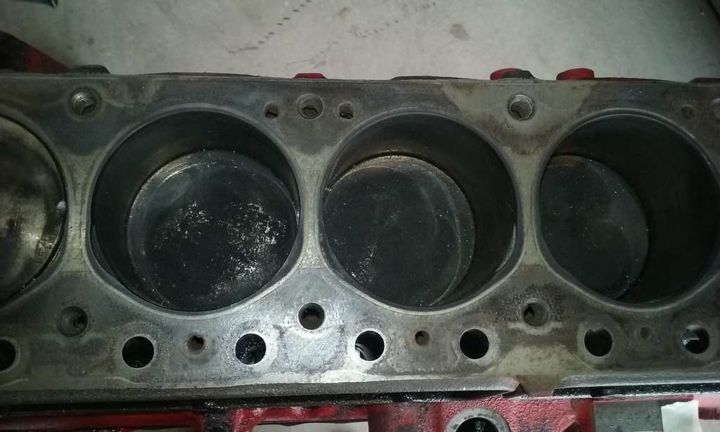

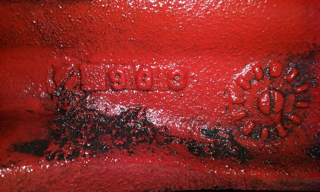

Here you go Skapinad,sorry about not removing the paint from pad,maybe the other numbers can confirm something without removing that nice color?
who knows what it is?
Attached File  djp1.JPG   65.42K   23 downloads
Attached File  djp2.JPG   52.2K   12 downloads
Attached File  djp3.JPG   57.96K   8 downloads
Attached File  djp5.JPG   30.02K   20 downloads
Attached File  djpc.JPG   47.88K   11 downloads
not getting up there again,too much crap and dust in the way to do much at all !
Edited by EunUCh, 23 February 2016 - 04:49 PM.
#61 _Skapinad_
Posted 24 February 2016 - 07:24 AM
The engine number seems to align with the cast date.... has the car got all its tags ?

Thanks to the owner for allowing me to put up his dual cast 9/2e block............. second owner.
Time for a photo of a single cast one in the date range 20F3 to 10H3
here is one for you Anthony... (thought i would keep them all together, there is another thread with this one in).  http://www.gmh-toran...-mould-numbers/
Edited by Skapinad, 24 February 2016 - 07:41 AM.

Adam Would like see it in the flesh,looks to have something under the jp when you inlarge the photo.
Cheers ps keep the photos coming
Edited by crabba67, 25 February 2016 - 01:22 PM.
#64 S pack
Posted 25 February 2016 - 02:23 PM
Nothing wrong with this pad and number.

You don't need X-ray vision to see the QL under the JP and I believe when Keith purchased this engine it still even had its original head on top, a low compression 2811930 9G3.........
Anthony warned him to stay well away I believe
Please.........
#67 _ChaosWeaver_
_ChaosWeaver_
Posted 26 February 2016 - 07:09 AM
No, you need a damn good imagination ....   FroCked if I can see anything under the JP (but for the record, I don't have X-ray vision)
#68 S pack
Posted 26 February 2016 - 08:14 AM
Please.........
QL under the JP? Really? Must have changed the prefix without changing the number? lol.
Adam, put me down for $100 towards the X-ray of Keith's block. The truth is out there.
Edited by S pack, 26 February 2016 - 08:16 AM.

Does the car JP388285 came from still exist?
#70 yel327
  • 13,975 posts
Posted 26 February 2016 - 09:25 AM
It was originally in H290093

As far as these whitewashers are concerned all JP engine blocks from late July onwards must have a second casting date on the passenger side of block and if they do not then they are have been restamped - hence the dribble.
Keep your chin up man.
#73 yel327
