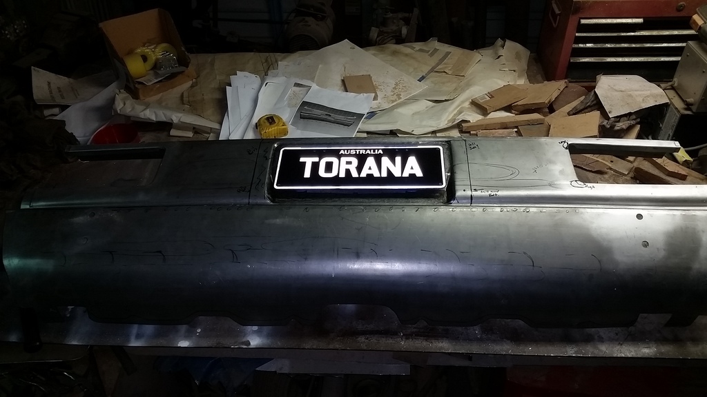

Hi guys and girls
Its been a while and I have been a little busy!

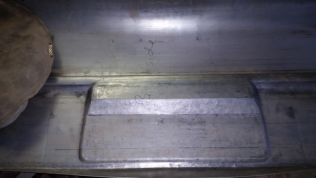

I decided some time ago, a few years ago I wanted to get into the panel fabrication line of work, at least as a hobby. At the moment it is a hobby I enjoy doing very much so here it goes!

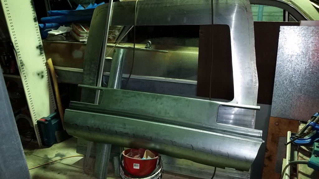

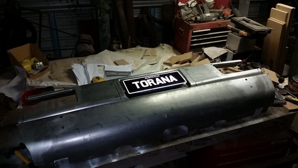

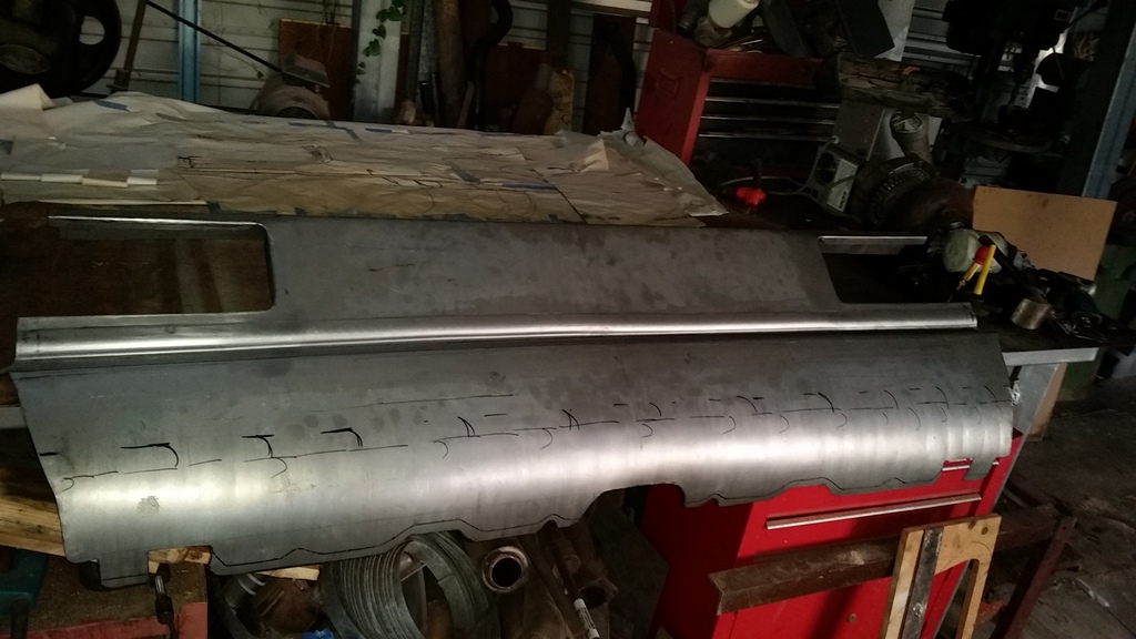

This is the rear panel I am copying off an LX Hatchback at the moment, its made from zincanneal and is just over 1mm thick. A little harder grade than the original Torana steel grade which is an improvement I think but not a major improvement really.
This panel I'm making still needs tweaking and checking but its almost there. Number plate recess hasent been stamped in yet. Looks kind of cleaner without the number plate recess.

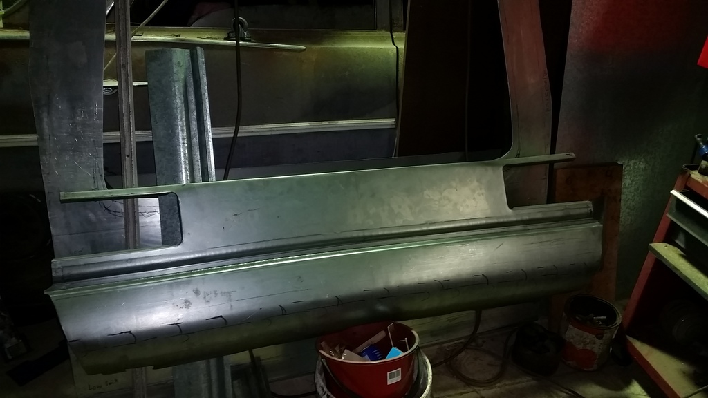

I'm happy to say this is only the beginning, I have been slowly working towards this, heaps of up hill battle last year, and like most things I realised I need more tooling (which I make myself), can never have enough tooling, tooling, tooling, tooling, especially when working alone and going after a "quality finish". The rear beaver panel in the pics isn't finished so it will be smoother once finished, tweaked and checked for fit/contour. (Remembering there are variations from one Torana to another) so it will be checked against my test mule Hatch! There have been preliminary checks but checking at the end ensures its correct.
Next is the roof, but ill be spending quite a bit of time on tooling before I start the roof, I noticed some guys are getting rid of the "1980's" sun roofs so this is my next target.
Then who knows, Ill start on quarters but I'm trying to make tooling to do a production run of these things not just one offs!
So I may end up with enough panels to make my own LX Hatch lol, it is my dream after all. The black Hatch from Street Machine years ago which had massive rear tires and flared motivates me. Wish I had that magazine.

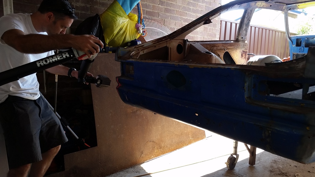

Just in order to get the beaver spot on I invested in getting the rear 3D scanned. This will be used as a guide to make sure the new beaver panels are correct to factory spec. Or close as possible.

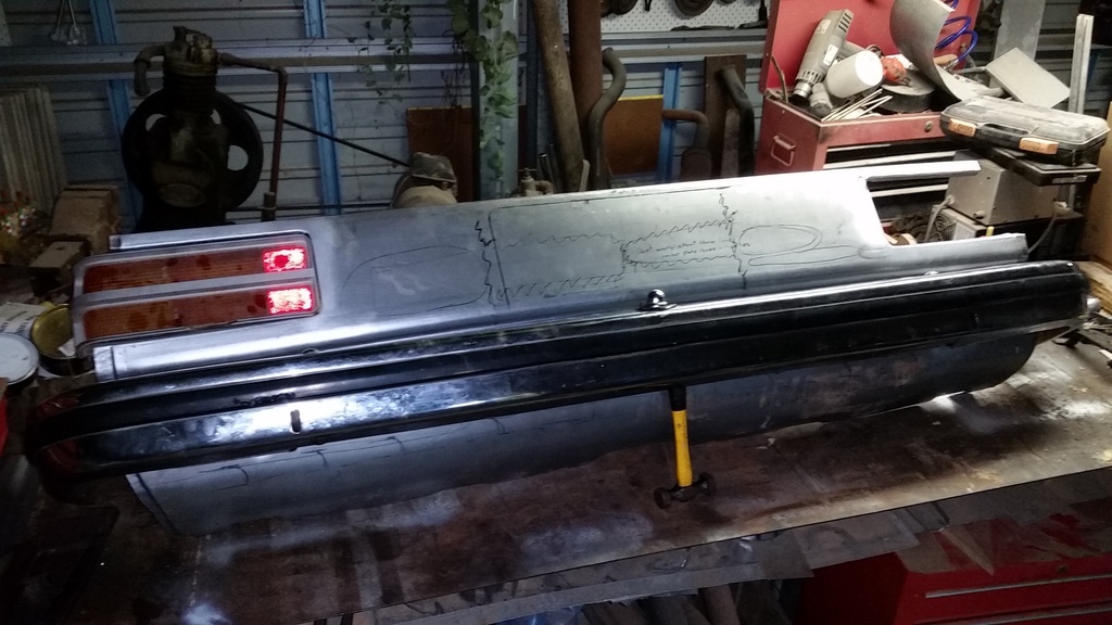

Test fit bumper. Thanks to Tom for loaning me the bumper

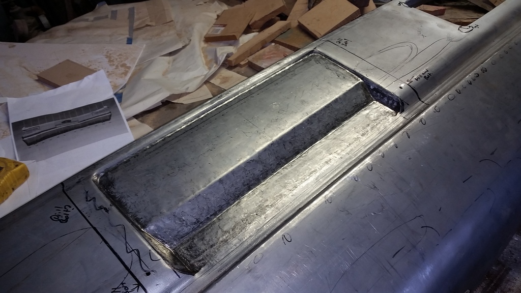

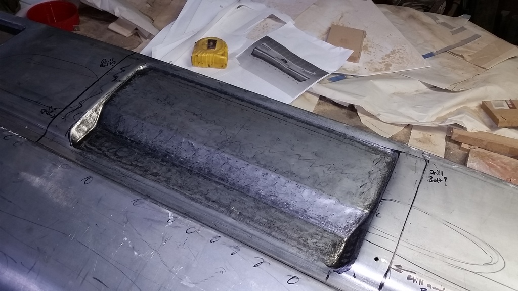

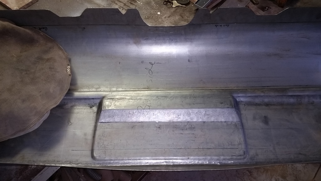

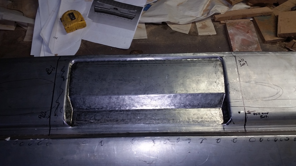

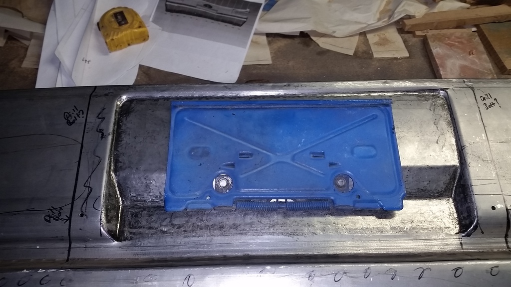

So Ive been doing more "testing" of tooling.
Basically made up some prototype tooling to test how it would work on a prototype beaver panel, seems to work ok. Now time to do some proper machining of the form to get the part to a higher quality, "press form quality"
Back of panel
Edited by Bart, 03 April 2016 - 06:23 PM.

Thanks mate. Its full on at the moment as the next panel is for a customer and this is the prototype and had to prove the number plate form worked. So far so good.
