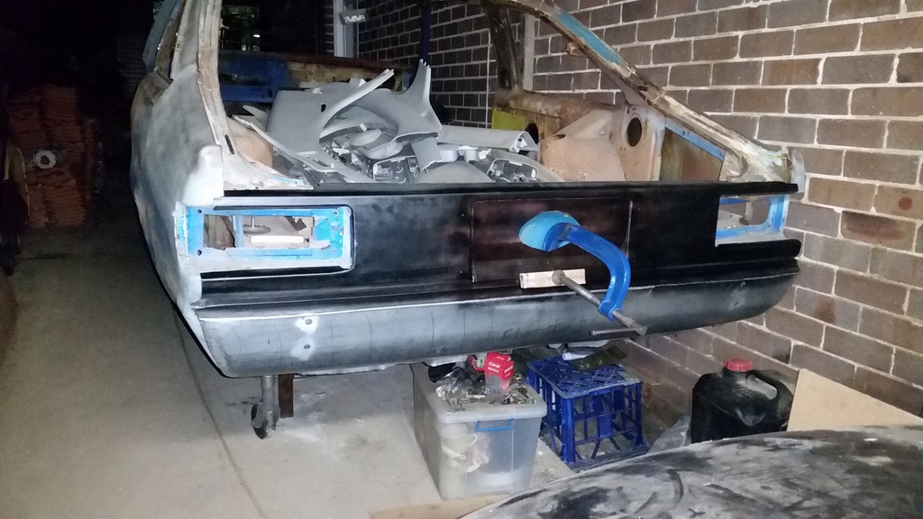

Cant remember If I have mentioned it but the roof will be next. I had a real hard time finding the correct material grade and size. Took me a year of looking under every rock then finally 2 weeks ago tried a steel merchant and surprise they had the right stuff. But had to buy a minimum of 10 sheets so I thought bugger it ill buy 10 sheets. These sheets I put aside for roof and eventually quarters and "hope" the entire side of the car but that would require expensive tooling.
But just to give you an idea the tooling alone for the number plate recess took a lot of dicking around, trial and error, but this dicking around can be short circuited by out sourcing to a machine shop but that costs money which im willing to spend.

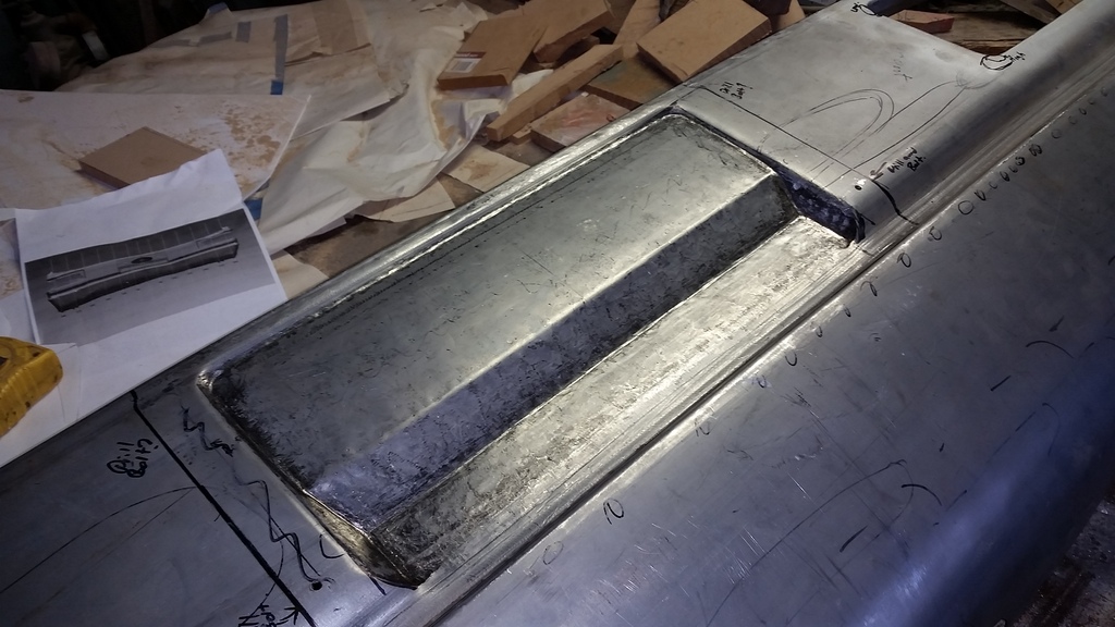

Using prototype tooling for number plate recess.
Looking into the Inside

Just to clarify the tooling needed for number plate recess has to be machined out. The issue is getting a company to do it. Seems being a "Little player" companies have priorities which is understandable, so I'm playing the waiting game at the moment.
Let me tell you they're in no hurry. But like I said they are always going to do the big jobs first.

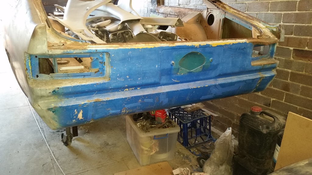

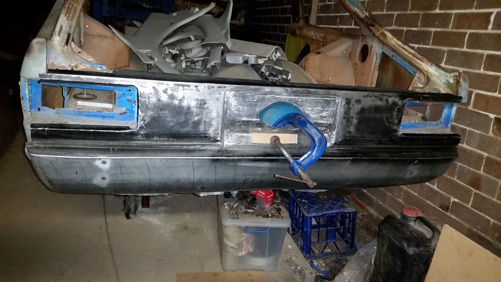

Black paint was needed for file finish.
Original
Copy
Copy

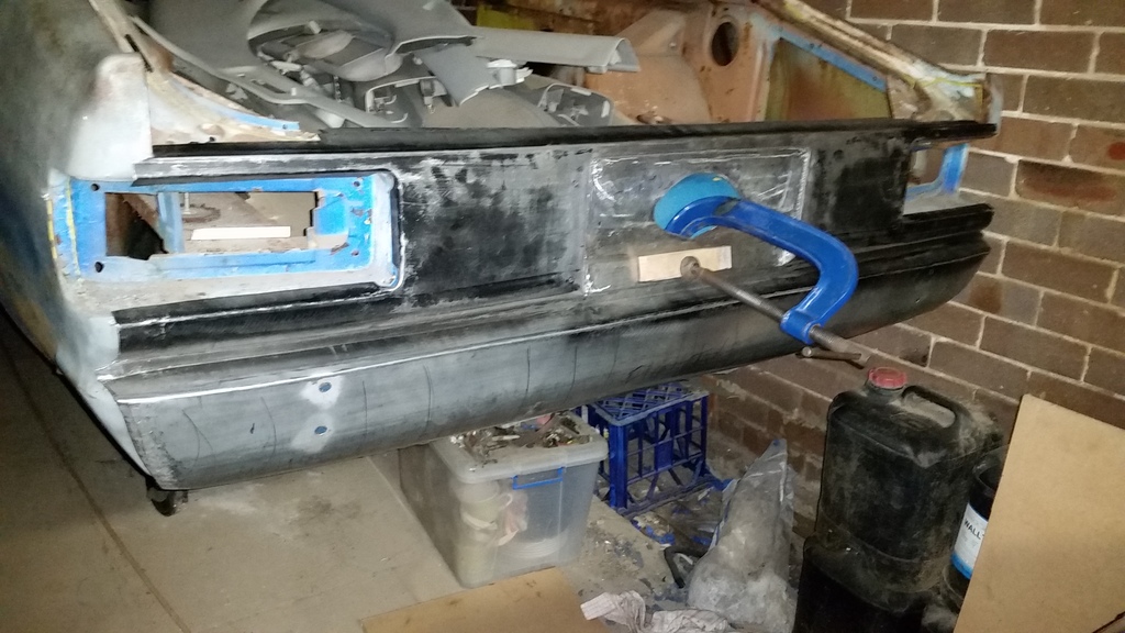

It so far checks out on my contour gauge but I may be removing my original beaver panel and test fitting my copy.
The beaver copy will be going to a customer soon.

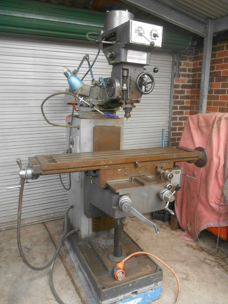

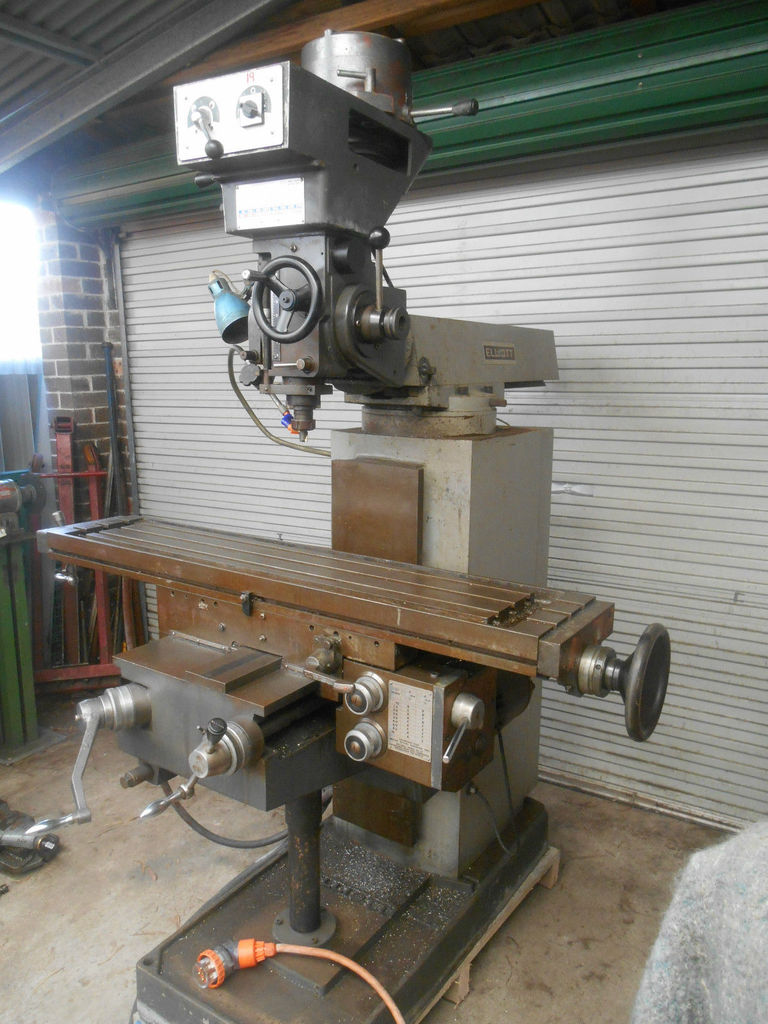

Moving along with tooling and ways of making them.
Shes an oldy but goody. Wish I can get a CNC but no way have the money for that but this will get me to where I want for now.
Its a 1967 from memory mill made in England, solid as a brick shit house and real good X Y travel.
Edited by Bart, 10 June 2016 - 09:13 PM.

I have an old Premo Lathe made in 1956, made in Sydney by Brackenbury and Austin. Well worn but still works ok, made up my 4140 chro molly suspension upper shaft mounts for the LJ 7 years ago now.
