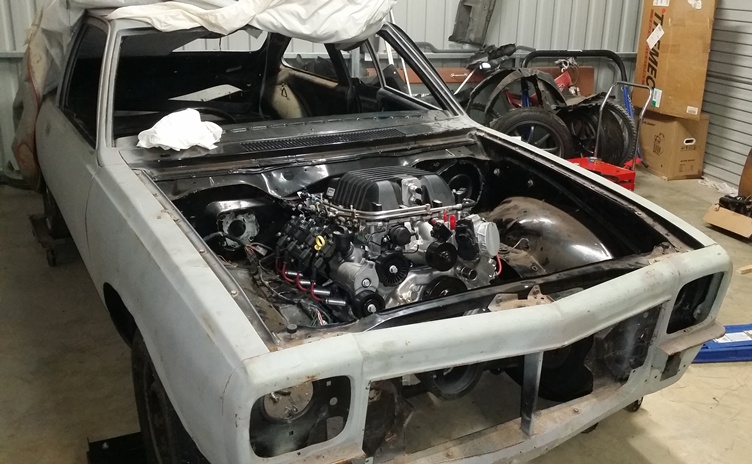

Got most of the drivers side headers done...e03f2822c78d99f9a6d2613881ca9afa.jpg
Just got to tack the header flange on the remove them to weld them on completely then they’re done... short of ceramic coating...

One thing with the headers, slip fit collectors are terrible for the O2 sensor, I had a lot of trouble with mine reading wrong because of the tinniest air leak, ended up making new pipes all welded this time.
Interesting man... never thought about that as being an issue... hmm... I'll have a think about it... worst case, I'll weld on a collector.

Just do it, google it and see how many people have had the same issue, not worth the risk.

make sure that you put a hold down point on the engine mount to block on torque side - simple chain will work well - stops the engine mount taking all the pain and tearing up or braking.
check the clearance on that header pipe for torque up and down, rubbing on the top arm.
on the track they are great cars to throw around , did the front end you have under there fix the bump steer issues at all - sorry if this was covered in the thread earlier.

Agent 34. I’ll check all the clearances on the k-frame and arms before final welding. It was close all over. Primaries are 1 7/8” and not the tightest mandrel bends going, so there was some compromise here and there, but with fixed engine mounts it should eliminate most of not all clearance issues.
I’ll be adding in some sort of strap or chain to the torque side as you suggested. On the list.
Bumpsteer... I’ve got some work to do in that area. The whole geometry is stock LX non RTS, so as is id say it would steer like a dingy. I’ve mostly jigged a stock UC frame to get started on the process of geometry and have got it in CAD. Also done something similar on the McD frame. I’ve got a few things in mind based on some geometry of the Detroit Speed frame I’ve got in my Camaro... all just takes time.
