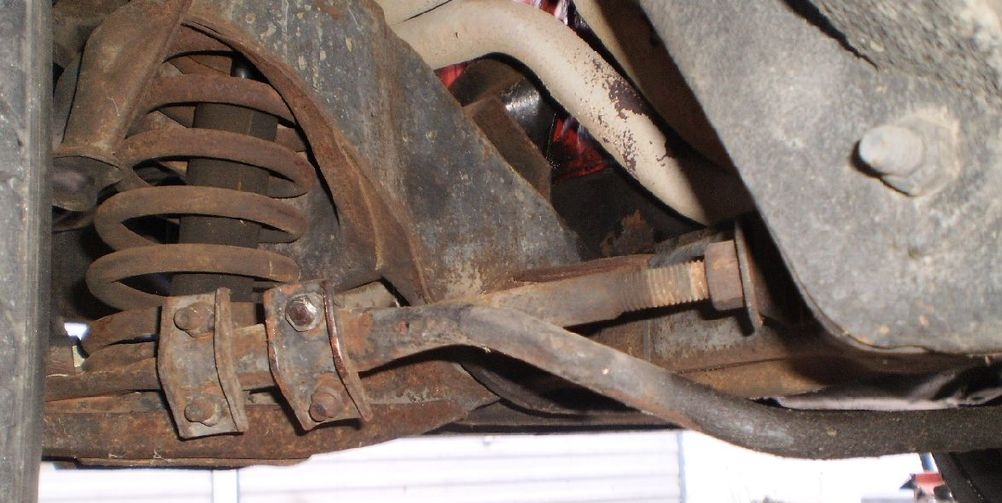

For what it;s worth Geno...heres a 12/70 Adelaide

HI Col
The revised type. BTW they are mounted incorrectly.
Your mission, if you accept it, is to establish "In what manner are they incorrectly fitted?"

Geez you blokes are hard markers......I went down the shed,layed on my back ,took a pic,  blah blah.....and are you happy?..Nuh.
LOL
p.s I remeber back in the day, they used to creak and groan a bit under hard conditions...maybe the orig owner thought he was on a winner ?

12/73 Brisbane.
At best three quarters right (one nut missing!)
At least these ones are a fair distance apart, which I thought was the way they should be

Hi Dave I didn't think they were right, that's just the way they were on the car when I bought it! I reckon the clamps need to be swung around so the nuts point straight down in the photo.

Well, despite Kev missing one of his nuts - he is closest to the pin.

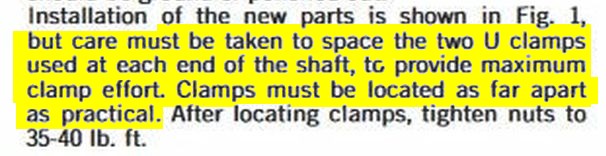

Note also the revised torque specifications - from the original 8 -10 lb.ft. (as per the LC Shop Manual) to 35-40 lb.ft.
Col - Thank you for your sacrifice, the Torana fraternity specifically, and the free world in general, owe you a debt of gratitude in furthering the body of knowledge surrounding GTR stabiliser U-bolts. :)
Dave - around Nov-Dec 1967, I signed the "Official Secrets Act', an undertaking that I do not take lightly :)
Bazza
Thanks Bazza, however I feel I should inform you the torque specs quoted in the above article were again revised during LJ production plus measurements were also published for the positioning of the stabilizer bar and clamps.

Col. you need to rotate your clamps through 180 degrees and move one clamp closer to the end of the sway bar.
And remove that piece of rubber.

Here Kev and Col - here is Fig 1 missing from my earlier post. It better explains the correct order of assembly.
Bazza

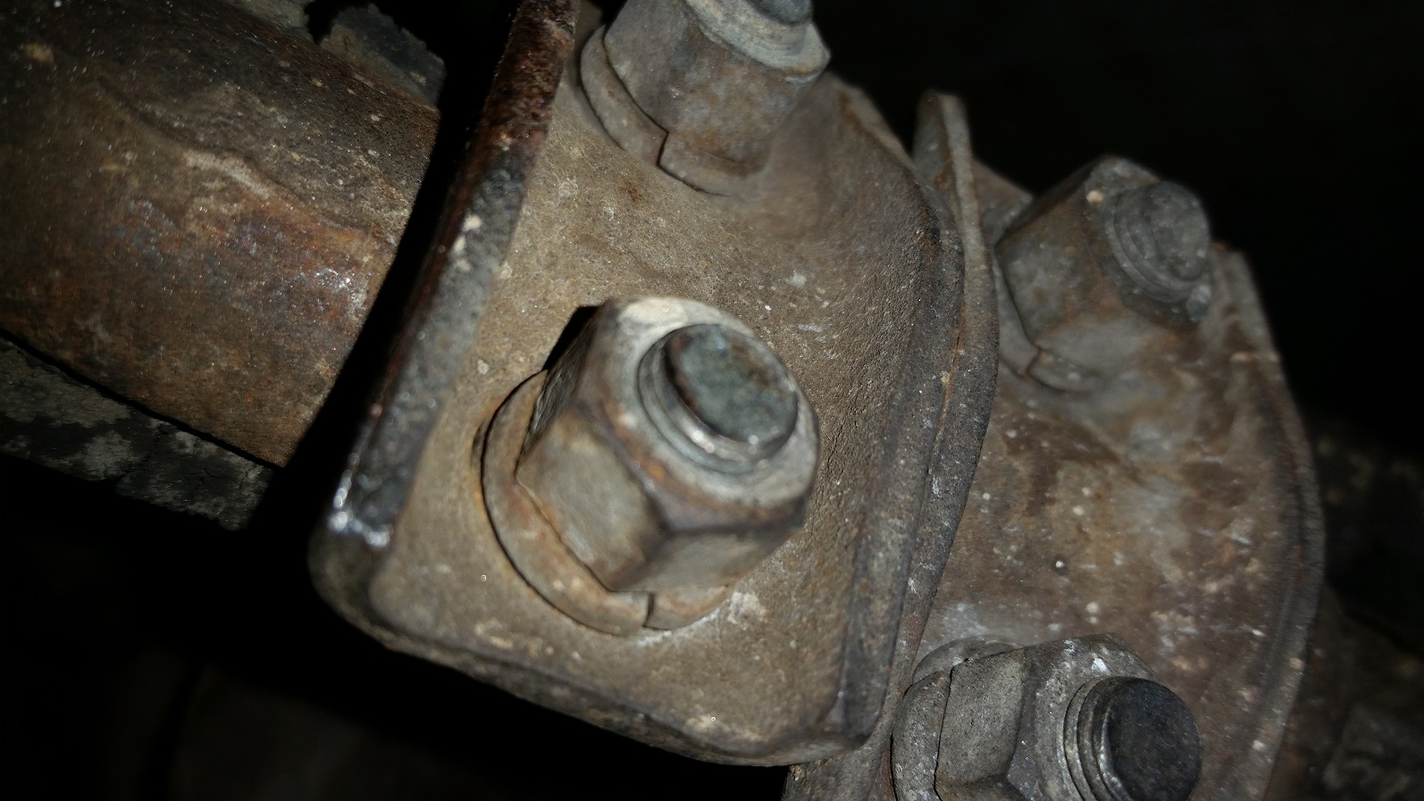

Another variation on the theme and once again incorrect.
Seems the correct assembly of these little suckers has confused many over the years.

STABILIZER SHAFT ATTACHMENT REVISED- TORANA GTR
The attachment of the front stabilizer shaft to the suspension control arms of Torana 'GTR' cars has been revised to obviate relative movement between stabilizer, control rod and clamps. The revision comprises a new U bolt of 3/8 in. diameter, with corresponding changes to the U bolt seat plate, and release of new nuts and washers.
There is no reference to the above revision being a recall or a warranty issue and no mention of clamp breakages either.
