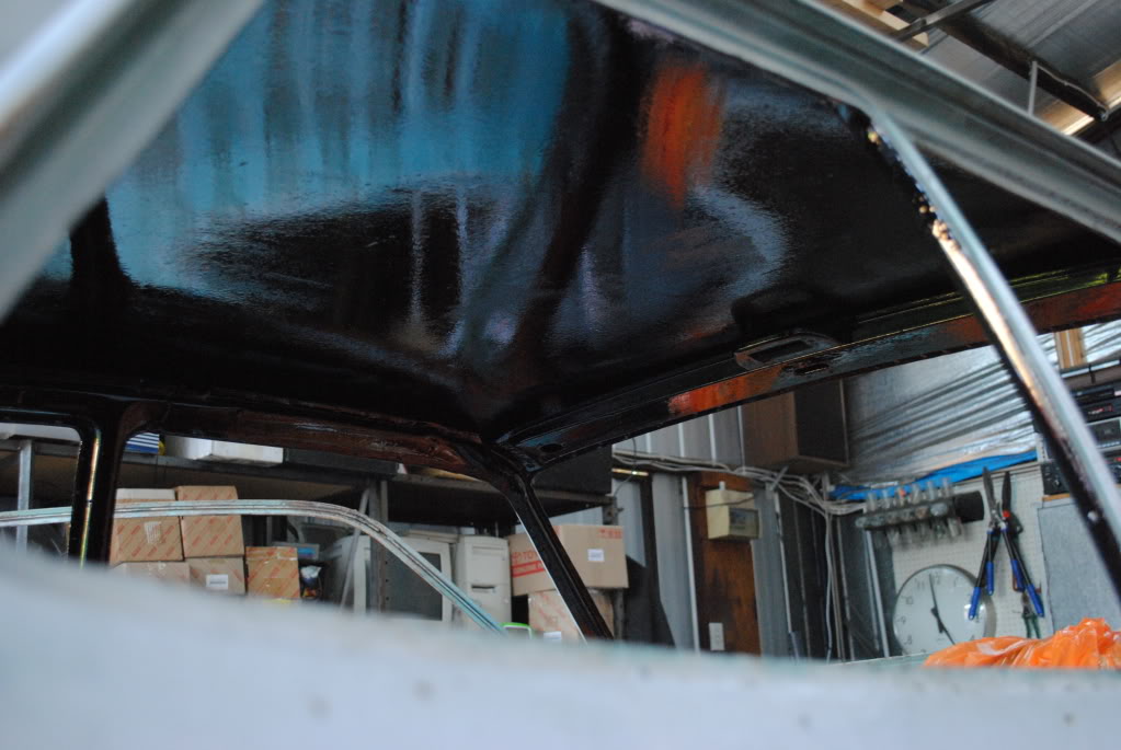

I'm probably a bit late to this one, But i have done my whole inside roof with KBS just brushing it on. Once the headlining goes back in no one will see it.
Its good stuff, just follow the instructions with the three stop process.

So picture yourself trying to clean that BBQ you lent to a mate.
I'd rather remove 50 wiper motors before doing this again.
Still have some way to go. The best method seems to be to scrape 10-20mm sections off at a time.
I've also come to the realisation that I should remove the roof brace.
Anyone done this? Looks like a tack weld and some spot welds.
Trying to weld this in without burning the exterior paint will be a challeng.
Attached File  IMG_8124.PNG   2.08MB   4 downloads

#41 _73LJWhiteSL_
_73LJWhiteSL_
Posted 10 December 2016 - 09:42 PM
Tony,
Yes Roof brace can be removed, its only 5 or 6 spot welds each side and a couple of tacks. I have already done that as you can see its missing in the picture above.
I have not re-installed mine yet, but was planning to do it ussing some big planks to clamp it to the roof.
There are pictures in my thread if you click the link in my sig. Its on the third page.
