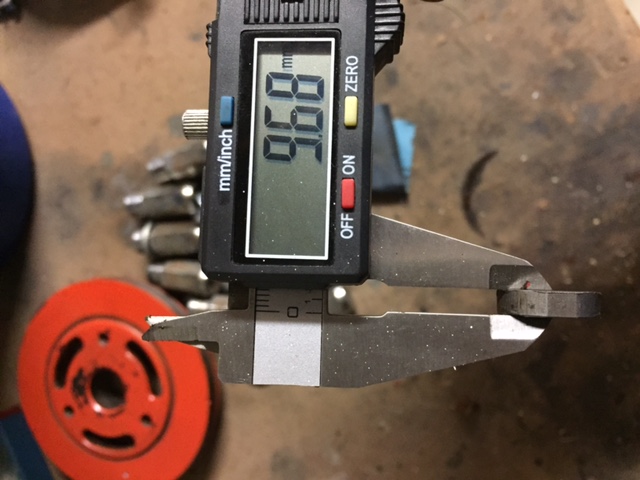

Pictures below. Crank is worn the most. Upper keyway shoulders are the worst at 10 10.6mm. The foot of the keyway is 9.77mm.
The balancer is a little less and I can easily slide it on by hand. They key ranges from 9.8 to 9.68 in the grooved areas.
#47 _Bomber Watson_

THat doesnt sound right, have you zeroed your calipers?
#48 S pack
Posted 22 April 2017 - 08:15 PM
Yeah something amiss there.
Can see in this pic the analogue markings show 5mm or almost 2/10".

#49 _Bomber Watson_
Posted 22 April 2017 - 08:36 PM
Back when I used digital calipers (got the shits and went back to analogue ones) I used to zero them, then grab a couple of drill bits to check the measurement with, there fairly precise so long as there not super worn around the shank.
Perhaps try this and have another go.
#50 S pack
Posted 22 April 2017 - 09:06 PM
Haha, just realised his caliper is showing 4mm not 5mm. Need to wear my glasses more the older I get . :banghead:
