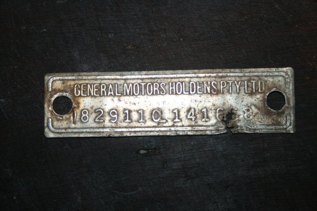

#435 _Flatliner_
_Flatliner_
Posted 14 July 2011 - 06:14 PM
Hi All,
Need some info for a friend about the Vin Tag below.
And also the body number LC 05193A.
The other two tags are missing any info would be helpful.
Cheers Rob
#436 Bazza
Bazza
    ǝɹnʇxıɟ ɯnɹoɟ
  • 4,295 posts
  • Car:ɐuɐɹoʇ
  • Joined: 11-November 05
Posted 14 July 2011 - 09:43 PM
Hi Rob
Process of elimination tells me that that VIN relates to PSN L141668 which is a GTR that was completed on 31/12/69. Being completed before 1/1/70 it probably didn't have an ADR tag so is only missing the Body ID tag. There is no engine number recorded but the car was sold by dealer 162 (Attwood Motors - Stirling St Perth WA) during Jan '70. The colour and trim details are on the missing Body ID tag. The VIN and Chassis Numbers are both consistent with that completion date.
Bazz
#437 _Flatliner_
_Flatliner_
Posted 15 July 2011 - 12:01 PM
Thanks Bazza,
I have a friend who found this car up in Broome in W.A.
It was in a back yard with a cover over it, the car needs a full resto but the info you have provided has been very helpful.
I will post some pictures when I get some.
Cheers Rob
