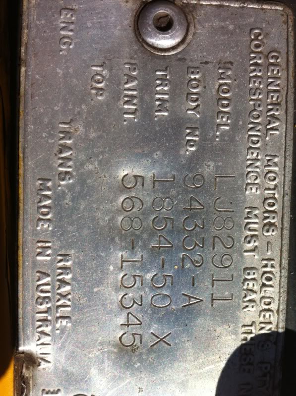

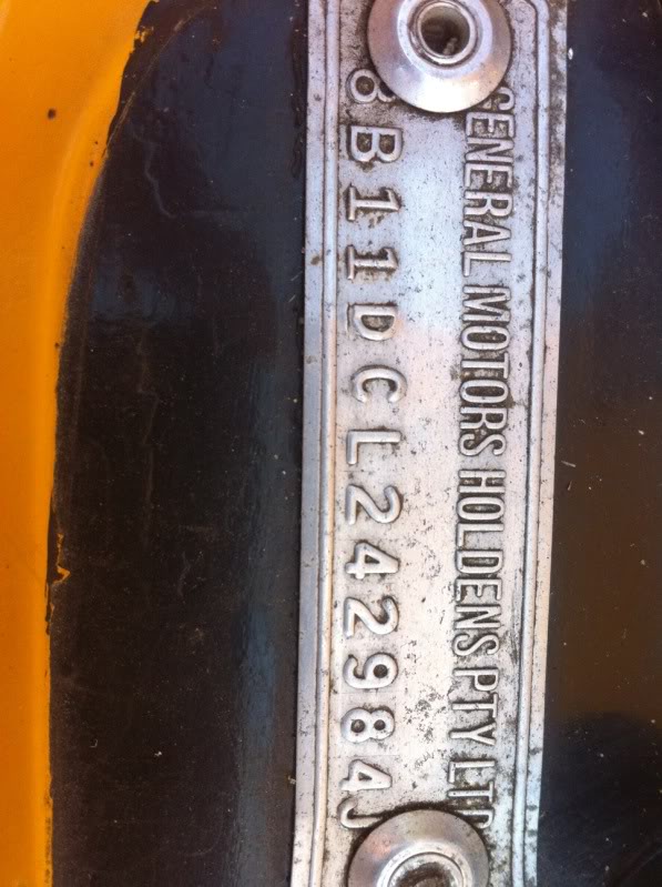

Hi all ,could someone please check these numbers for me please
LJGTRXU1 chassis BLJ32955,Model 82911,94332-A,Trim 1854-50X,Paint 568-15345,VIN 8B11DCL242984J,JP Block 435842.The car is painted yellow ,the compliance plate is missing.This car has been sitting for about 15 years and has rear end damage.Thanks in advance Paul.

JP 435842 ????? no such thing , vin number is not xu-1
lookalike at best with made up JP number

Hi Paul
The VIN tag relates to a 2 door S model completed in Adelaide on 1/6/73. The Chassis Number and Body Number accord with a car completed in Adelaide during late Nov 1973.
The engine number 435842 (which is not a JP) is a JL 202 that was fitted to a GTR (8D11LDL257896J) that was completed on 22/11/73 and sold during 12/73 by City Motors, Newcastle St, Perth WA.
From the Body ID tag info that you have provided the car is Mustard with black vinyl trim.
It would appear that the car may be a GTR that has had a missing VIN tag replaced with one from a different car to make things "look right" (this happens often).

Hmmm ok ,thanks meanmachine ,i will pass that on and the person concerned can do his own checks apart from that ,looked suss to me too .

Thanks Bazza, i appreciate all that ,i had a look at the block it must have been restamped or something and the tags definately look messed with as they have different rivets ,cheers mate .Paul

Still worth buying as a GTR, just pull the VIN tag off. Enquire about rego before purchase.

Hi Baz.
Can you do one for me please,
Number stamped into body looks like BLJ32955A
and the two tags are
Than ks

Hi A9X
PM sent
